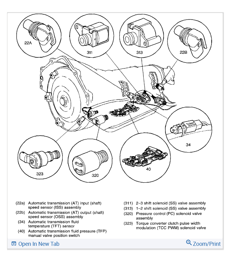

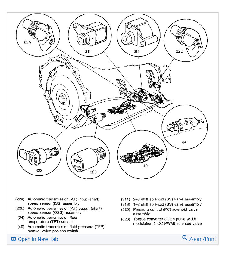

Had transmission rebuild won't go in overdrive?
Mar 26, 2023 at 6:01 AM
Experienced Mechanic
55,721 POSTS
I would first run the codes to see what comes up here is a guide to help. It sounds like you have an input shaft speed sensor that is not working or a fluid temperature sensor that has shorted out.
Here is the location of each so you can see what's going on. Check out the images (below). Please let us know what happens.
