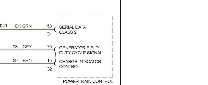

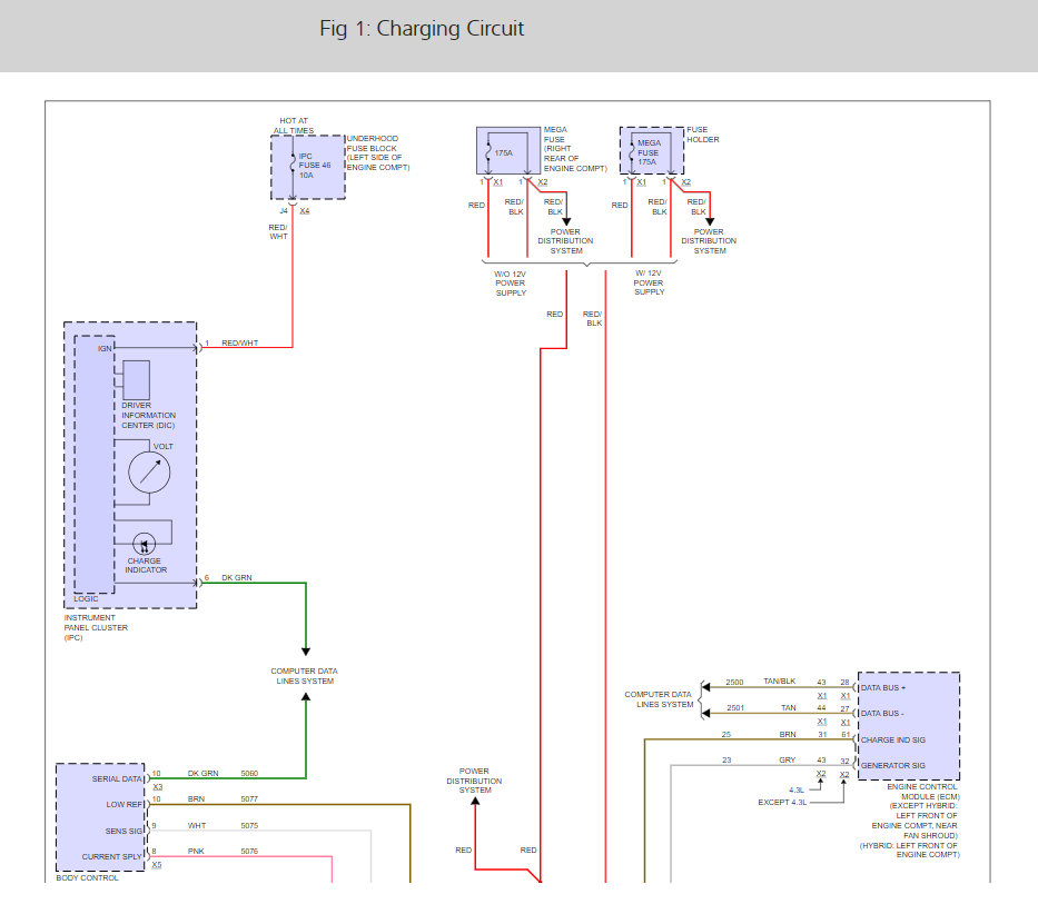

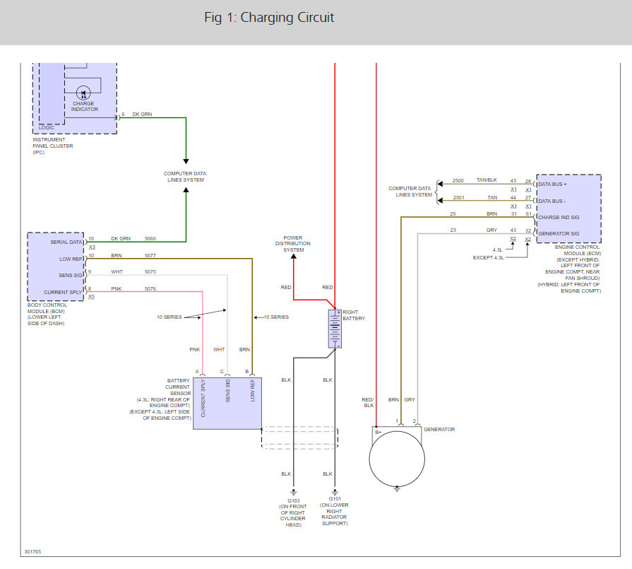

  • 55,721 POSTS
It sounds like the currant sensor is not working correctly or you have a bad connection here is a guide to help us test and the alternator wiring diagrams so you can see how the system works.
If everything tests okay make sure the alternator is a AC Delco replacement and the PCM controls the field. Test to make sure you have power at the system fuses as well.
Check out the diagrams (Below). Please let us know what you find. We are interested to see what it is.
