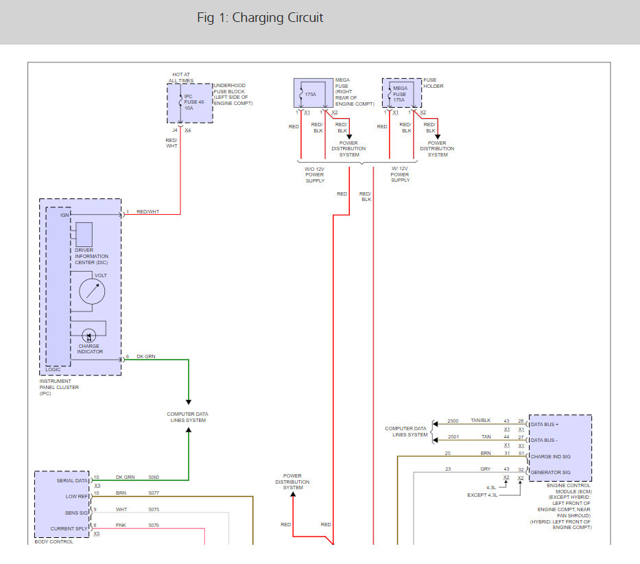

My truck is a 1500. the voltage will read 15+ volts once in a while it will drop to normal 14 volts but a couple times it would drop to 12 volts and stay there until i turn of the truck and restart it and it will read 15+. Now i had the old alternator tested and it passed three times. it was whining so i got a new one anyway installed it and it is actually reading higher 16+ volts. then after five minutes or so it drops to 15+ volts. What could be the problem? the battery is three years old and a brand i never heard of but it started perfectly in negative weather. I cleaned all grounds checked wires, could it still be the battery?

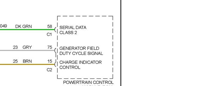

  • 75,992 POSTS
Could be the computer control of the alternator field generation messing with you-its like a built in IVR on the computer that controls the alternator output

  • 75,992 POSTS
Could be caused by the computer controlled of the alternator's field generation circuit-have it checked

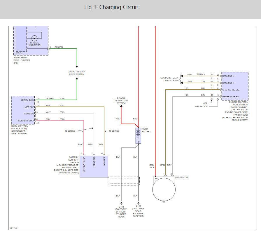

  • 54,832 POSTS
It sounds like the currant sensor is not working correctly or you have a bad connection here is a guide to help us test and the alternator wiring diagrams so you can see how the system works.
If everything tests okay make sure the alternator is a AC Delco replacement and the PCM controls the field. Test to make sure you have power at the system fuses as well.
Check out the diagrams (Below). Please let us know what you find. We are interested to see what it is.
