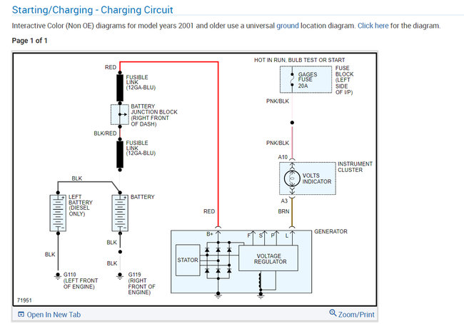

I've replaced the alternator, battery and ECM. It's still overcharging.
Dec 14, 2020 at 9:27 PM
Experienced Mechanic
52,796 POSTS
Good morning,
What is the charge rate?
There is no ECM involvement in this year. It is way too early.
It is all controlled by the alternator itself.
https://www.2carpros.com/articles/how-to-replace-an-alternator
Image (Click to enlarge)
