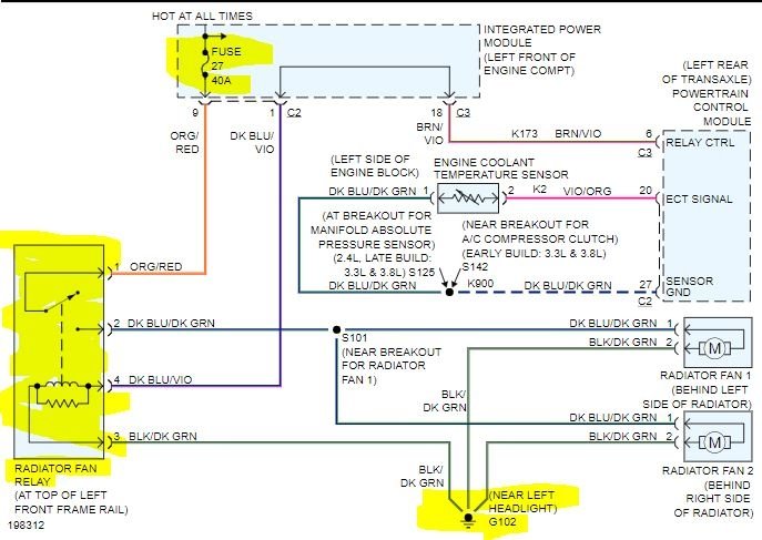

overheats when idling and drive idling. Temperature gauge always stays and half way to hot, but if stuck in traffic van overheats, and if just idling it overheats. I tried to idle it to see if the fans turn on , but it overheats too quick.

Once the temperature gets to a certain point, regardless of how fast it gets there, the fans should turn on. Have you checked fuses and relays? Have you checked to see of the fans have a ground? Since this only happens when the vehicle is in stop and go traffic, there is a really good chance it is related to the cooling fans in some way.
I attached a picture of the fan's wiring schematic. I highlighted the things I need checked first. Here are a few links you may find helpful:

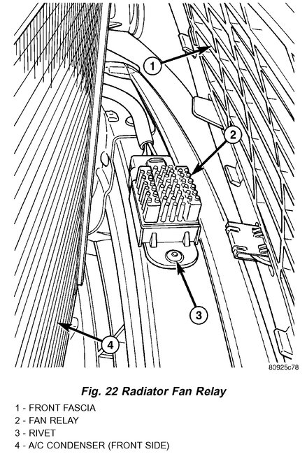

I attached picture 2 also, because it shows the relay in question. Please understand, a bad cooling fan motor can be the cause also. To check that, you would need to run power direct to the fan motor.
