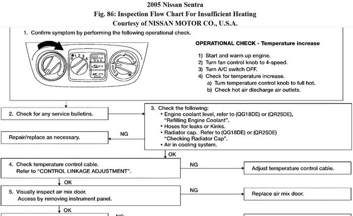

The cars heater stopped working and temp gauge running normal temps while driving but when I come to a stop the temp rises then goes back normal when you start moving again. I have changed out the thermostat and the problem still continues. I need help to figure out what's going on I can't think of anything wrong except maybe the water pump is going bad or the thermostat I just put in is bad as well.

it may be the wire grounding out leading to the sender or maybe air in system since there is no hot air out of the heater.

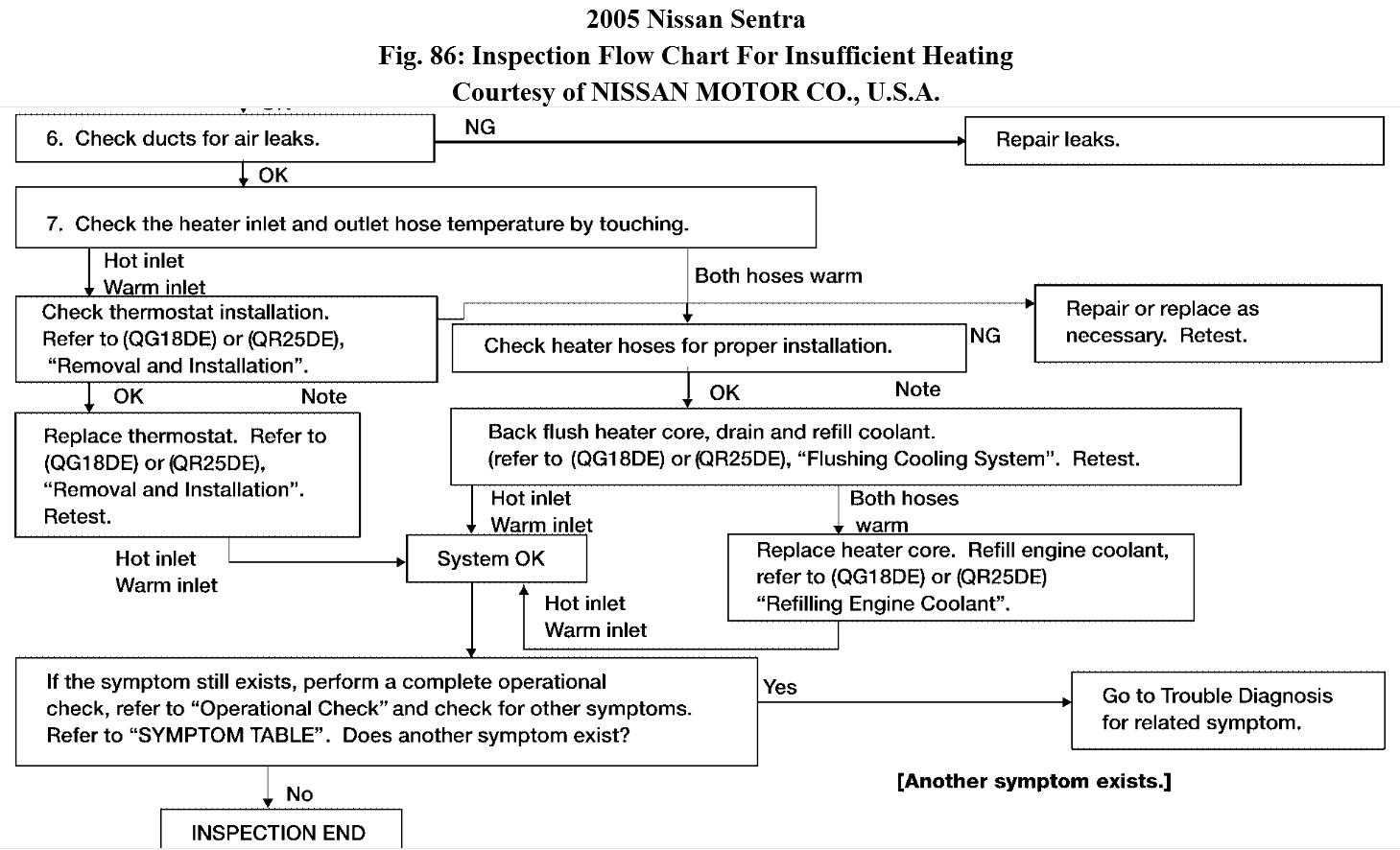

Read the guide below on heater not working, it may help narrow things down

Refer to chart for basic diagnostic procedures.

When was the last time you had your cooling system flushed? It is quite possible that your lines to the heater core are full of contaminants and not allowing fresh coolant from the engine from getting into the heater core.
I would suggest that you look into flushing the system, and fill it up with good quality coolant to the right level.

If it's running fine, I would try flushing the heater core. Look under the hood, find the hose from the water pump that goes to the heater core near the firewall. Also find the return line for the heater core. With them both unhooked, attach a garden hose to one end (clamps, duct tape, whatever holds it) and turn it on. You should only be flushing the heater core and not the block. You may get wet, and with some coolant. If you can't get a good flow, the core may be severely blocked. Possibly try flushing the other way. If still no succcess, try pouring in some CLR and waiting for the substance to take effect. If still no avail, buy a heater core. But only do any of this if your car is running just fine but you have no heat. Thanks!
