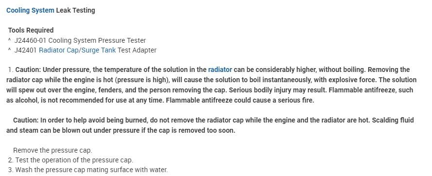

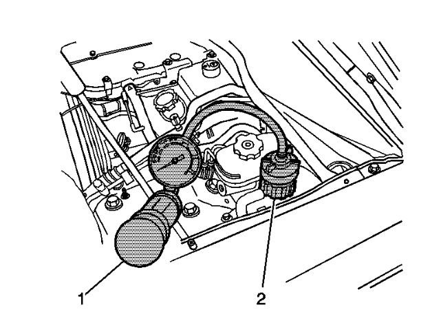

Did you pressure test the system to find out where the coolant is leaking?
https://www.2carpros.com/articles/radiator-pressure-test

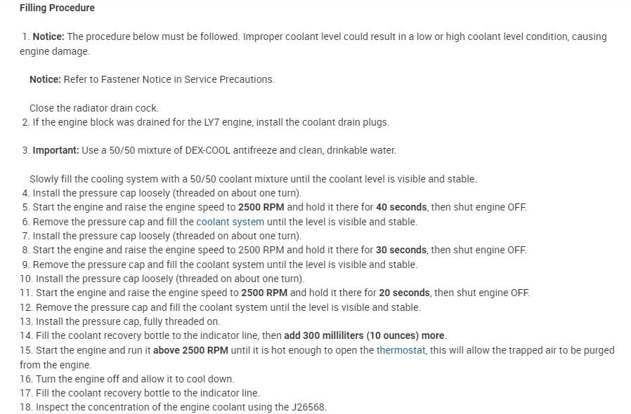

It sounds like you have air in the system. From the low coolant, the air has settled in the heater core which is at the top of the system.
Try running the motor with the cap off at 1200 RPM and keep watching the coolant level until you get good heat. Then make sure the level is correct and install the cap.

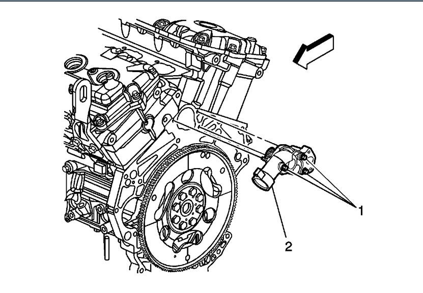

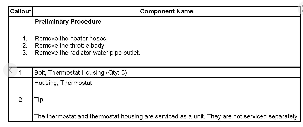

I would also recommend replacing the thermostat.
