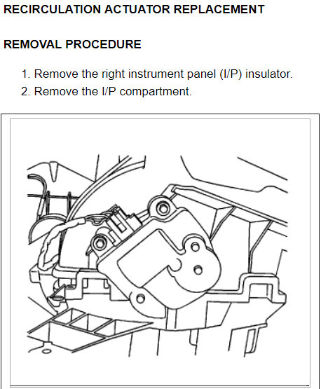

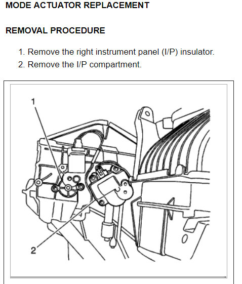

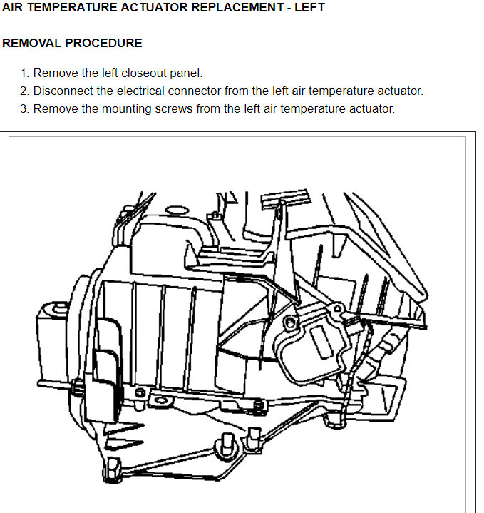

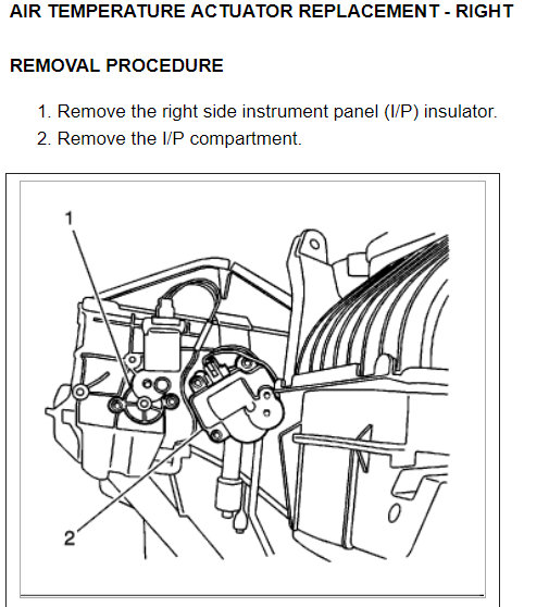

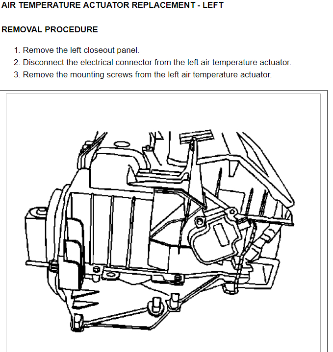

This sounds like you have a temperature blend door actuator that is not working. Here are two guides that will give you an idea on how to change it.
Here is the location for your car (below) You are going to want to replace the mode actuator I have found the dual climate actuator as well which is the right on signal controls.

It was the temperature blend door actuator on my car cost me $78.00 for the part.
