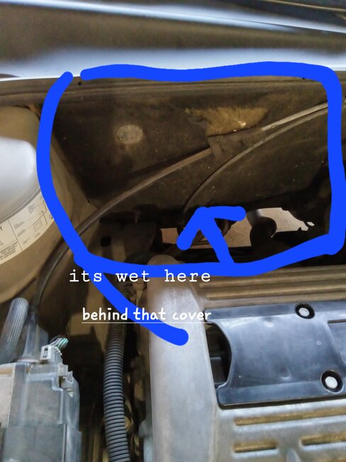

I was previously on but have to make a new thread on a new problem, so my car is overheating when I drive, someone told me it was the water pump I'm trying to narrow it down. I sent a picture I don't see any water leaking around pump. I can hear some light whining noise, but it didn't do it all the time. I was just wondering why there was water seeping through that panel ?

Is there evidence of coolant on the passenger's side floor or anything inside the vehicle? The heater core can be leaking, or you could simply have a hose to the heater core leaking.
What I would recommend is to pressure test the vehicle. This is done when the engine and coolant are cool, so it is a lot safer.
Here is a link that shows how it's done:
https://www.2carpros.com/articles/radiator-pressure-test
Is the engine overheating because it becomes low on coolant? Also, does it overheat at highway speeds, or does it seem limited to stop and go traffic? If it is stop and go traffic, pay attention to see if the radiator cooling fans are running when it starts to overheat.
Let me know what you find.

When the engine is cold, open the radiator to see if it is low on coolant. Also, where you are pointing on the image it is hard to say because there is nothing there that would leak coolant, I can say though the water pump could be bad which can throw coolant so that is possible.
https://youtu.be/GSE9skKnOgY?si=BzeRWgSn4ffIrvut
The cooling fan will run longer if the engine is too hot. Do not open the radiator cap when the engine is hot or warm.

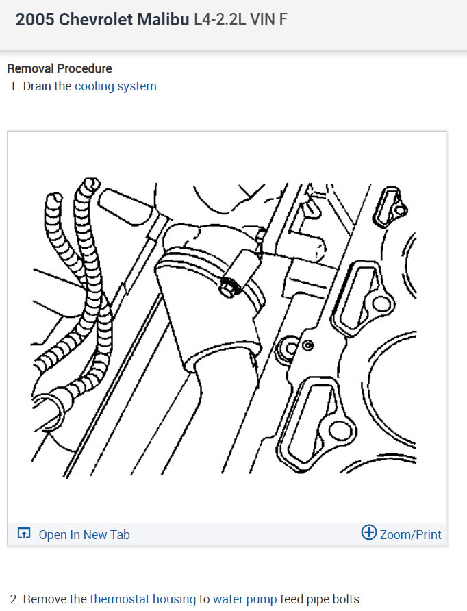

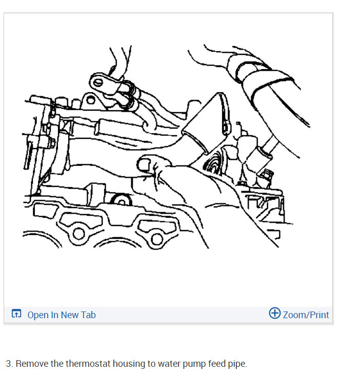

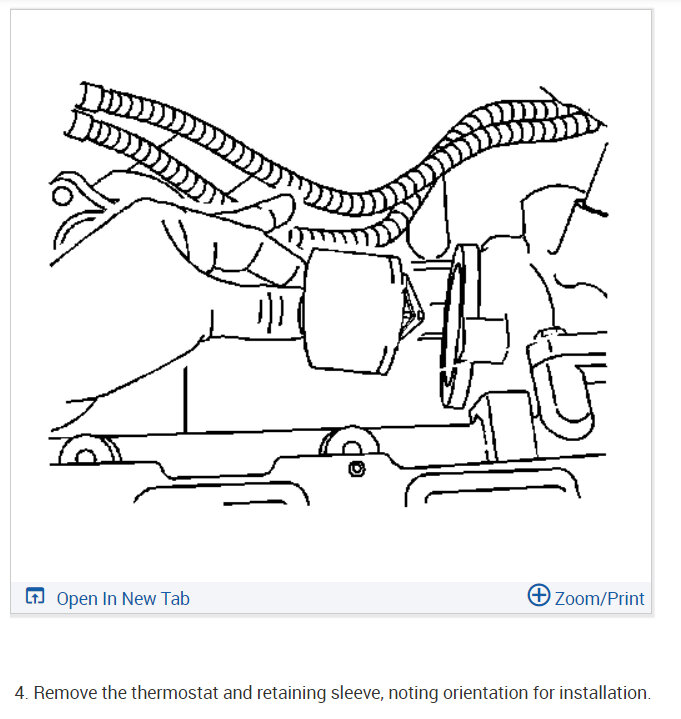

The water pump is inside the engine so it would leak externally, I think you may have a blown head gasket or a bad thermostat. You can drain a little coolant out of the radiator and use this guide to help confirm the issue. You can rent the kit from the auto parts store for cheap or free.
If it tests okay here is how to change the thermostat out. Here is a generic guide to help you step by step with instructions in the diagrams below to show you how on your car:
