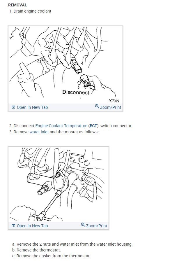

My car listed above the temperature gauge the needle rises to the top but the radiator is full on antifreeze the over flow tank isn't low either. could it be the thermostat?
Apr 2, 2021 at 6:51 AM
Good evening,

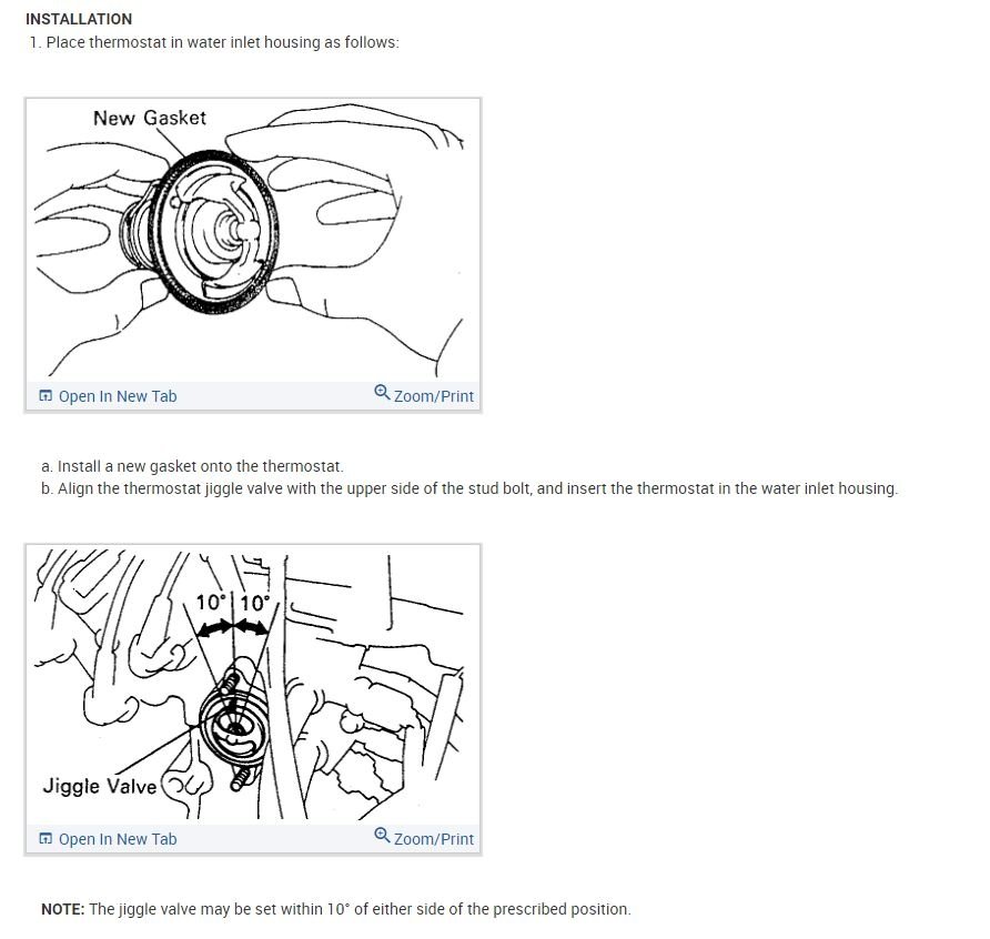

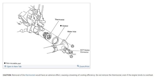

Yes, it could be the thermostat.
https://www.2carpros.com/articles/engine-overheating-or-running-hot
https://www.2carpros.com/articles/radiator-pressure-test
I attached the procedure for you below.
