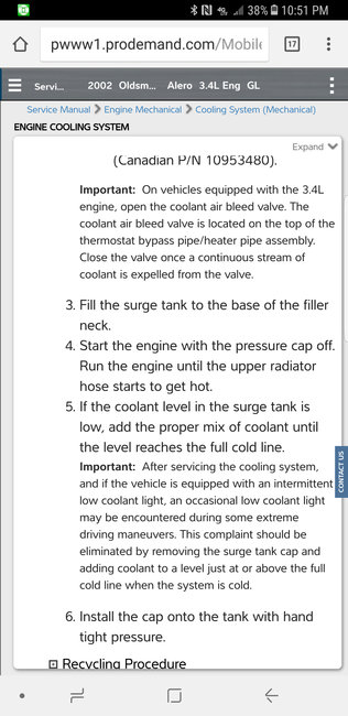

things i have done: changed thermostat, flushed heater core, flushed radiator, bled system each time. within a mile it will run hot and boil out the reservoir.

So is your radiator fan coming on when it is running hot? If the fan is running is it blowing out cold air?

Radiator fans come on.Yes. when everything is hot and i open the bleeder value only steam comes out.

So when the radiator fan come on is it blowing out cold air?From what your saying it sounds like there is air in the cooling systeM.I wouldn't be opening the bleeder screw when it's hot.

Please follow the filling procedure I posted the bleeder screw stays open while filling.When a steady stream of coolant comes out of the bleeder screw close it.Then finish filling the cooling system.

okay, did that and it still runs hot and push coolant out of the reservoir.

fixed my over heating problem, replaced reservoir and cap.
