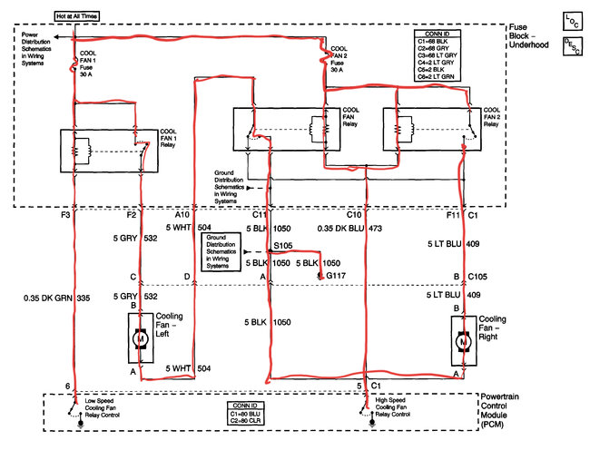

New rebuild engine, cluster, cooling temperature sensor, new fan assembly, used ECM, fuse box, A/C compressor, low pressure switch new. I bled the systems. new radiator, water pump. I'm lost. my question is, can a transmission pressure sensor cause it? It shifts hard sometimes. need help. my wife's car and special. I don't need them broke down on the side of the road.

Hello and welcome to 2CarPros. It looks like you have done a bit of work for your concern but I do not see that you replaced the coolant cap or the thermostat? Here is the information on how the cooling system works. No, I do not see the transmission sensor having an issue with it overheating, but a shift issue yes. Here is the information on the cooling system:

Cooling System Description
Vehicle Engine, Cooling and Exhaust Cooling System Description and Operation Components Cooling System Description
COOLING SYSTEM DESCRIPTION
Cooling Fan Control

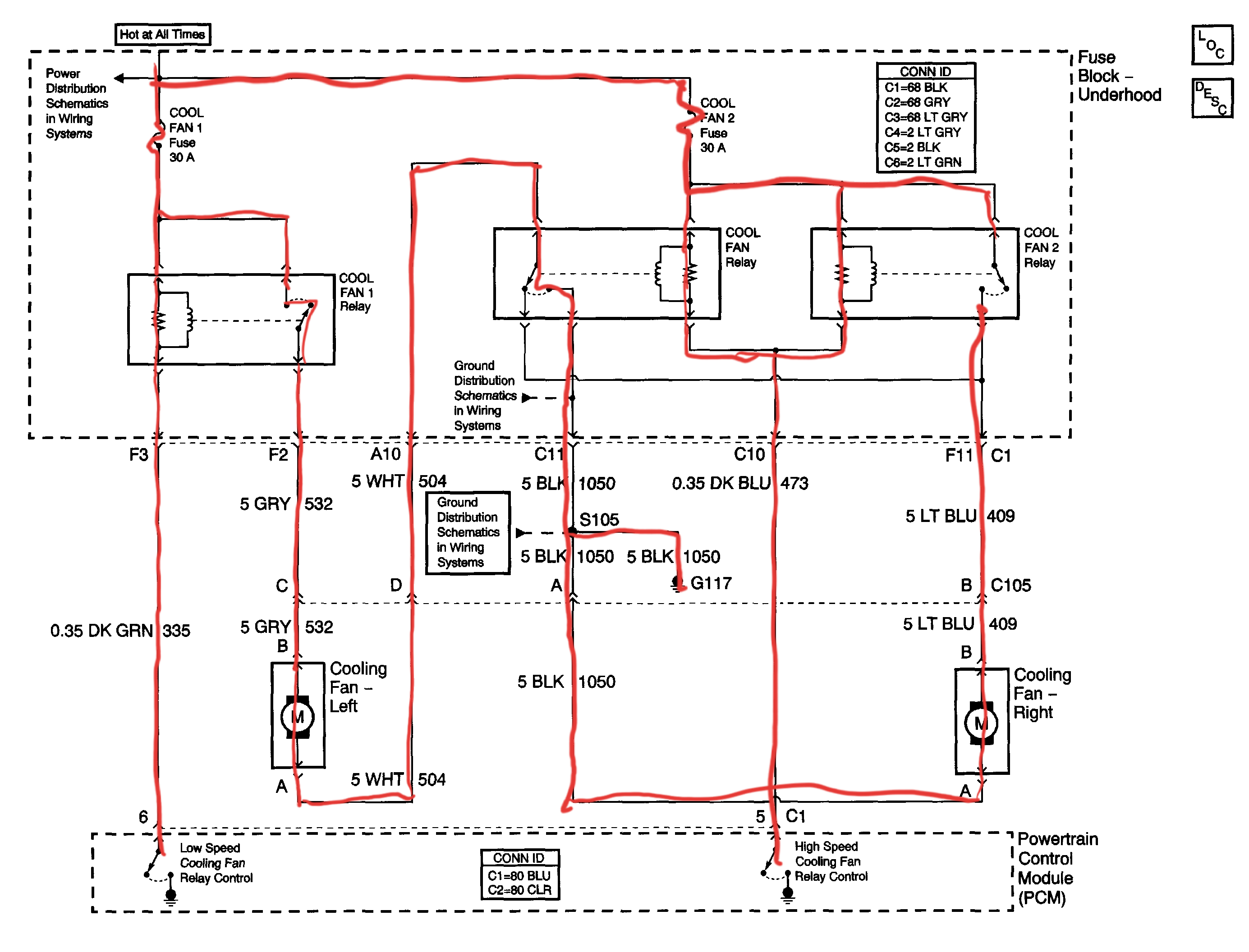

 The engine cooling fan system consists of electrical cooling fans and 3 fan relays. The relays are arranged in a series/parallel configuration that allow the Powertrain Control Module (PCM) to operate both fans together at low or high speeds. The cooling fans and fan relays receive battery positive voltage from the underhood junction block. The ground path is provided at G117.
 During low speed operation, the PCM supplies the ground path for the low speed fan relay through the low speed cooling fan relay control circuit. It energizes the cooling fan 1 relay coil, closes the relay contacts, and supplies battery positive voltage from the cool fan 1 maxifuse- through the cooling fan motor supply voltage circuit to the left cooling fan. The ground path for the left cooling fan is through the cooling fan relay and the right cooling fan. The result is a series circuit with both fans running at low speed.
 During high speed operation the PCM supplies the ground path for the cooling fan 1 relay through the low speed cooling fan relay control circuit After a 3-second delay, the PCM supplies a ground pattern for the cooling fan 2 relay and the cooling fan relay through the high speed cooling fan relay control circuit. This energizes the cooling fan relay coil, closes the relay contacts, and provides a ground path for the left cooling fan. At the same time the cooling fan 2 relay coil is energized closing the relay contacts and provides battery positive voltage from the cool fan 2 maxifuse on the cooling fan motor supply voltage circuit to the right cooling fan During high speed fan operation, both engine cooling fans have there own ground path. The result is a parallel circuit with both fans running at high speed.
Engine Coolant Indicators Hot Coolant Temp
 The IPC illuminates the hot coolant temperature indicator in the message center when the IPC determines that the coolant temperature is greater than 128°C (262°F). The IPC receives a class 2 message from the PCM indicating the coolant temperature.

It does have new cap and thermostat.

I have seen a blown head gasket cause this issue lets confirm by following this guide.
Please start a new thread for the transmission temperature sensor and I will send you the instructions on how to change it out. Please run down this guide and report back.
