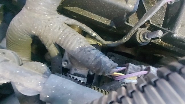

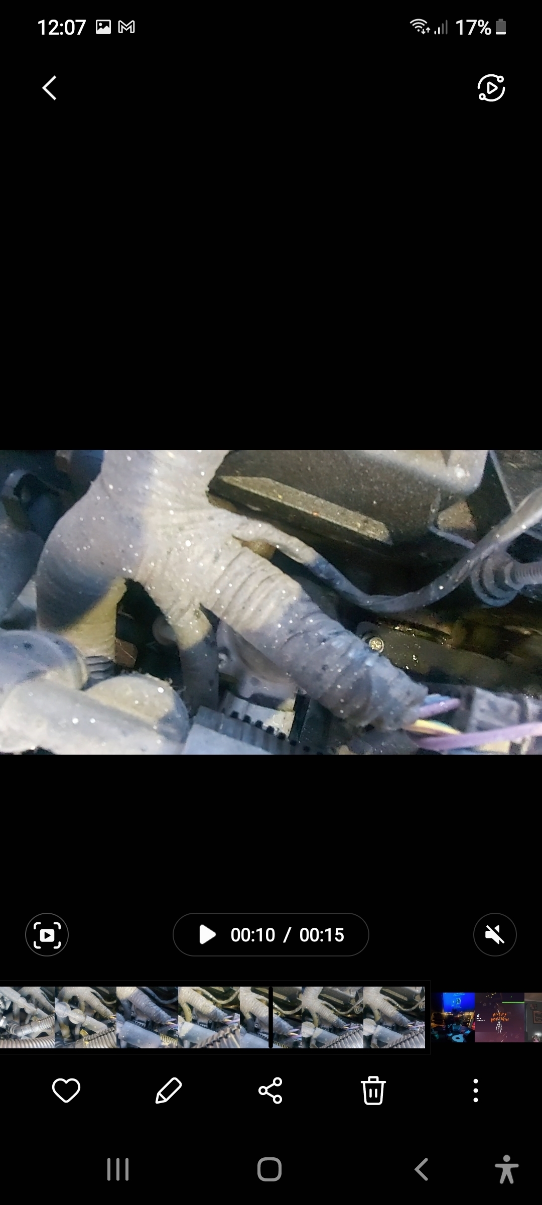

I know that video may be hard to tell but can you tell me if that is my water outlet under them wires it was spitting out fluid. I believe it is but just not sure.

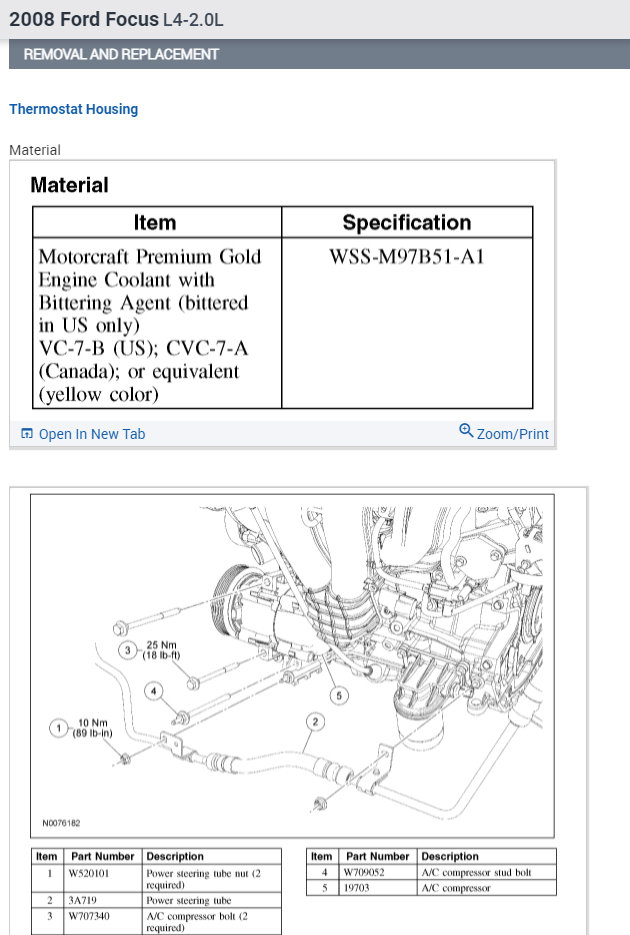

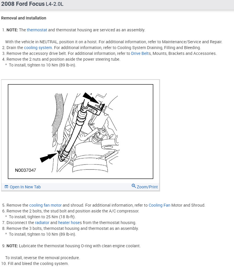

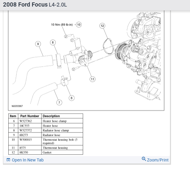

It is hard to tell from the pictures you uploaded. Can you possibly have a different angle?
The top right side should have the thermostat housing. The gasket around that housing can leak.
