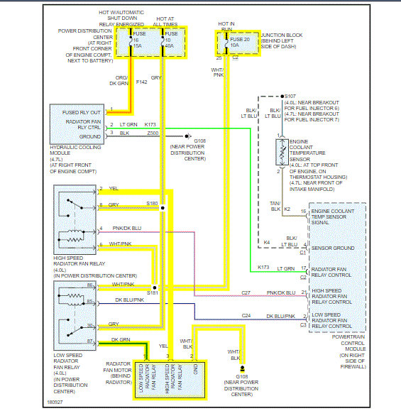

After replacing the radiator and thermostat, I let the car idle
for 20 minutes temperature went to about 220 electric fan came on for only
about one minute and shut off. From this point temperature continue
to climb until warning light came on. Fan never did come back on??

I did as you recommended but no luck. Is it possible to have a bad fan control and it come on for such a short period of time? Should the fan stay on until the temperature goes down to normal??

If there is air in the system from a leaking head gasket, the fan will not work long as it needs to be in coolant to send the proper signal to the relay for turning on the fan.
I attached the wire diagram for you to view. Check the fuses for power with the key on to be sure power is sent to the relays.
