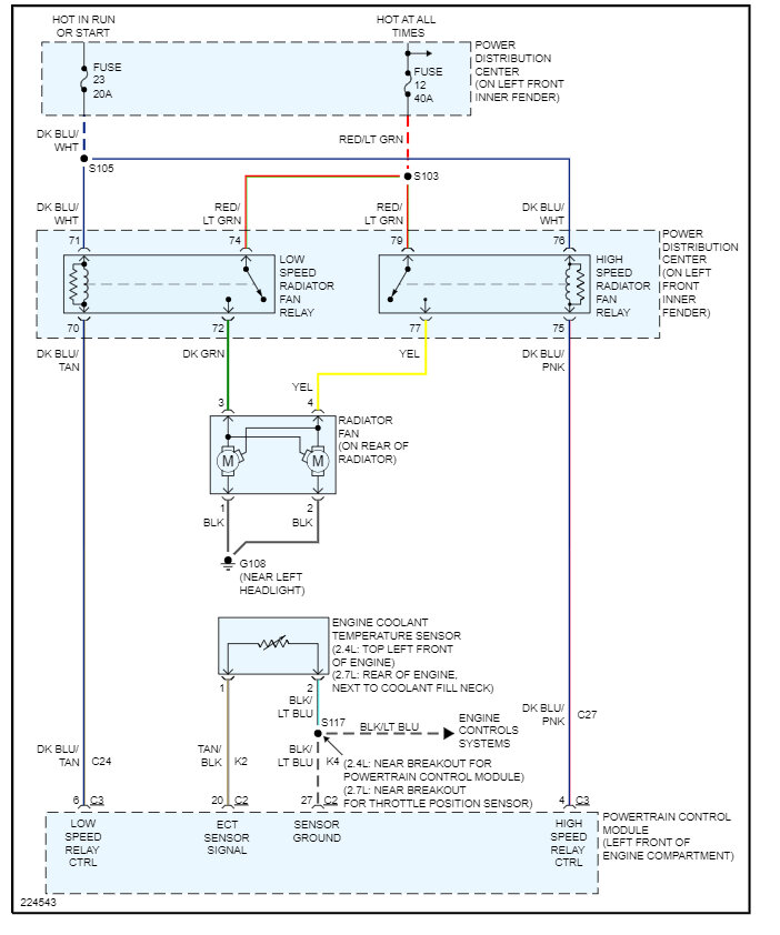

Replaced both the thermostat and cap had the issue of engine stalling when turning the heater on and took out the A/C clutch and was able to fix the heater problem. I am currently having fan issue it is not working, will the temperature relay fix this issue?
Apr 27, 2023 at 11:30 AM
  • 55,433 POSTS
Chances are the cooling fan motor has gone out, but to be sure here is a guide to help and the fan wiring diagrams and how to check for power in this guide as well:
https://www.2carpros.com/articles/replace-electric-fan-motor
and
Check out the images (below). Please let us know what happens. Also check the fuses #23 and #13 under the hood.
