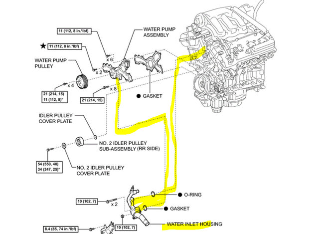

Absolutely there should have been coolant. We found the problem. Now we have to find the cause. If you disconnect the return line and start the engine, does coolant come out of it?
Also, when the pump was replaced, was the water inlet housing correctly installed? That distributes coolant as well. It sounds like something is blocking it. See pic 1 for what I'm referring to.

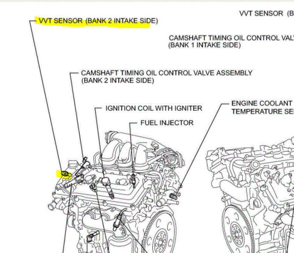

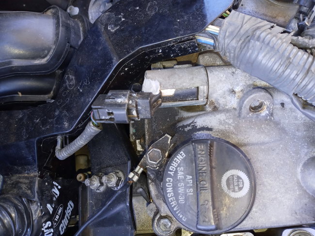

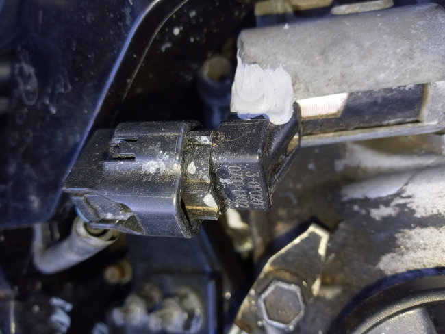

Joe, i am going to send two pics of a part that got broken when the water pump was getting replaced. 1, is the part blown up the other is so you can see where it's located. I don't know what this is but as you can tell i did a little repair do you know what it is? Thanks, pk
Dec 20, 2020 at 6:52 AM
  • 110,248 POSTS
That is a VVT sensor (variable valve timing). IF it isn't working, it would set a check engine light. (see pic 1)
