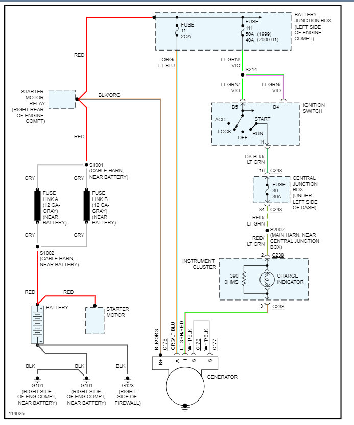

I discovered that the alternator was charging at14.8V on a full load... (everything turned on) I changed it out with an old one I took from the same vehicle, and it is over-charging at 17.9V with a full load.
I suspect the voltage regulator on each one, but I wonder if it could be anything else. Like maybe a PCM issue?
If you have any ideas, I'd like to hear them.

These vehicles had problems with the plug at the alternator so I would look at that first to check for melted connectors. Next, check the engine ground to battery and then the battery to chassis ground. It does not look like the PCM is involved in the charging system, here are the alternator wiring diagrams so you can see how the system works. Check out the images (below). Please let us know what happens.
