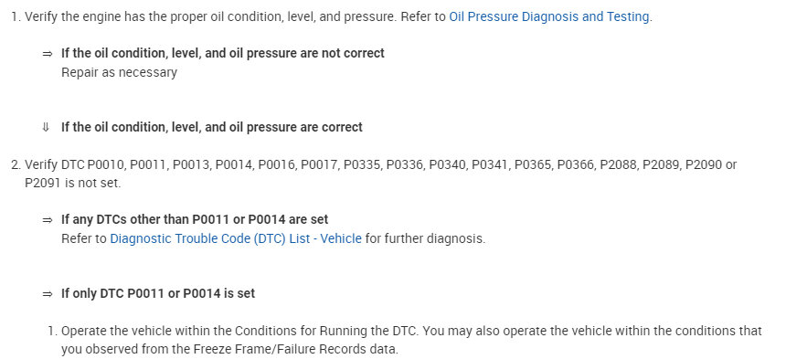

I have code P0011. I had it checked and said over advanced timing. I'm wondering how to fix this issue. Thanks.

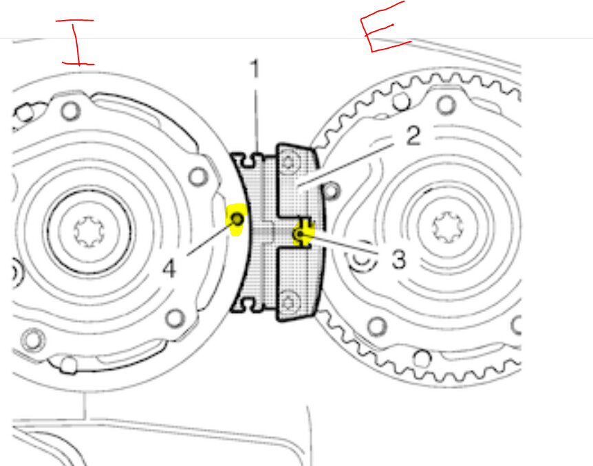

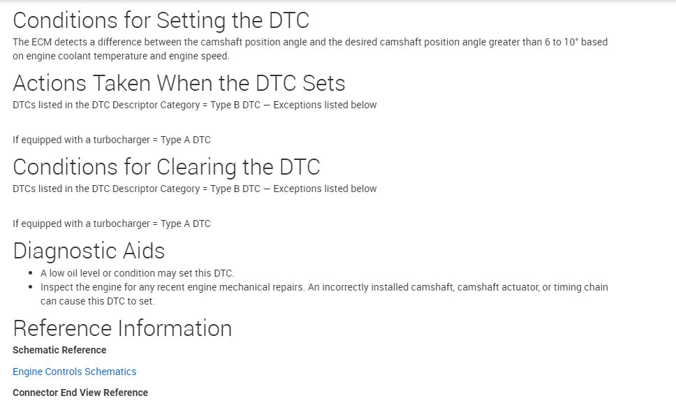

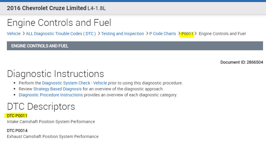

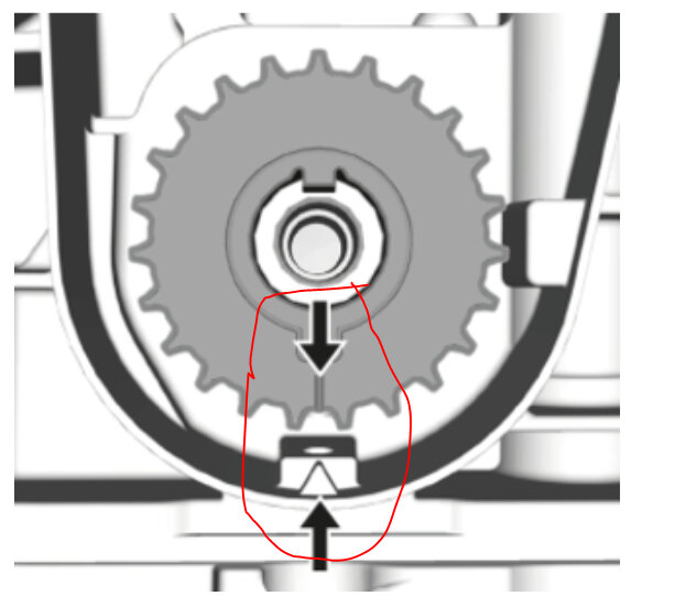

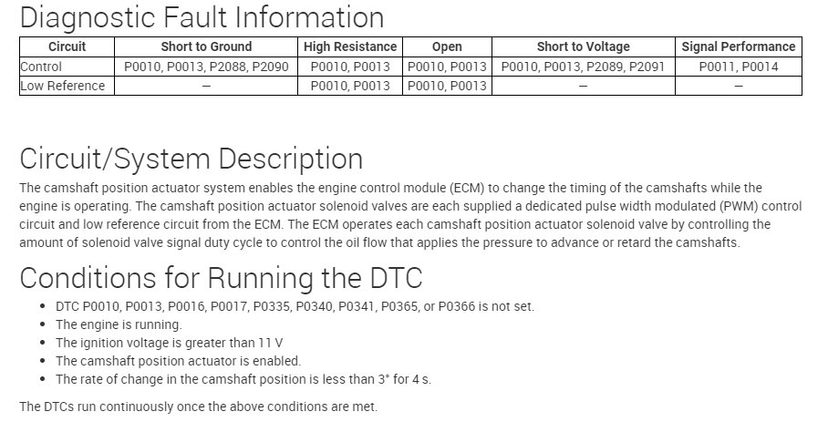

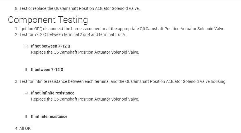

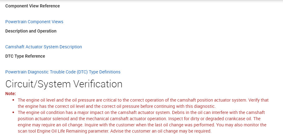

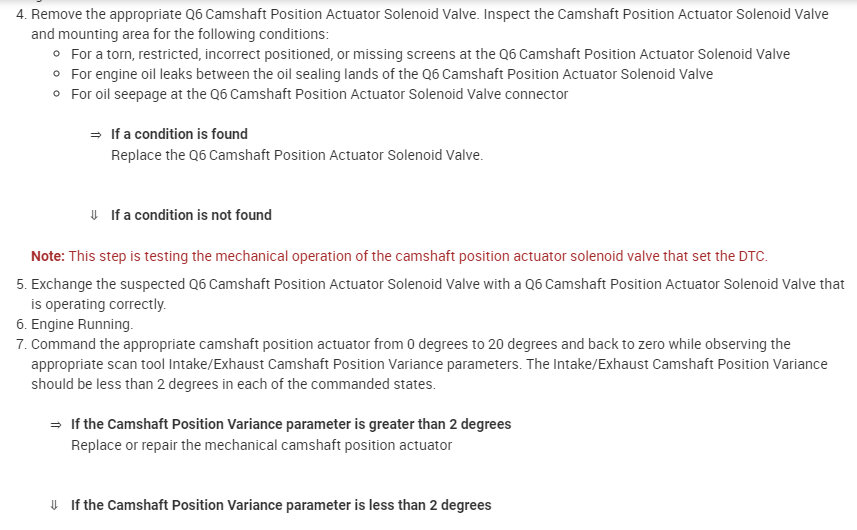

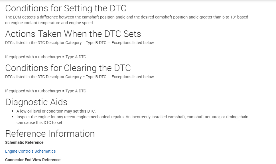

The code indicates the intake camshaft actuator solenoid has a fault. Basically, the PCM can't change the timing of the intake side.
Now, my first thought was the belt may be a tooth-off. So, I attached two pics below showing timing marks. Please confirm that is how it was done. In pic 2, note the positioning of the intake cam timing mark is just above the mark on the cam locking tool and the exhaust is perfectly aligned. That is how it is put together.

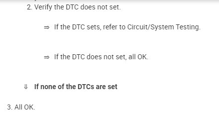

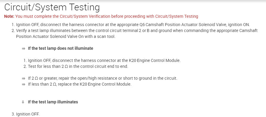

The remaining pics are the diagnostics related to the code. Take a look through them and let me know if you feel comfortable performing them.

I didn't change the timing belt to begin with. Chevrolet did. So, looking at those doesn't help me. I paid Chevrolet to do all these things. Got charged $3,500.00 for repairs and I'm still left with this.
