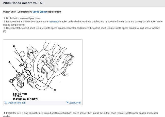

Where is the Output Transmission Speed Sensor located?
2008 HONDA ACCORD
100,000 MILES • 3.5L • V6 • AUTOMATIC
TYLERMCC009
MEMBER
1 POST
i looked everywhere can’t find output only input.
Feb 28, 2023 at 1:23 PM
Experienced Mechanic
55,588 POSTS

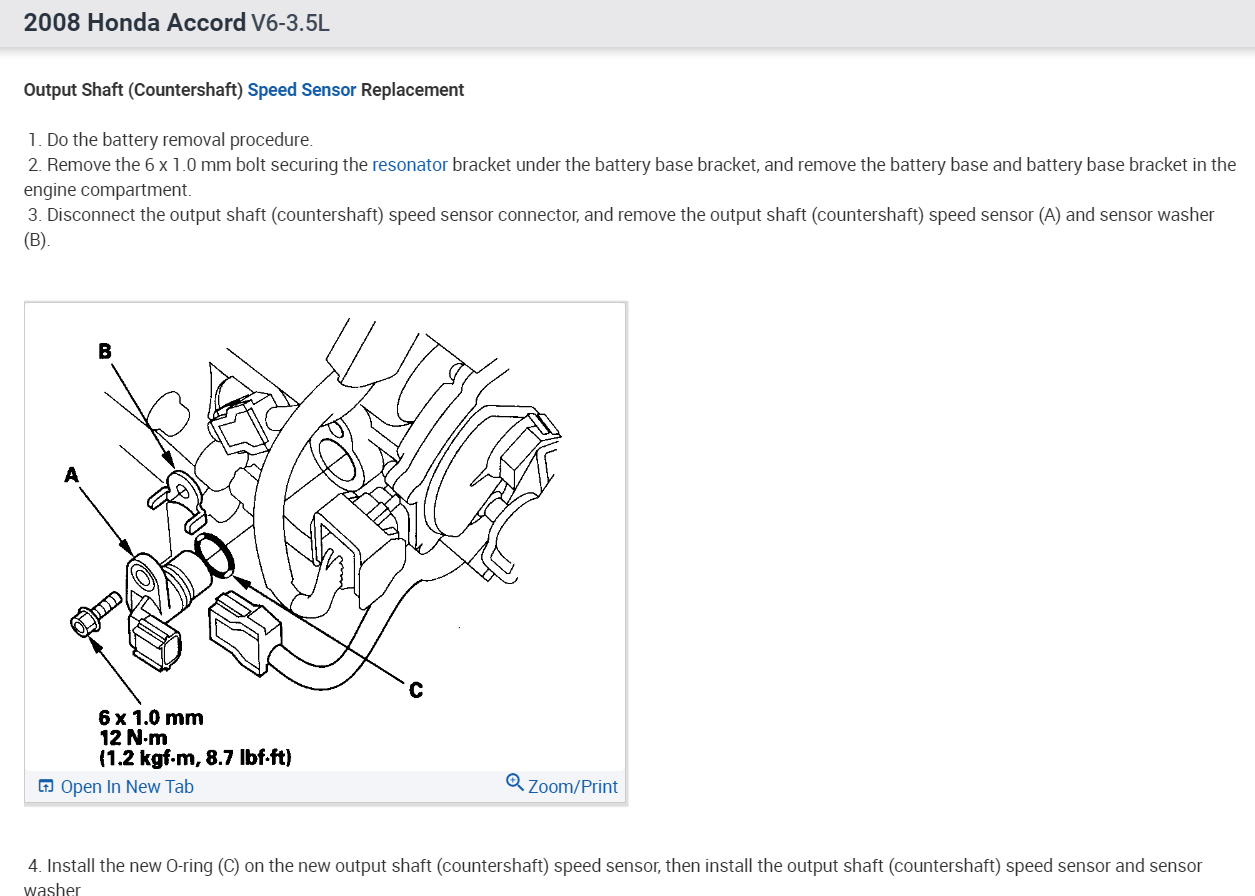

It looks like it is on the transmission case near the main electrical plug here is an image of the location below. Please let us know if you need anything else to get the problem fixed.
