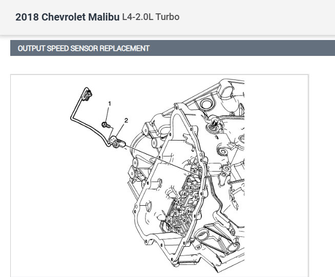

I have bought the part, but I have yet to be able to find it on the transmission. It’s a 9 speed automatic. Everything I’ve read it says it’s on the inside. I would really like some help, i definitely don’t want to have to pay hundreds of dollars for a $30 part.
Jan 6, 2025 at 8:37 AM
  • 110,248 POSTS

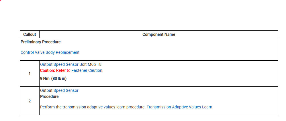

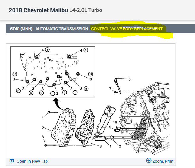

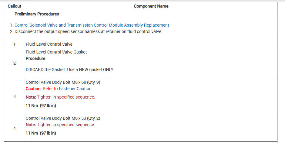

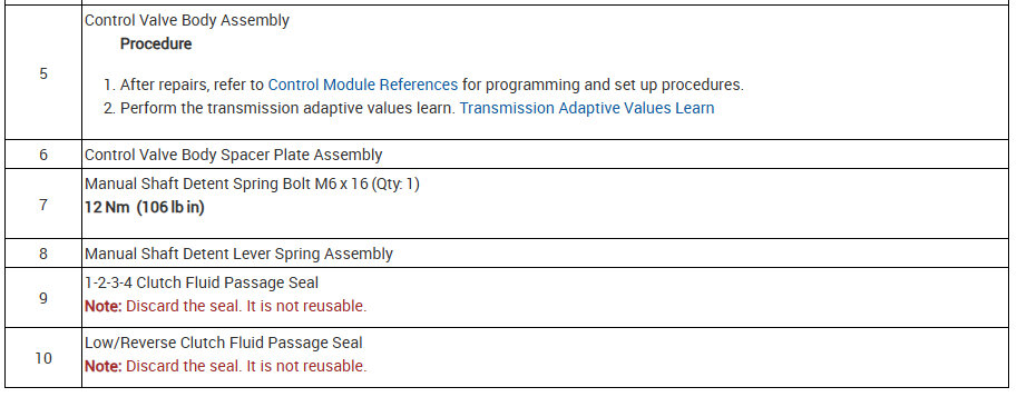

To access the VSS, the transmission pan needs removed and the valve body.
I attached the directions below for replacing the sensor as well as removing the valve body.
Take a look through the directions and let me know if you have questions.
