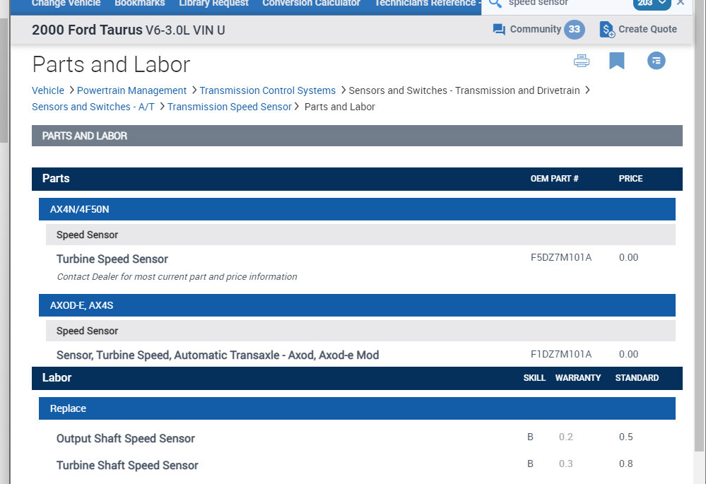

My transaxle is an AXOD metric and the only output speed sensors I find are for the AX4S or AX4N transaxles. Is the AX4S sensor the same as the AXOD? The VIN number is 1FAFP5227YG157406.

To answer your question, the AXOD and AXS4S are the same speed sensor. They are different units slightly, but the speed sensor is the same.
Please see the attached info but it appears F1DZ7M101A is the part number that you need for AXOD.
Please let us know if you need more info.

That part number is the input sensor, but it helps because now I'll order the output for the AX4S that comes up as xf2z7h103aa.
Jun 12, 2022 at 11:23 AM
Sorry. You are correct. I didn't even notice that it says Turbine speed sensor. That is the input.

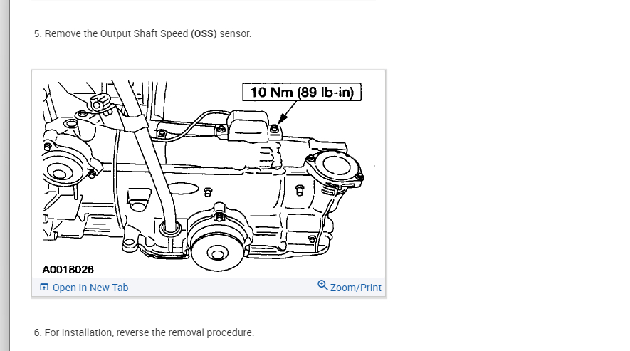

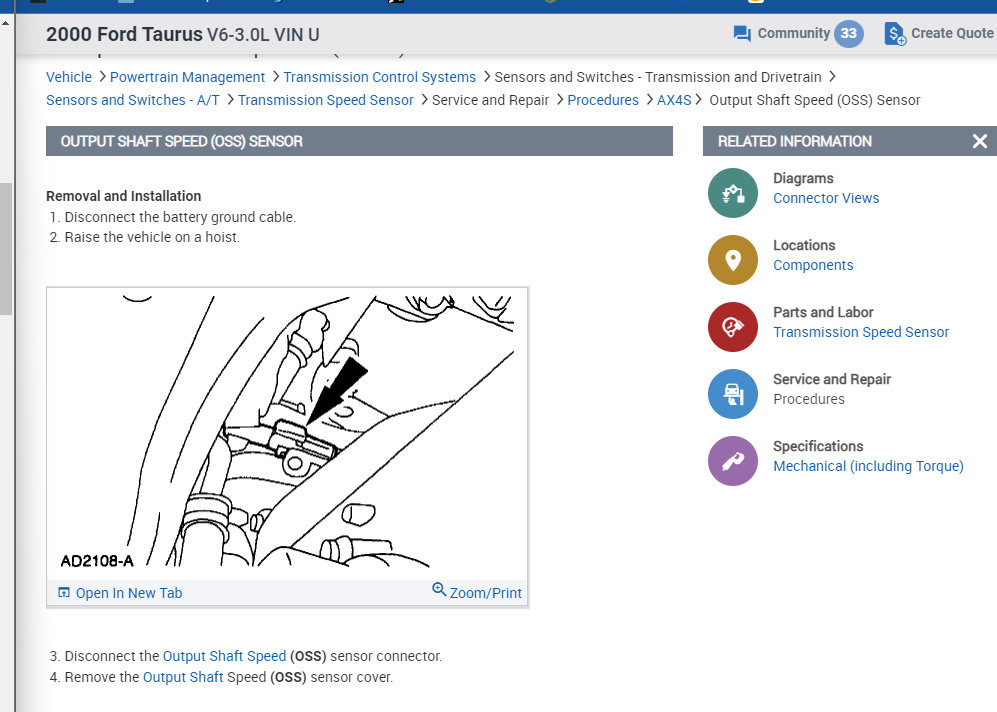

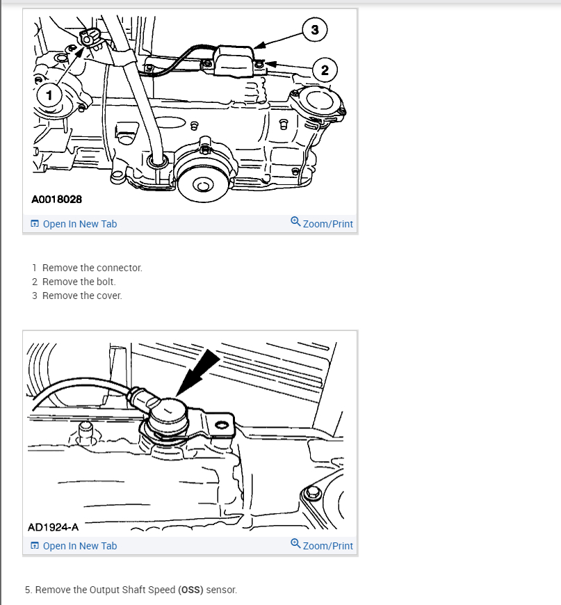

Unfortunately, the manual doesn't have one for an OSS, but I am attaching the process for the AX4S.
