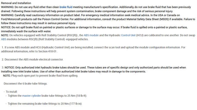

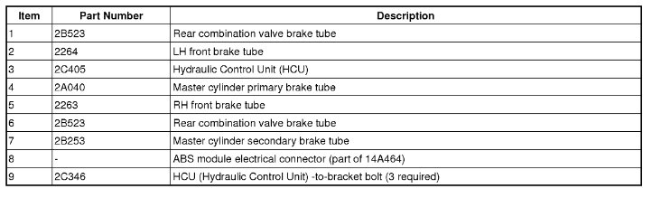

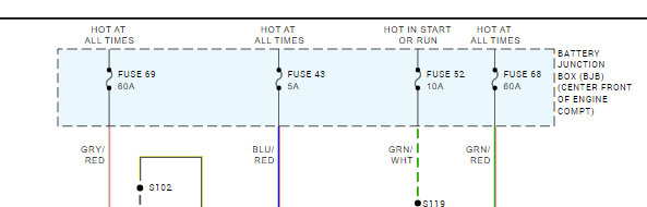

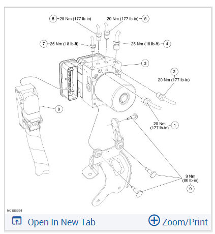

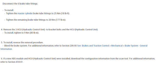

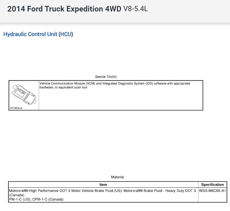

Yes, because the vehicle has no MPH data due to the failed ABS module, but I would check the fuses first just to be safe. Here is a guide and the fuses that need to be checked in the images below.
Check out the images (below). Let us know how it goes.
Oct 6, 2024 at 11:17 AM
ASHLEY.LEANN
Fuse 52 was not hot, changed it and now it’s hot. RPMs are lower now and shifting without issue. Fuse wasn’t blown, confused on why it wasn’t working.
Oct 7, 2024 at 7:26 AM
  • 55,721 POSTS
It could have been a bad connection that you fixed by simply removing and replacing the fuse. So, to confirm the problem is solved?
