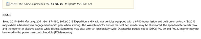

Do all 2012 Ford Expedidtions with a 5.4 V8. have an ouput speed sensor?

it's a separate part from the pic I sent but you have to drop the pan and it's inside the part called a leadframe behind the valve body. It may be part of the leadframe assembly . however if you are getting a code for that it may not be the problem read the pic that i'm sending if you are experiencing this symptom then it may be from this tsb which the dealer should fix at no cost.

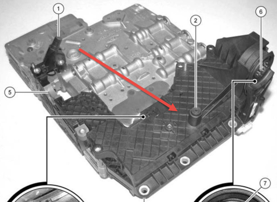

yes otherwise your cruise control/abs/and speedo wouldn't work all cars have them. on your vehicle it is located in the valve body see pic

GATORSFAN77
So is part of the valve body or a separate part?
