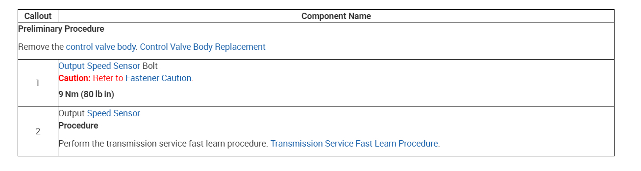

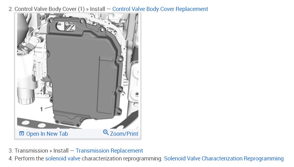

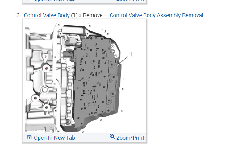

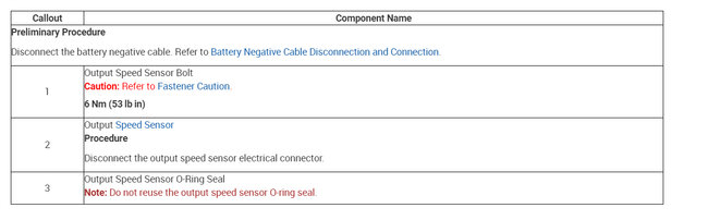

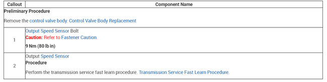

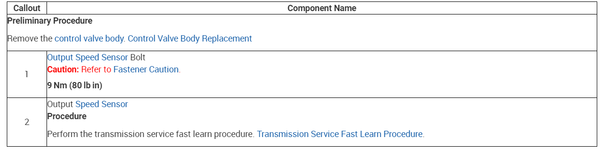

It looks like the output speed sensor is inside the transmission under the valve body. here are instructions on how to change the sensor out. Check out the images (below). Please let us know if you need anything else to get the problem fixed.

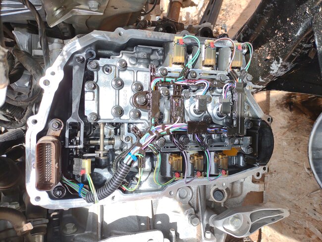

I took off the vavle to the transmission, and the speed sensor located inside is actually an input speed sensor. I'm looking for the output speed sensor circuit?
Jan 18, 2023 at 12:34 PM
  • 55,710 POSTS
It says it is an output speed sensor? Why do you say it is an input speed sensor?

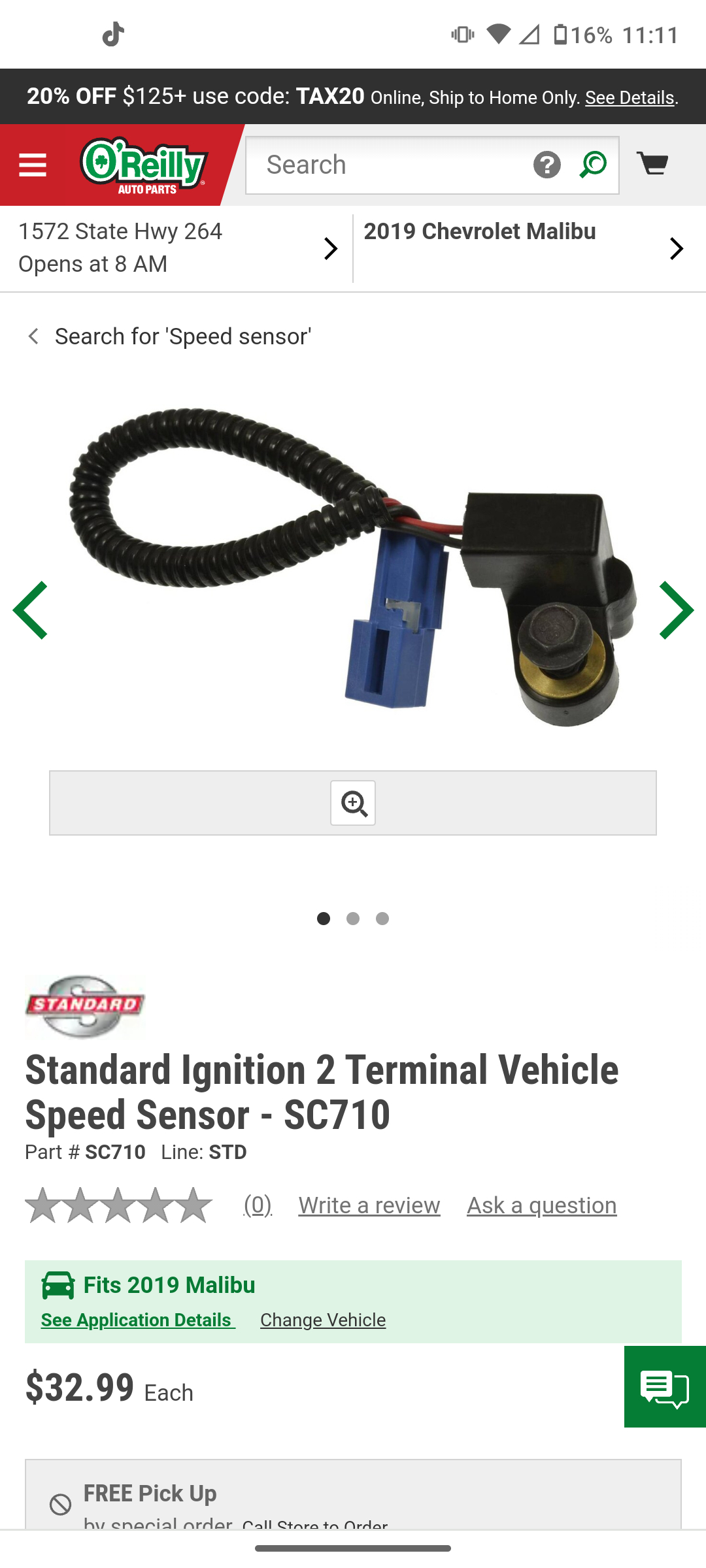

This is the part they gave me at O'Reilly's, for Code Po722. They said it's mounted onto the transmission frame. but I don't see anywhere..

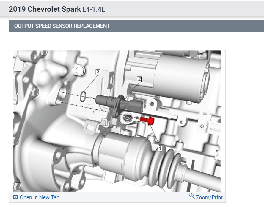

And I did what you're telling me to do, and this other part, is what I found behind the transmission valve body. and the part that I got from O'Reilly's they are completely different parts. I looked up the one behind the transmission valve body and that comes up at input speed sensor.
Jan 21, 2023 at 2:20 PM
  • 55,710 POSTS

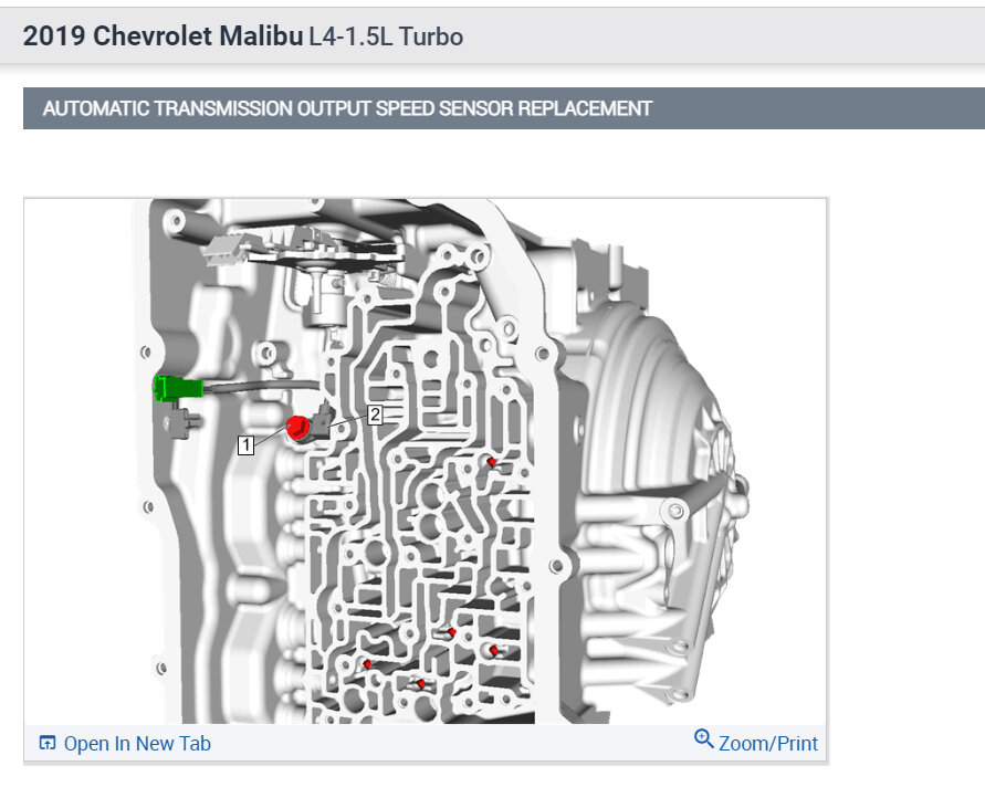

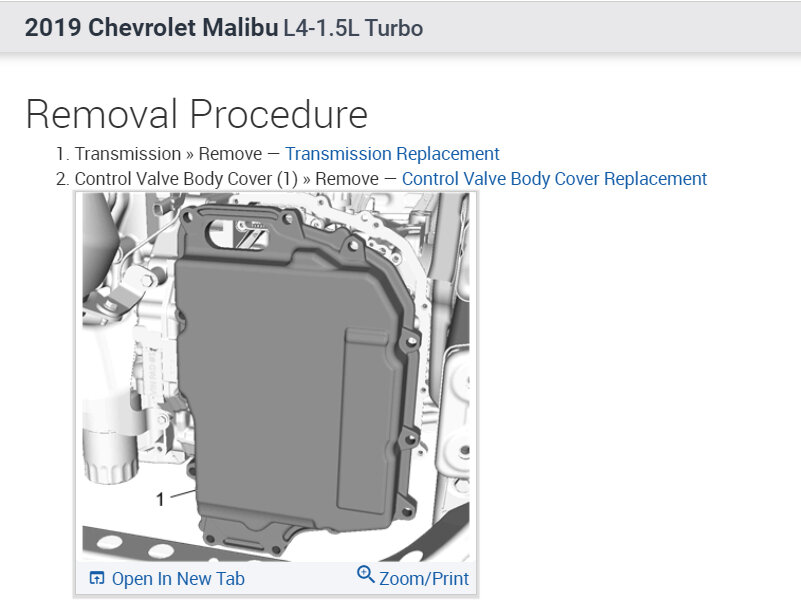

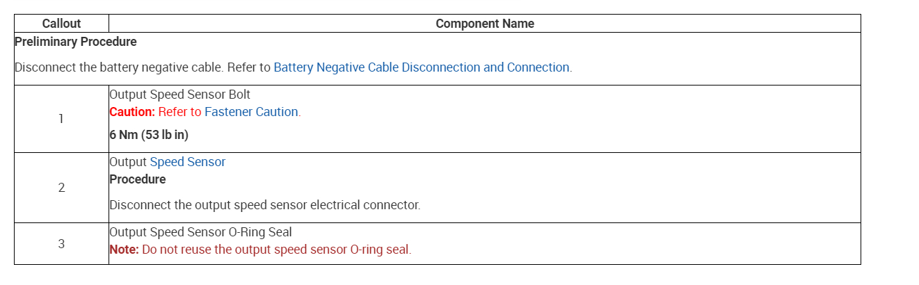

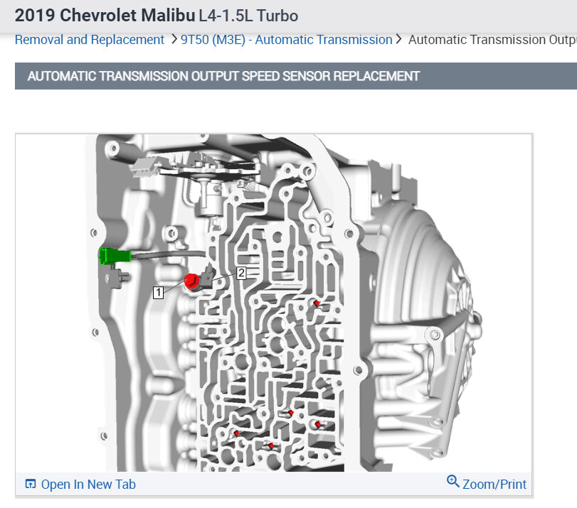

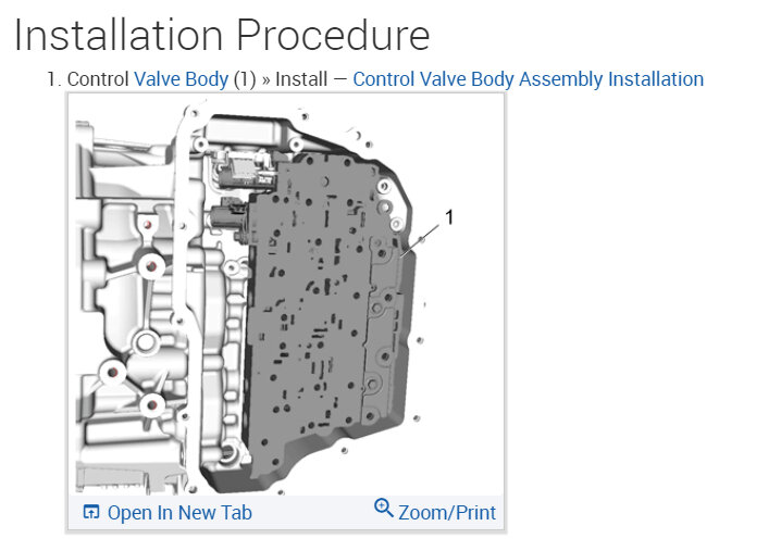

Sorry, it looks like AllDATA got their wires crossed, I rechecked it again and here is the location of the output speed sensor, sorry for the confusion.
