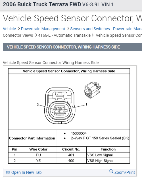

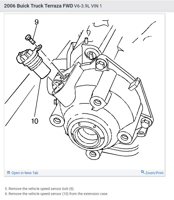

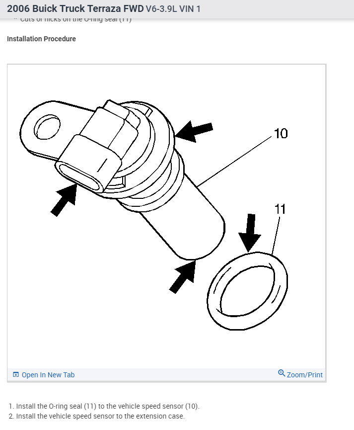

Where is the output shaft speed sensor located?
180,000 MILES • 3.9L • 6 CYL • 2WD • AUTOMATIC
LONDON TOWNES

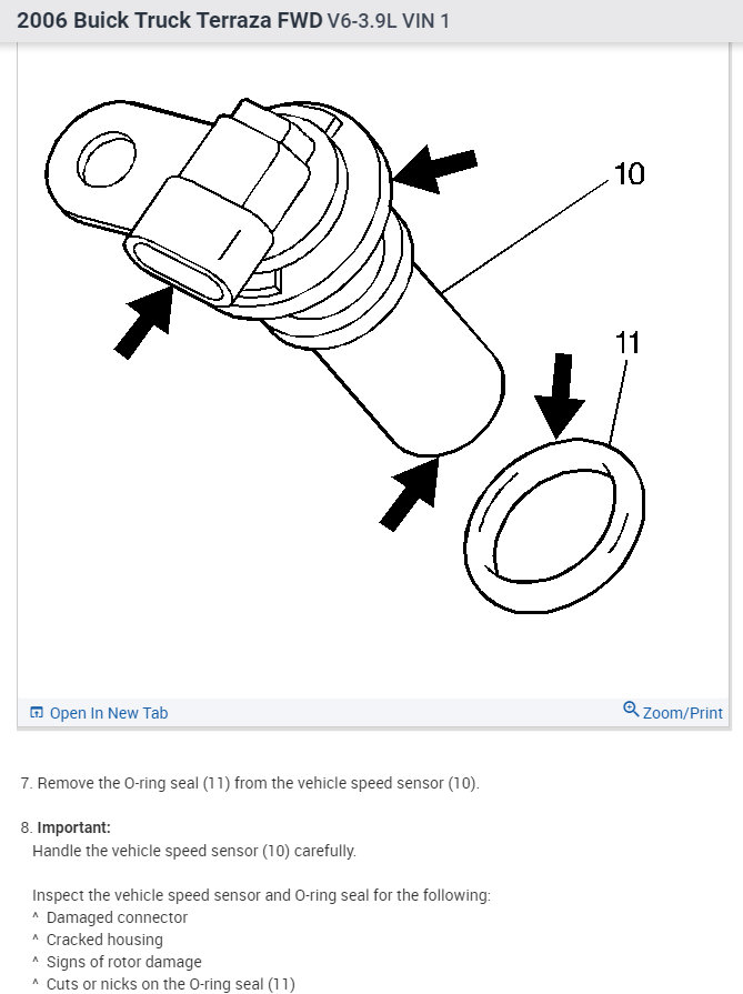

where is it located?
Nov 19, 2021 at 3:44 AM
SQM
  • 6,383 POSTS

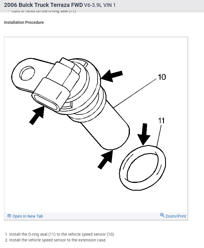

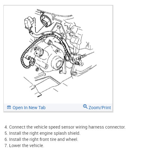

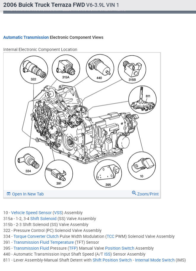

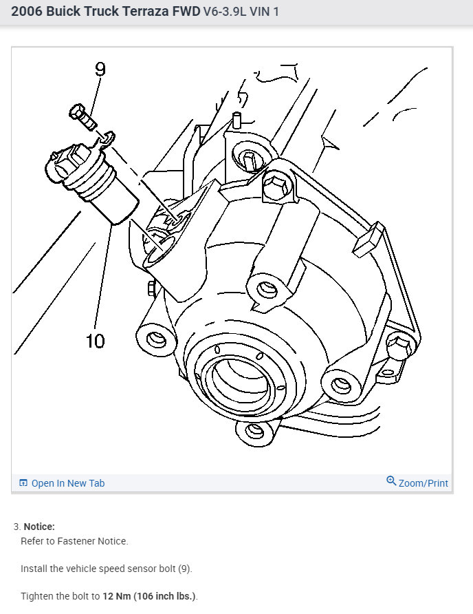

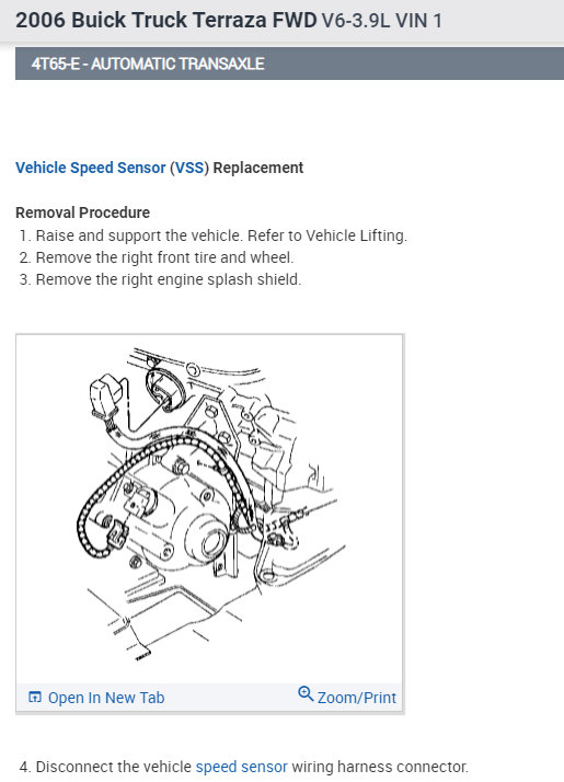

The vehicle speed sensor is located on the side of the transmission right before the output shaft. In order to access it you will have to remove the passenger side wheel and the fender liner.
