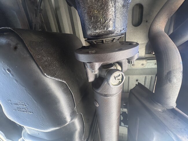

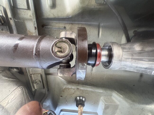

Car was vibrating at high speeds and then output shaft seal popped out so I changed transmission mount and u joints and seal. Popped out again so I changed yoke and trans extension housing. That lasted a while but then vibration started only when I let go of the gas pedal at high speeds to coast and then it popped out again last night. It looks like driveshaft is angled weird. I don’t remember if it was like that already. The driveshaft is fine but something is continually making the seal come out. I guess it could need to be balanced but I really don’t think that’s the issue. Is there anything else can cause it? Lead springs? Suspension? I don’t know. I’ll include pictures

Here is a pic. I can upload more if needed

Yes, please upload more images of the truck and suspension. I have a question, is the truck lifted? If so the driveshaft is to short which makes the input yoke wobble and causes the vibration and the seal to "pop" out. In this image is the rear wheels on the ground, normal load?
