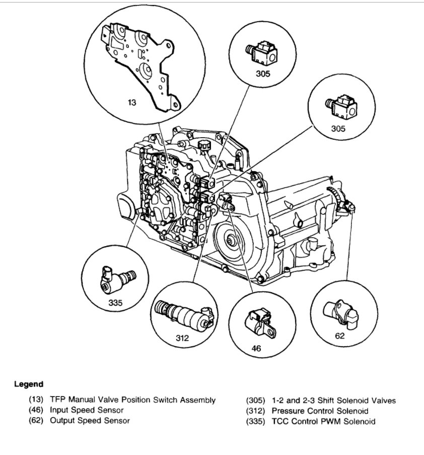

Where do I find them? Replaced one but cant find the other one.

I have found this diagram (below) to show you where each of the speeds sensors are located.
Image (Click to enlarge)
