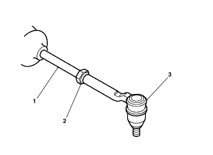

Tools Required

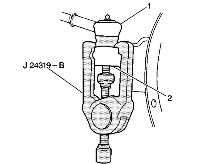

J24319-B Universal Steering Linkage Puller
Removal Procedure
1. Raise and support the vehicle. Refer to Vehicle Lifting.
2. Remove the front wheel

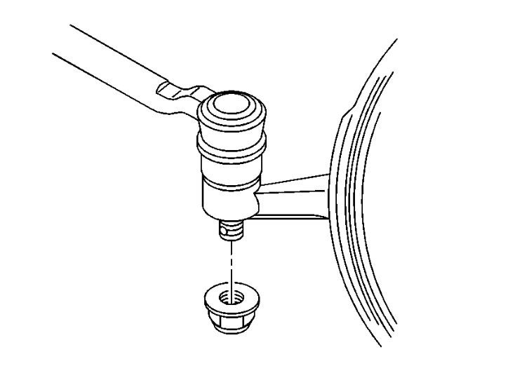

3. Remove the tie rod ball stud nut.

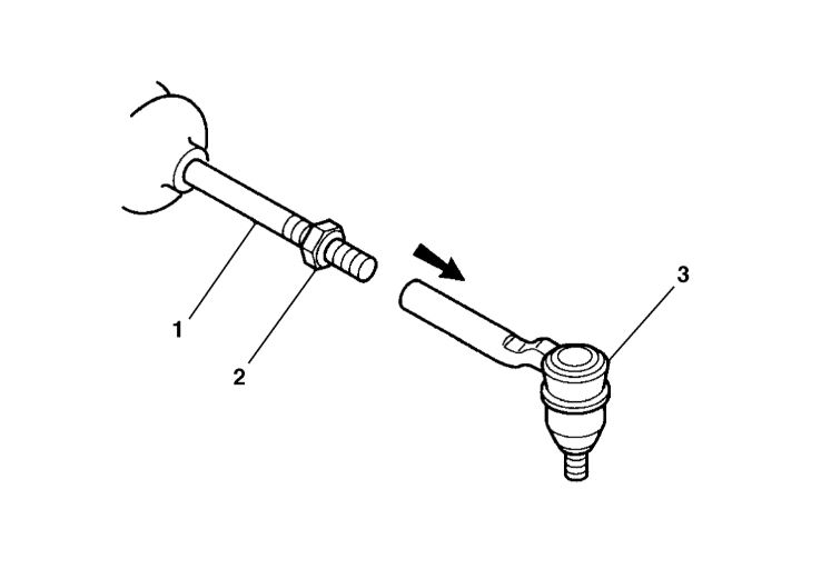

4. Loosen the tie rod jam nut (2).
5. Notice: Do not attempt to free the ball stud by using a pickle fork or wedge type tool, because seal or bushing damage could result. Use the proper tool to separate all ball joints.
Use the J24319-B in order to separate the outer tie rod (1) from the steering knuckle (2).
6. Remove the outer tie rod (3) from the inner tie rod (1).
