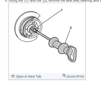

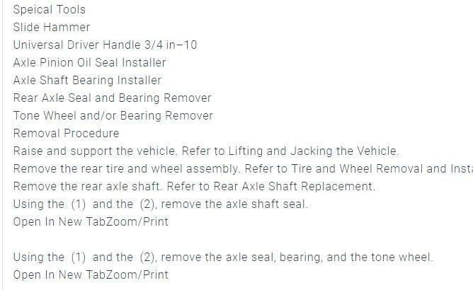

Had to grind the outer race to remove the bearing and the rag I stuffed in the axle tube slid up to the inter bearing. My question is, how do I get all those shaving's out of the bearing and tube? Thanks
Dec 21, 2020 at 10:41 PM
Good evening,

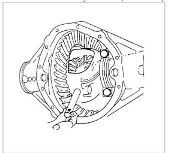

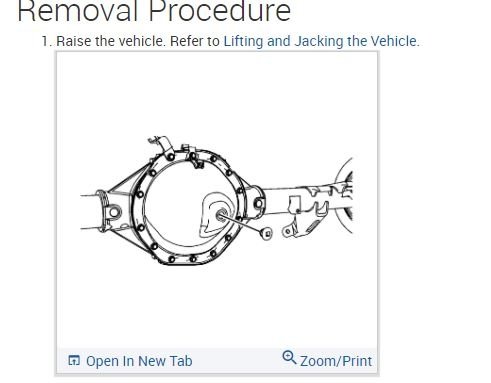

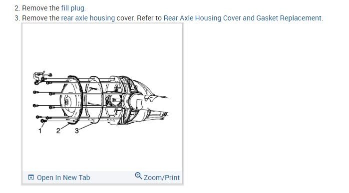

You will need to remove the cover from the differential and flush out all the debris down the tube.
https://www.2carpros.com/articles/differential-service
No metal can get to the carrier. If it does, it will damage those bearings as well.
https://www.2carpros.com/articles/rear-axle-seal-replacement

What is the best thing to flush it with? Thanks
Dec 22, 2020 at 7:41 AM
I use brake Kleen. Great product.
You will need around 8 cans.

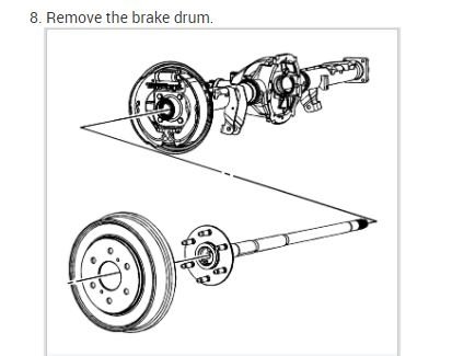

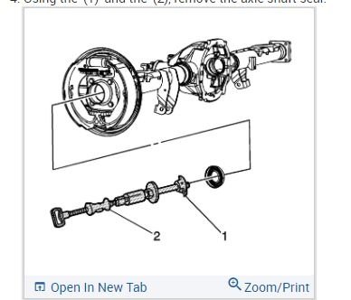

Got everything cleaned out reinstalled bearings and the left rear axle was hard going in. Had to tap on it, to get it in far enough to put C- clip back on. Had to pry it out to lock it in place. Is this normal or do I have a problem?
Dec 28, 2020 at 9:50 PM
You have a problem. It may be a little difficult to get the clip on but otherwise, it should slide in and out easily.
Does it go through the new bearing easily?

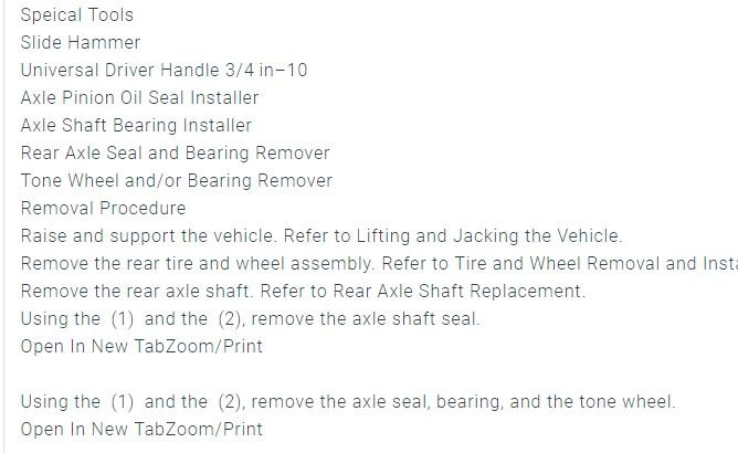

Raise and support the vehicle. Refer to Lifting and Jacking the Vehicle.

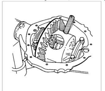

Remove the pinion shaft locking bolt.

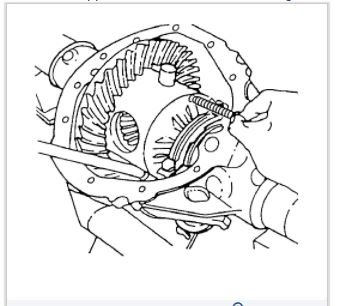

On axles without a locking differential, remove the pinion shaft.
Open In New TabZoom/Print
On axles with a locking differential, remove the shaft part way. Rotate the case until the pinion shaft touches the housing.

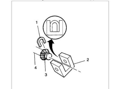

On axles with a locking differential, use a screwdriver, or a similar tool, in order to enter the differential case and rotate the lock (1) until the lock aligns with the thrust block (2).

Remove the brake drum.
Push the flange of the axle shaft in toward the differential.
Remove the C-lock from the button end of the axle shaft.
Remove the axle shaft from the housing

It does go in easy, until the couple of inches then I have to tap on it or turn it until the axle is all the way in.
Dec 28, 2020 at 10:34 PM
Okay, that is normal.
Dec 28, 2020 at 10:44 PM
BUBBA ROGERS
  • 8 POSTS
It has no in and out movement like the right side does.
Dec 28, 2020 at 10:47 PM
As long as you got the pin installed, then you are good. Some have play and some do not.
