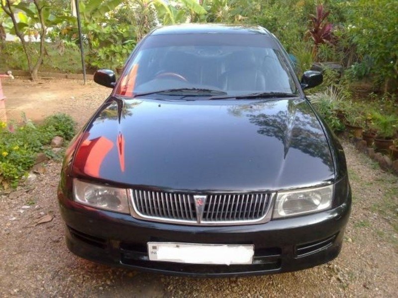

I have a Hyundai Accent car. I want to replace the body of Accent car by Mitsubishi Lancer 1998 model body (India).
- Can i do this in Delhi?
- What cost it will take?
- What could be the legal issues (like chassi number etc) in it and how can i resolvee it?
- How can i maintain and service it in future?
Please let me know any possible way other suggestions. If it requires to do replacement of body on any new car or any other car like Maruti etc. i want to have exactly Lancer looking car.

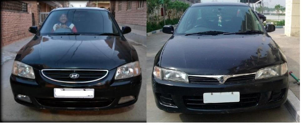

Thanks. How and from where i can get the legal knowledge about this for Delhi (India)? Could please refer me any online link or i need to visit Authority or any Govt office?
Just want you to see the pictures (in attachment) of both the cars having similarities in shapes.

Shape does not really matter when nothing interchanges.
Not being in India, I do not know who writes and enforces your vehicle laws. Plus the law could be written very vague like; "No motor vehicle over fifteen years old may be operated on the highway".
With nothing to tell you specifics.
