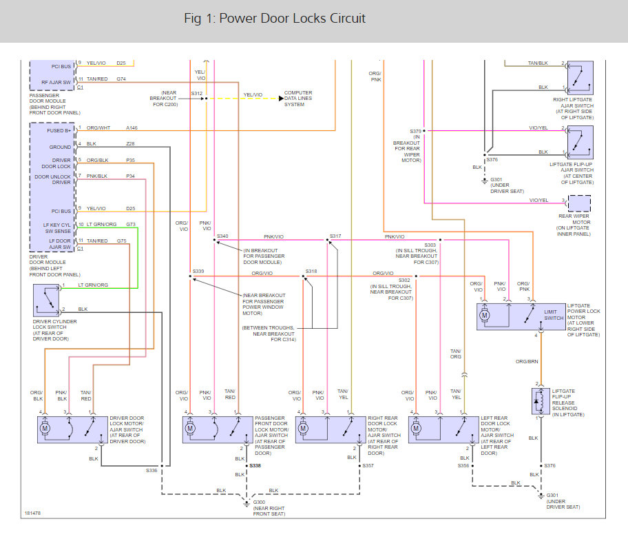

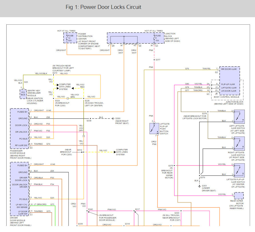

When I use the proximity unlock from the driver's side or when I use the door switch, only the driver's side lock unlocks. However, from the passenger side or key fob, all four locks unlock. So when I enter the car with my family, I either have to reach across and unlock the doors or remember to use the fob. Ideas?
Aug 3, 2020 at 3:14 AM

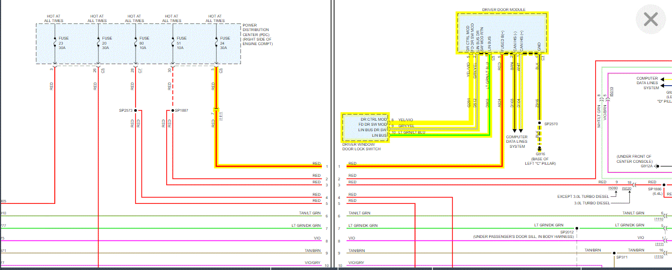

Good afternoon,
I attached a wiring diagram for you to view. The door module may be the issue but it needs to be confirmed.
You need a scan tool that can read the door module to verify the signal from the switch is being sent to the module. Then the module sends a signal to the body control module to work the other locks on command.
You can check the fuse I listed but the real check needs to be done with an advanced scan tool.

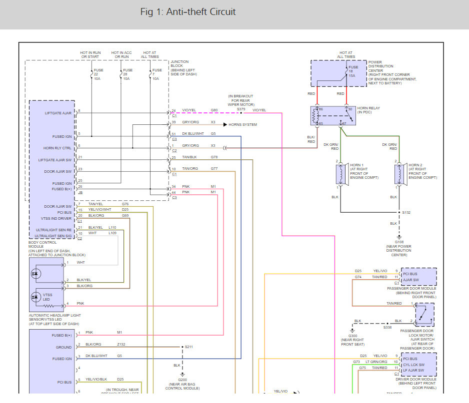

the horn has been randomly going off on. also, noticed out headlights flicker on and off but when i put it on high beam then back on low they do fine. we changed the horn relay which was fine, then the totally integrated control module which was not. checked all the wires we could see and find no issues. not sure where to go from here. oh and now my windshield wipers turn on when starting and cutting off the vehicle. also, power locks and windows do not work.

Did you use a new TIPM or a used one?
Have you tested the front control module, it is bolted to the front of the TIPM. It controls most of the items you're having problems with. Also, check the grounds next to them. If they fail you get various problems as the control voltages start fluctuating.
The other issue could be odd data on the CAN buss. That takes a break out box and analyzer to look at.
I would take a look at the data on the buss and off a good scan tool and see what is being commanded to do what.
Also check the actual power distribution center, they fail a lot as well.
Hard to do much of that testing without a scan tool that let's you watch or command the various modules though.

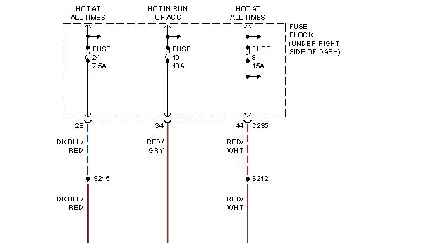

Interior lights stay on while driving and the driver door is the only one that locks automatically. I have to cut lights off with dimmer switch and then there are no lights on the panel to see speedometer at night.
Aug 29, 2020 at 5:37 AM (Merged)
  • 55,433 POSTS

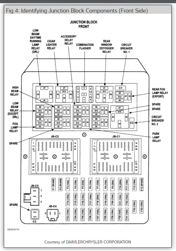

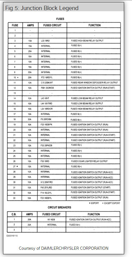

It sounds like you have a fuse #15 fuse that is out and needs to be checked. Here is a guide to help you get the job done:
Here is the location (below).

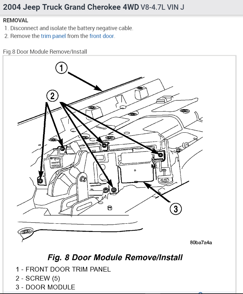

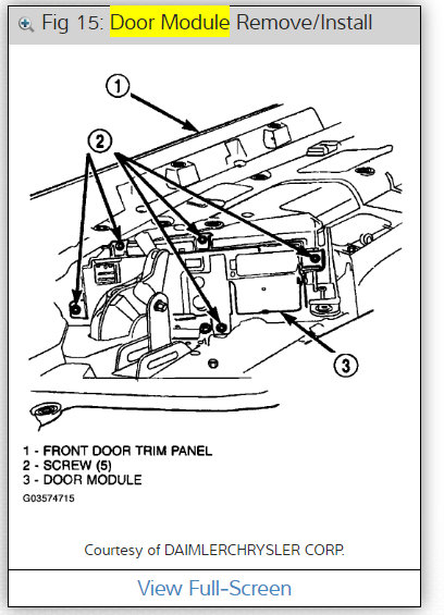

SROW
Started my car leaving the office today. Took me a while to notice my dome lights wouldn't shut off. All the lights were on, and the only way to turn them off was to turn the dial on my headlight arm to the lowest setting before shutoff. This obviously dimmed everything in the car to the minimum.
Shortly after, I realized that my automatic windows and locks were not working, and the lights on these panels were not lit up. I did not check doors beyond the driver side.
My radio was on and working fine. My car started fine. The doors lock and unlock with the fob. I drove to work this morning and did not notice this. Seemed to come out of nowhere.
  • 55,433 POSTS
It sounds like the drivers door module is out which is common. Here are diagrams below to help you fix it. I does not say you will need to have it programmed so it should self initialize. If not it should cost about $130.00 to have it done at a shop. Check out the diagrams (below). Please let us know what happens. Cheers, Ken
SROW
Thank you, Ken!
By module, you mean the entire power switch console? If so, part 5JM60DX9AB is what I found. Would hate to buy this part, for $200.00, only to find it's not the issue. But, I guess that's the name of the game.
  • 55,433 POSTS
Yep, that's why the guys in the dealer have an advantage they install the parts and then put them back if they don't work. Let me know. :)
SROW
The issue has been resolved, by simply replacing the module. I purchased an OEM part for $55.00. Removed the door panel, replaced the unit, put'er back together and everything works just fine.
Only issue is, all but two clips broke. These were likely the original clips. I will replace these in due time. For now, the panel is on there good enough.
Thank you, Ken! You saved me some money!

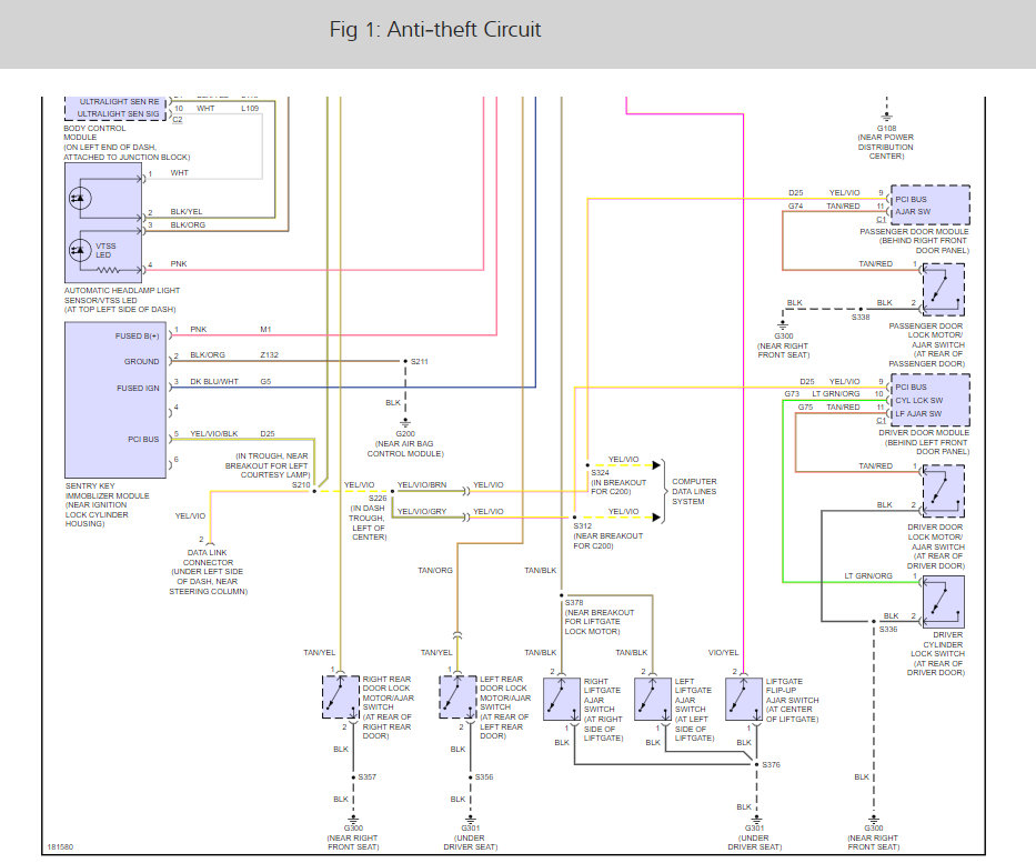

AMOODY
  • 13 POSTS

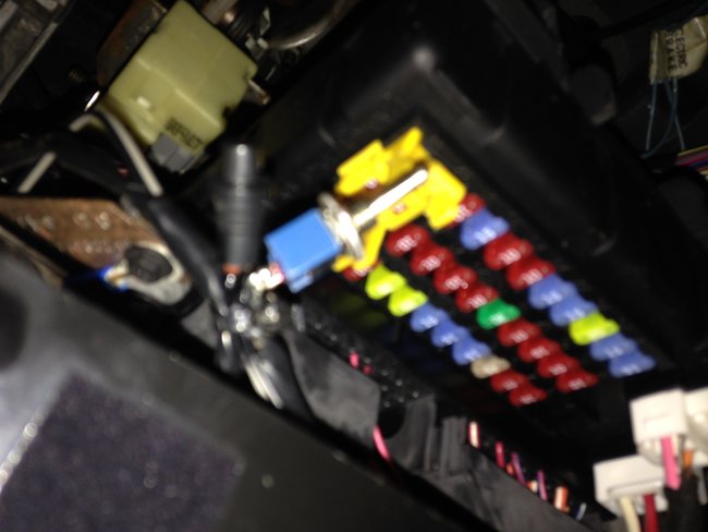

The remote door lock/panic of my vehicle is not working any more. Changed the battery on the remote itself and not working.
Battery of the car went down for a week or so, and I had to use a booster to switch on the ignition. Is something like that, I mean a long period without battery, related to the remote not working any more?
Thank you
  • 55,433 POSTS
When you jumped the car did you connect the jumpers correctly, not backwards? If okay lets check the security system fuses (#22, 28, 7 and 18). Here is a guide to help us get started with the security system wiring diagrams and fuse locations below:
AMOODY
  • 13 POSTS
Checked fuses. All okay. However, found this weird button and switch in the fuse box. What that would be?
  • 55,433 POSTS
Oh boy, this looks like an aftermarket alarm system has been installed which cause all kinds of problems. Can you follow the wiring to see where it goes? Try to find the control box and take a picture so I can see what's going on.

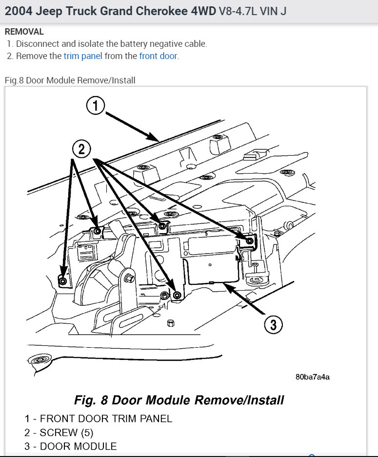

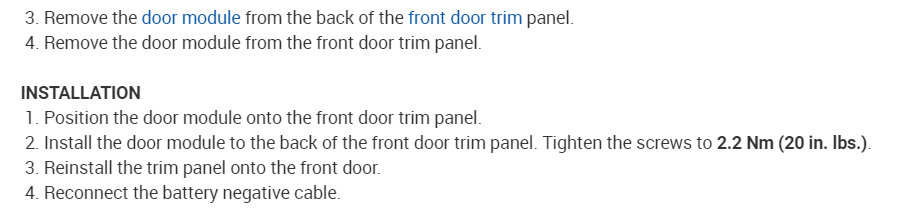

It sounds like the passengers door module is out but to be sure here is the testing process and the door lock and windows so you can see how it works. (below)
TESTING
If the problem being diagnosed is a rear door window that does not operate from the rear door switch, but does operate from the master switch on the driver side front door, (Refer to DIAGNOSIS AND TESTING - POWER WINDOW SWITCH ). If the problem is a passenger side front or rear window that operates from the switch on that door, but does not operate from the master switch on the driver side front door, use a DRB scan tool and the proper Diagnostic Procedures to diagnose the circuitry of both door modules and the PCI data bus. For complete circuit diagrams, refer to the appropriate wiring information. The wiring information includes wiring diagrams, proper wire and connector repair procedures, details of wire harness routing and retention, connector pin-out information and location views for the various wire harness connectors, splices and grounds.
Disconnect and isolate the battery negative cable. Remove the trim panel from the front door, but do not disconnect the door wire harness connectors from the door module. Go to Step 2.
Check the 15-way door wire harness connector for the door module to see that it is fully seated in the door module connector receptacle. If OK, go to Step 3. If not OK, properly connect the 15-way door wire harness connector for the door module to the door module connector receptacle.
Disconnect the 15-way door wire harness connector from the door module connector receptacle. Check for continuity between the ground circuit cavity of the 15-way door wire harness connector for the door module and a good ground. There should be continuity. If OK, go to Step 4. If not OK, repair the open ground circuit to ground as required.
Connect the battery negative cable. Check for battery voltage at the fused B(+) circuit cavity of the 15-way door wire harness connector for the door module. If OK, go to Step 5. If not OK, repair the open fused B(+) circuit to the fuse in the Power Distribution Center (PDC) as required.
If the inoperative window is on a front door, go to Step 6. If the inoperative window is on a rear door go to Step 9 .
Disconnect and isolate the battery negative cable. Disconnect the door wire harness connector from the inoperative power window motor wire harness connector. Check for continuity between the front window driver up circuit cavity of the 15-way door wire harness connector for the door module and a good ground. Repeat the check for the front window driver down circuit. In each case there should be no continuity. If OK, go to Step 7. If not OK, repair the shorted front window driver up or down circuit as required.
Check for continuity between the front window driver up circuit cavities of the 15-way door wire harness connector for the door module and the door wire harness connector for the power window motor. Repeat the check for the front window driver down circuit. In each case there should be continuity. If OK, go to Step 8. If not OK, repair the open front window driver up or down circuit as required.
Reconnect the 15-way door wire harness connector back into the door module connector receptacle. Connect the battery negative cable. Connect the probes of a reversible DC digital voltmeter to the door wire harness connector for the power window motor. Observe the voltmeter while actuating the switch for that window in the up and down directions. There should be battery voltage for as long as the switch is held in both the up and down positions, and no voltage in the neutral position. If OK, (Refer to DIAGNOSIS AND TESTING - WINDOW MOTOR ). If not OK, replace the faulty door module.
Check the rear door power window switch continuity. (Refer to DIAGNOSIS AND TESTING - POWER WINDOW SWITCH ). If OK, go to Step 10. If not OK, replace the faulty rear door power window switch.
Disconnect and isolate the battery negative cable. Reconnect the door wire harness connector to the rear door power window switch. Disconnect the door wire harness connector from the inoperative power window motor wire harness connector. Check for continuity between the rear window driver up circuit cavity of the 15-way door wire harness connector for the door module and a good ground. Repeat the check for the rear window driver down circuit. In each case there should be no continuity. If OK, go to Step 11. If not OK, repair the shorted rear window driver up or down circuit as required.
Check for continuity between the rear window driver up circuit cavities of the 15-way door wire harness connector for the door module and the power window motor wire harness connector. Repeat the check for the rear window driver down circuit. In each case there should be continuity. If OK, go to Step 12. If not OK, repair the open rear window driver up or down circuit as required.
NOTE: The door module feeds battery current to both terminals of the rear door power window motors when the power window lockout switch is in the Unlock position, until the master window switch on the driver side front door is actuated. The door module feeds ground to both terminals of the rear door power window motor when the power window lockout switch is in the Lock position, until the master window switch on the driver side front door is actuated.
Reconnect the 15-way door wire harness connector for the door module to the door module connector receptacle. Connect the battery negative cable. Check for battery voltage at each cavity in the door wire harness connector for the power window motor. Each cavity should have battery voltage when the power window switch is in the neutral position. Each cavity should also have battery voltage in one other switch position, either up or down, and zero volts with the switch in the opposite position. If OK, (Refer to DIAGNOSIS AND TESTING - WINDOW MOTOR ). If not OK, replace the faulty door module.

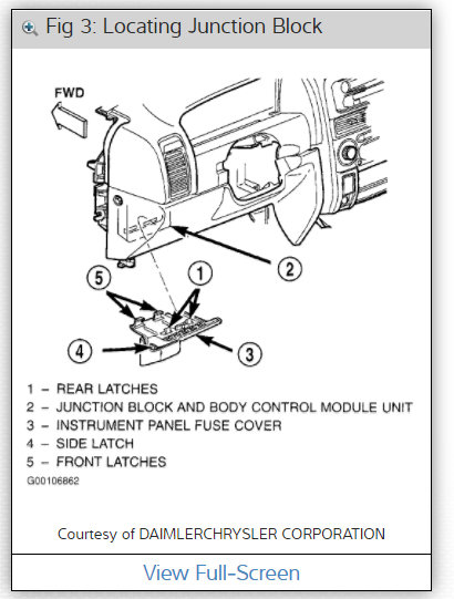

Hi Sherry,
This sounds like the BCM has gone out and needs to be replaced. Here is the location of the unit you will need to have it programmed by a shop for about $130.00 bucks.

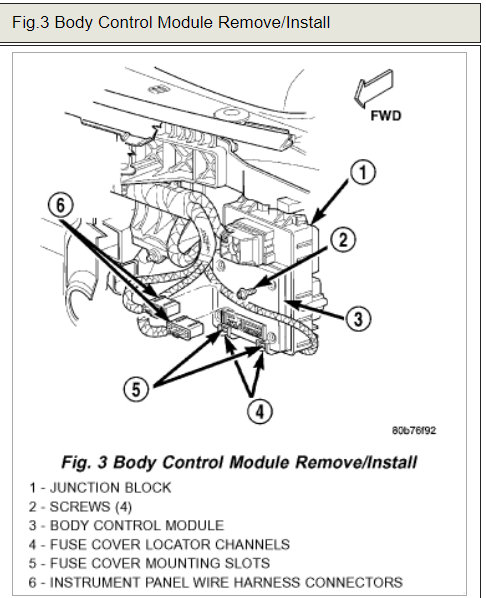

BIG_DADDY656
I have a 2004 Jeep Grand Cherokee. All of a sudden, the automatic door locks quit working except for the drivers door. At the same time, the passenger windows would no longer work and both of the keyless entry key-fobs also quit working.
Has anyone got any information regarding these problems? Is it possible that these issues are related and if so how?
I really need to get this fixed since this is my daughter's vehicle and the only way to lock the rear lift gate is with the automatic locks. She is leaving to go back to school very soon.
Thanks.
Aug 29, 2020 at 5:38 AM (Merged)
  • 110,244 POSTS
Check for bad grounds. Check the body control module.

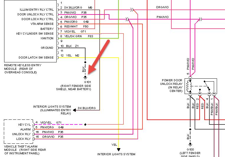

I have a 2004 Jeep Grand Cherokee. Trying to find out if my problem had been on recall. The issue is that I have had the following repaired twice and now it has occurred for the third time. The remote does not lock the car. When I try to lock it the inside lights remain on and the doors do not lock. All the buttons on the driver door do not work. I have to insert the key in the driver door to lock the door. However, the remote will lock the back ddors. The alarm light as well as the alarm will not activate. Windows can not be rolled up or down.
CARADIODOC
  • 34,381 POSTS
Pull the rubber boot back and check for broken or frayed wires between the driver's door hinges. The wires typically break very near the door or the "A" pillar. The harness can be unbolted to make repairs easier.

SASSAFRAS

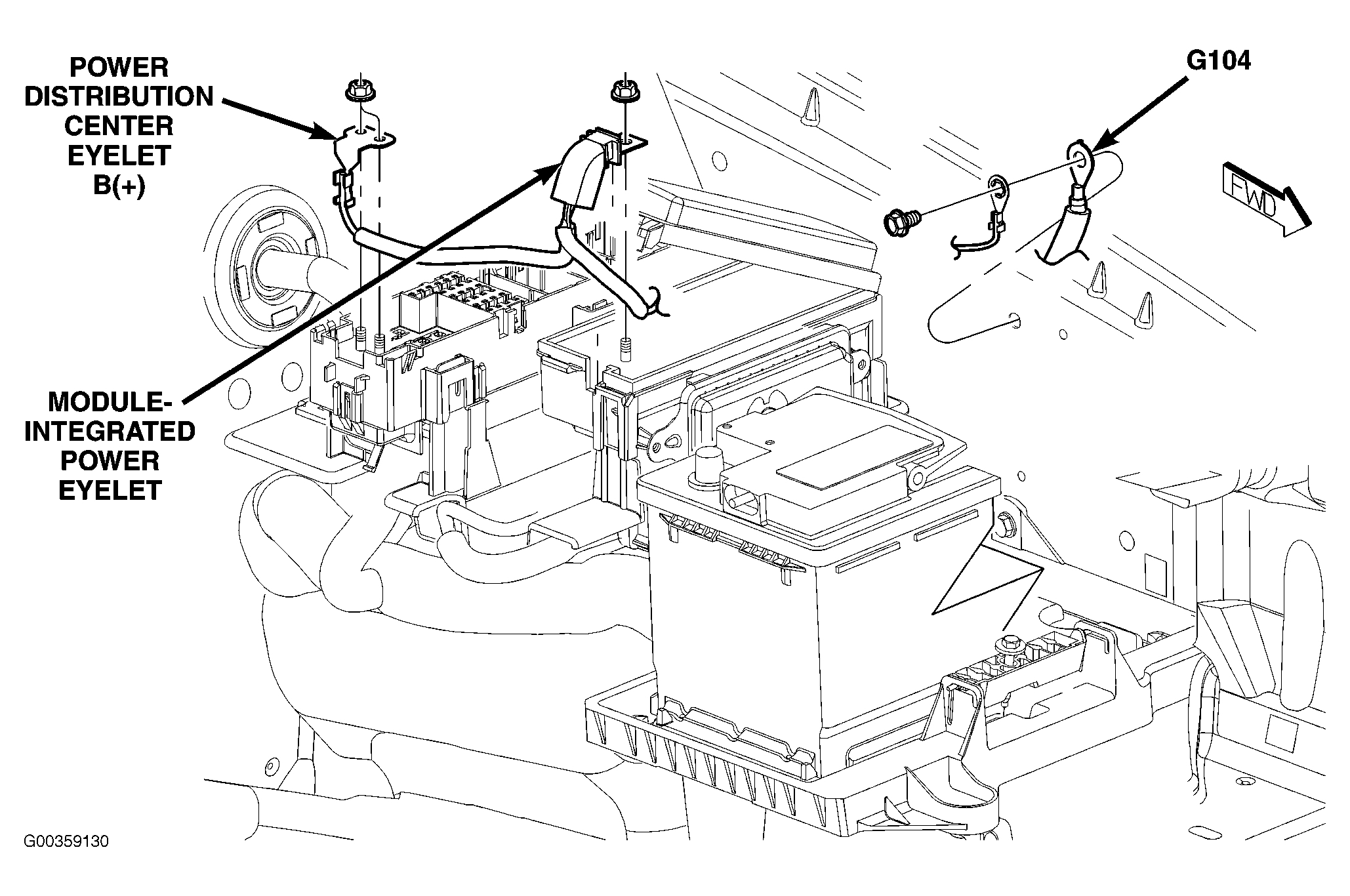

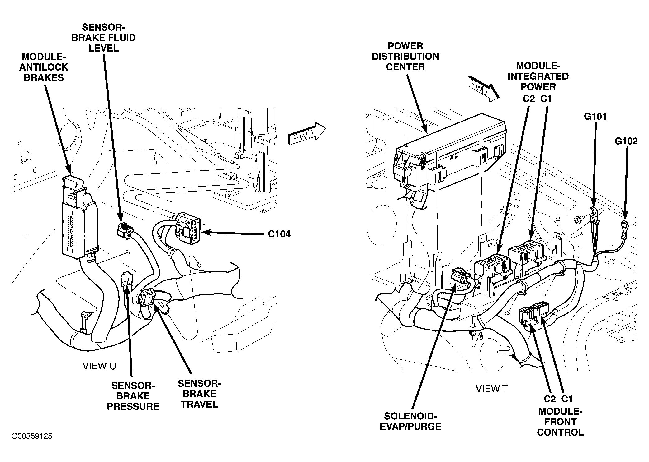

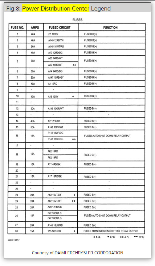

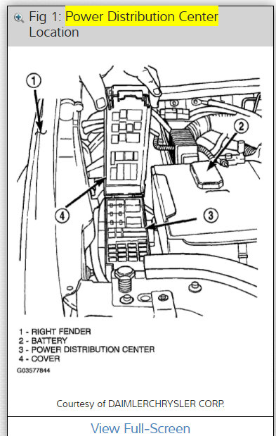

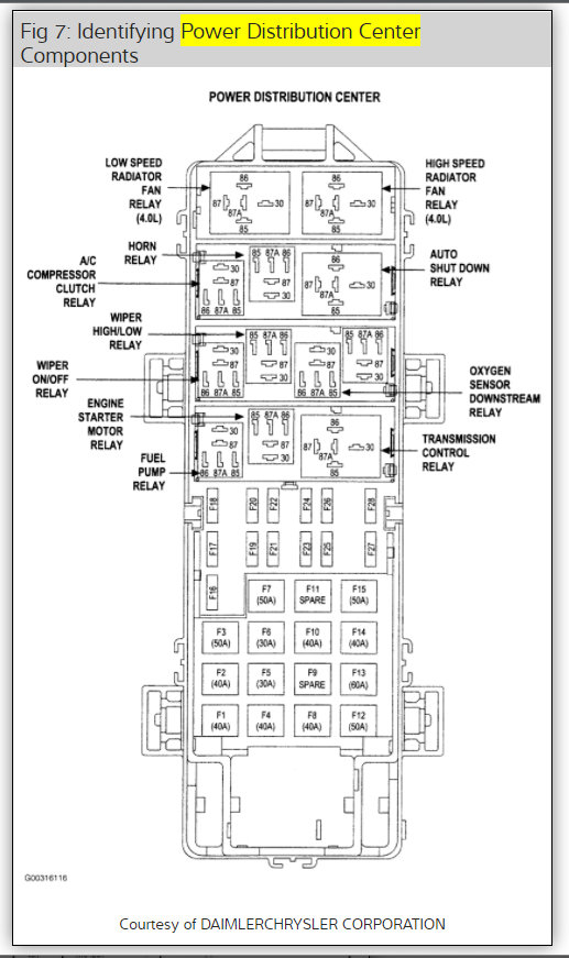

I hit a large deep hole in the snow over this winter on the right side of my jeep, and now my power door locks door chimes entry lights (above or below) and radio quit working I took the right side of the dash apart, and didn't see any visible problems where do I go From here? On a fixed D A V income so any help would be greatly appreciated
HMAC300
  • 48,601 POSTS
check things in pic and fuses maybe the fuse block has loose wires on rh side. also check ground for doors then have scanned may be the remote module.
