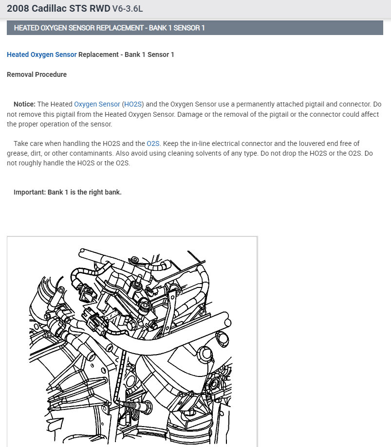

Need to change front Passenger side upstream OS Sensor, please send instructions with illustrations...
Thanks you guys are the best!
Apr 23, 2022 at 2:29 AM
SQM
  • 6,383 POSTS

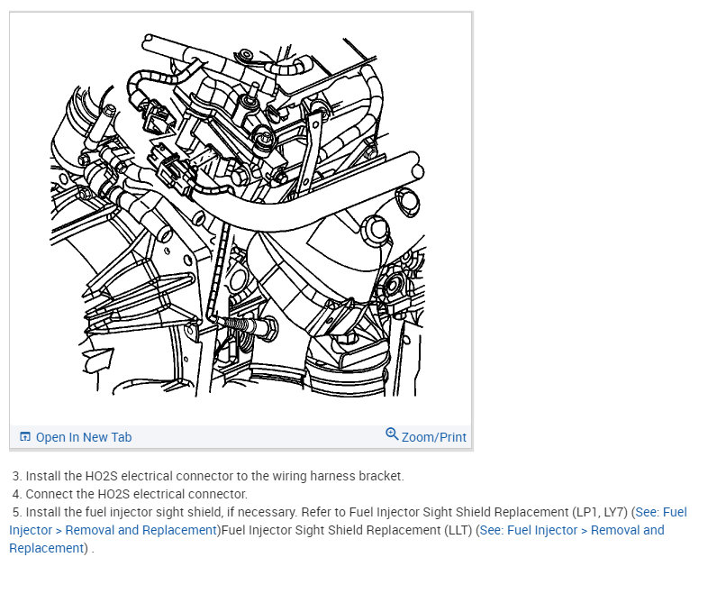

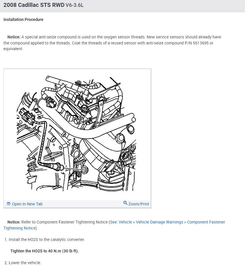

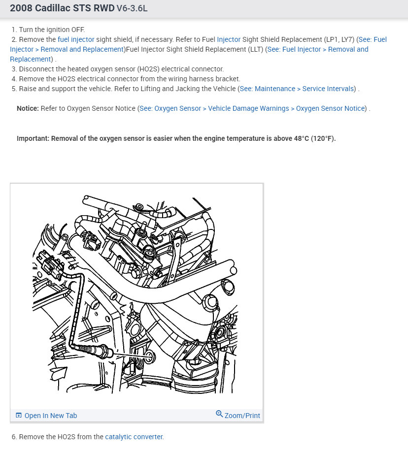

Please see attached for the replacement procedure for the upstream oxygen sensor.
Let me know of any questions.
https://www.2carpros.com/articles/how-to-replace-an-oxygen-sensor
