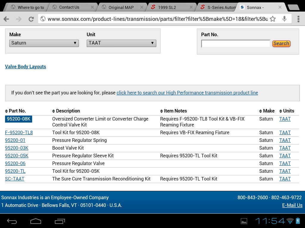

Cool. What's the tool that I need to search for on Amazon?
Jun 7, 2013 at 10:39 AM
SATURNTECH9
  • 30,869 POSTS
The OTC 5610 is the transmission pressure tester I have.The sonnax sure cure kit is the one I use to rebuild those valve bodies.Its a complete kit new regulator sleeve pressure regulator boost valve and and dampner spring.I have one in my 1999 Saturn sl2 its a great upgrade shifts better than the car shifted new.I should know I have driven tons of them brand new.The only problem is it takes a special tool kit made by sonnax to bore the upper valve pressure regulator to put in the sleeve.The tool kit isn't cheap to just do your valve body it isn't worth buying the kit.
