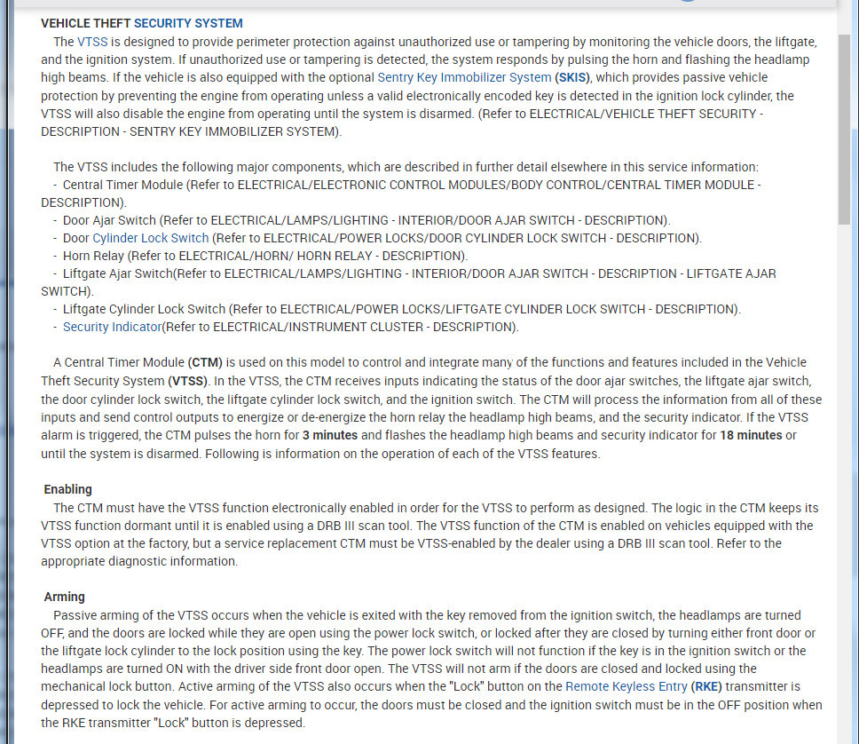

Also, there was an option in 2003 to order the vehicle without the SKIM system. If your vehicle was ordered without this system then the issue is the same but the only difference is it was not deleted. It was just never built with it. However, they still sent you a PCM with the system active for it. Below is some more info on this.
Let me know if you have questions. Thanks
