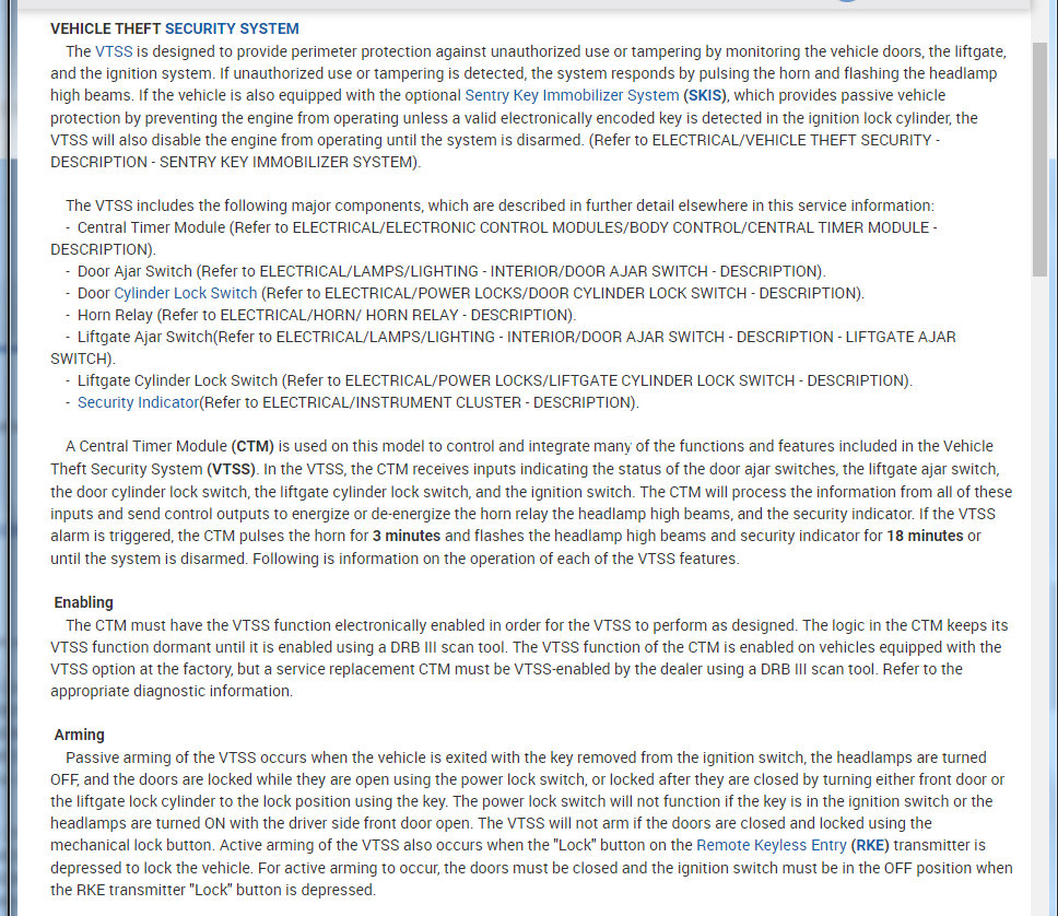

Just to clarify, all you have is this immobilizer code but it starts and runs fine?
If that is the case, more then likely someone deleted the system because this vehicle should have come with what is called a SKIM key system from the factory. Basically that is where the key gives a code to the module and then if it matches it sends a code to the PCM and if they match as well then the PCM starts the vehicle.
If you installed a different PCM and now have this code, I suspect you installed a PCM that is looking for the system but the rest of the system is deleted already. So if the vehicle is starting, then it is up to you if you have it repaired as the vehicle is operating.
However, if it were me, I would ask then company send you the replacement PCM and then you can return the other so that you are not without your vehicle. They can simply charge you for the core if you don't return it but having it go the other way doesn't make sense if your vehicle is starting and running.
Also, there was an option in 2003 to order the vehicle without the SKIM system. If your vehicle was ordered without this system then the issue is the same but the only difference is it was not deleted. It was just never built with it. However, they still sent you a PCM with the system active for it. Below is some more info on this.
Let me know if you have questions. Thanks
