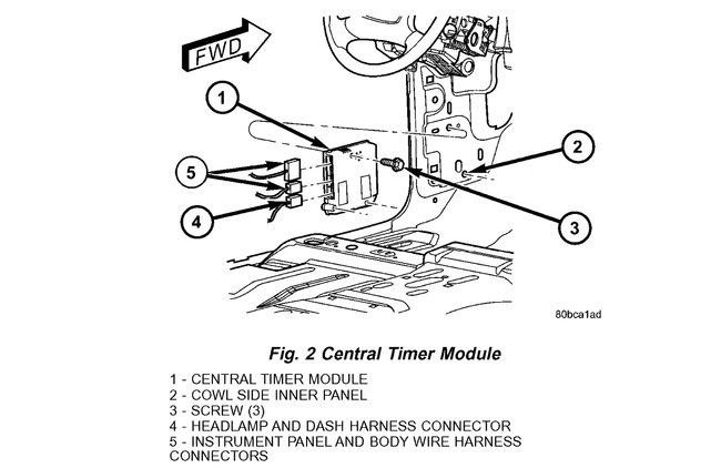

none of my interior lights work or my headlights,door locks,alarm system, intermittent windshield wipers. my question is where is the central timer module located on my Dodge Durango and how do i replace it?

The Central Timer Module is located behind the left side kick panel. It contains 26-way, 16-way and 12 way connectors. Before you change it, scan for "B" and "U" codes, most shops have scan tools that can read "B" codes, but the "U" codes may need the Chrysler scan tool.
Here is a diagram showing the location. Check out the diagrams (Below). Please let us know if you need anything else to get the problem fixed.
