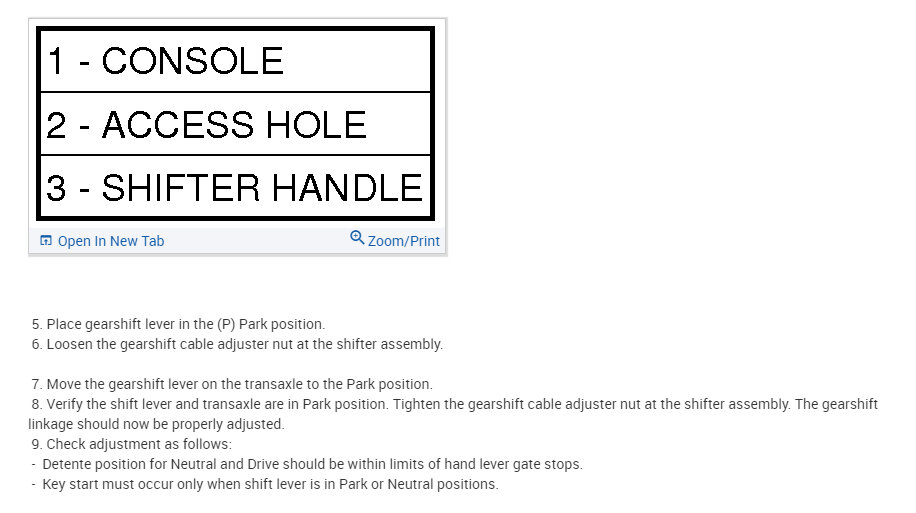

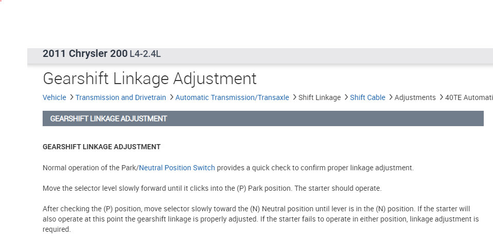

Absolutely, I think you are right. If it is showing reverse, it won't start. The idea that the brake is hard to push is normal because the engine hasn't been running. The power brake assist is done via an engine vacuum. If the engine isn't running, the pedal will become hard to push.
Since it isn't coming out of gear (park) and the brake pedal is hard to press, make sure you are pressing the brake far enough to turn the brake lamps on. The shift interlock is actuated by the brake lamp switch.

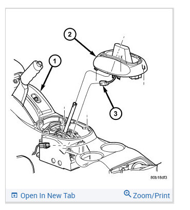

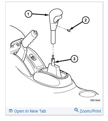

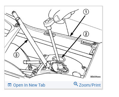

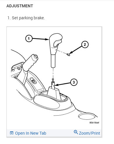

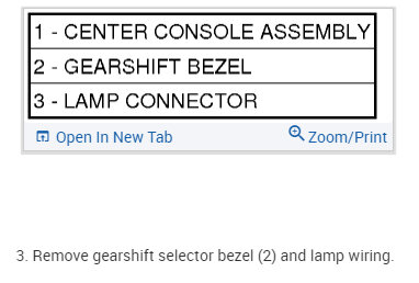

I attached the directions for adjusting the linkage below.

Hi, I went back tonight and thankfully the law had not towed the car. The info you gave me was great, I really appreciate it. My 200 doesn't have an obvious button to release the gear shift so I looked up a YouTube video and found that I had to pop the whole plastic piece off and then find the lever thing and push it to release the shifter and it worked!! I was so worried I would have to have it towed and then pay so much to have it fixed. I know I still have a semi loose linkage which I will look into fixing shortly but for now I'm on the road and I owe a lot of it to you for making it make sense and leading me in the right direction. Thank you so, so, much because I know next to nothing about cars but now I feel like I could be a mechanic!! I hope you had a great Christmas as well!
