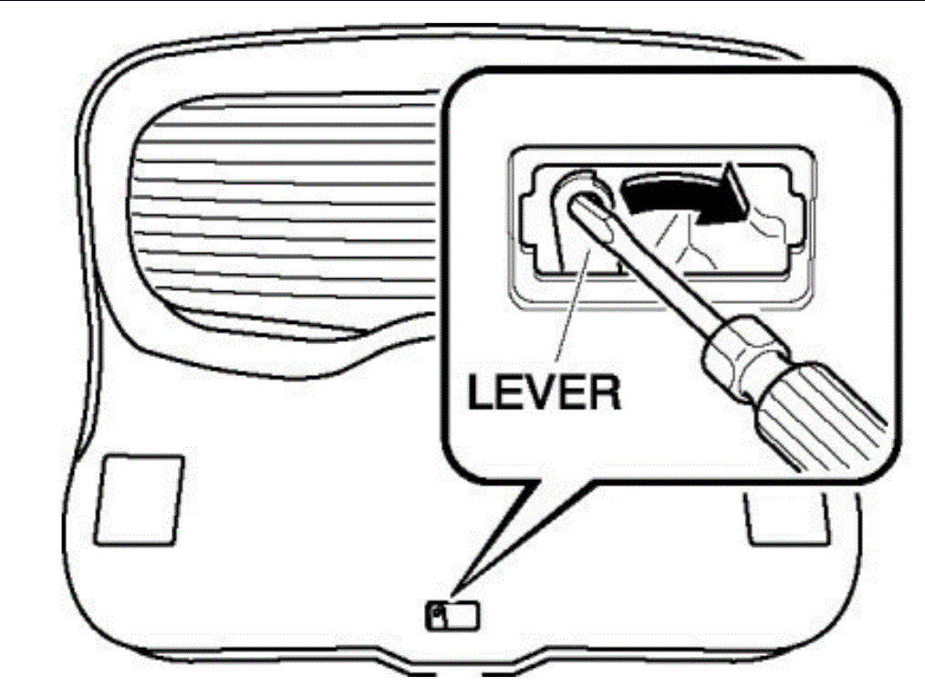

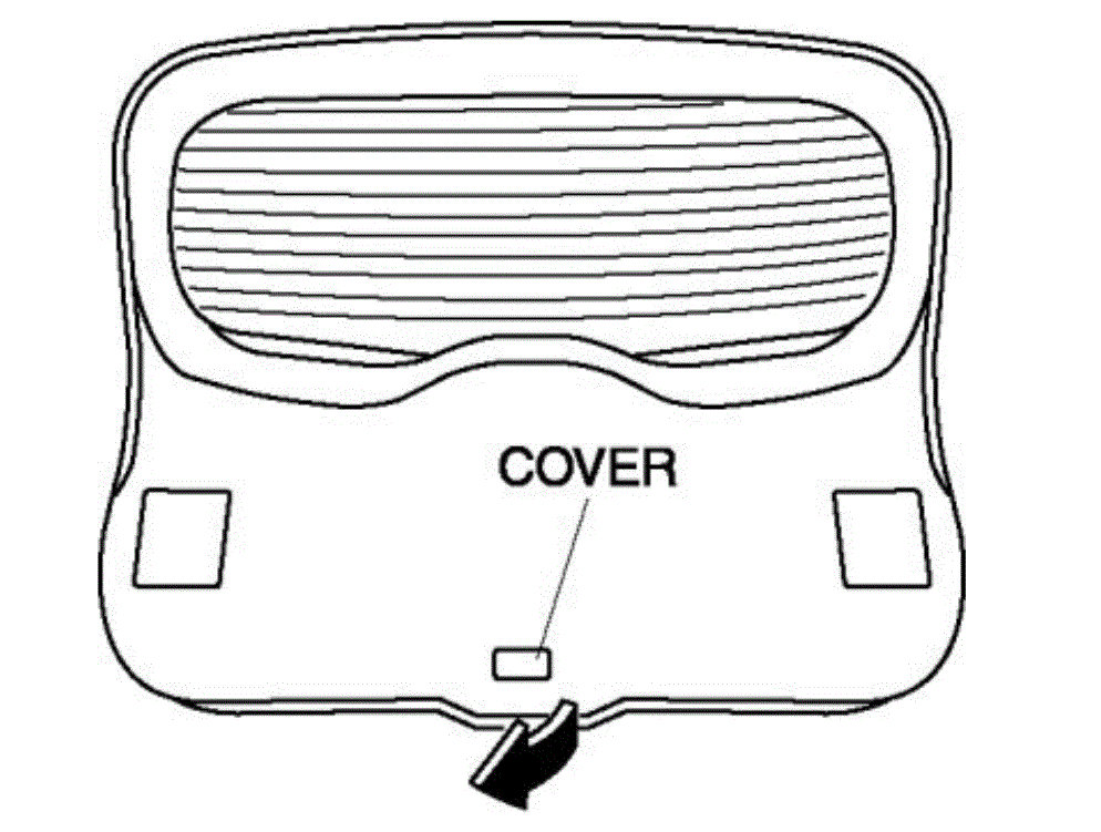

The rear outside hatch mechanism to my vehicle listed above is broken. Hatch is closed but won't open. Can you show me where the safety release on the inside of the hatch is located?

Here are the directions for the manual release. The attached pics correlate with the directions.

1. Remove the cover.
pic 1
CAUTION:
- Wear gloves when performing the procedure. The body edge can injure bare hands.
2. Move the liftgate latch release lever shown in the figure to the right to unlock the liftgate.
pic 2
