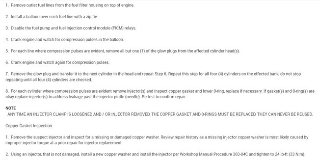

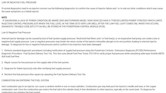

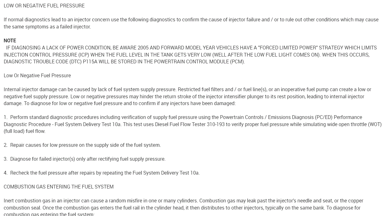

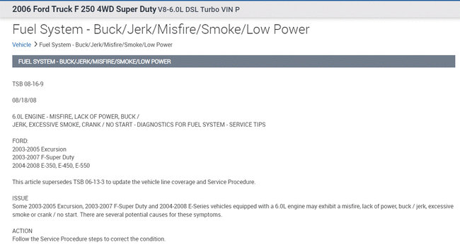

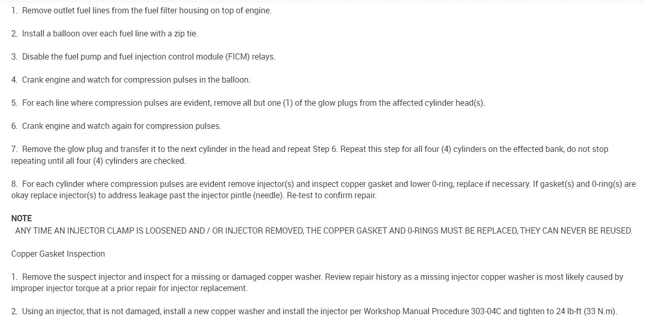

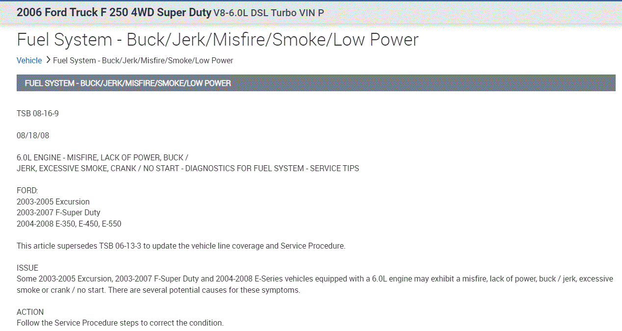

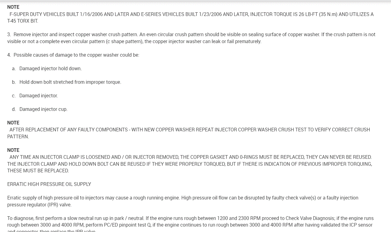

What you described sounds like it could be related to fuel pressure or exhaust gas getting into the fuel system.

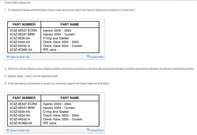

Do me a favor. Take a look through the technical service bulletin below and let me know if you are comfortable performing the tests. This TSB is related to a few different issues, but no start is included.
Also, let me know what codes you are getting. Maybe I'll be able to find a correlation between them leading to the fault.

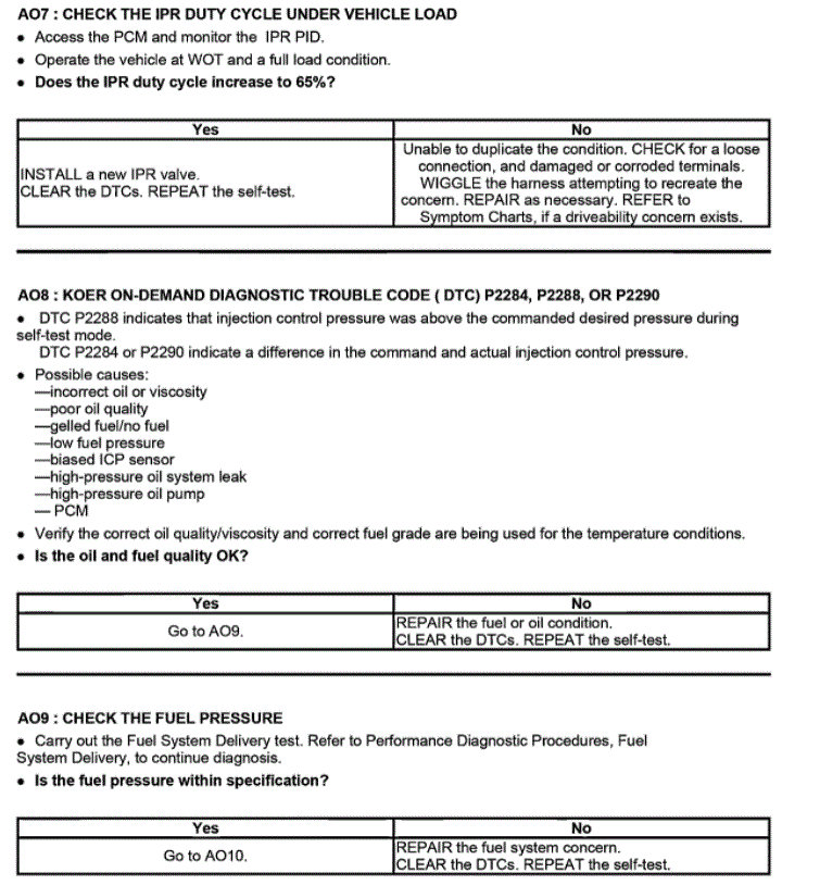

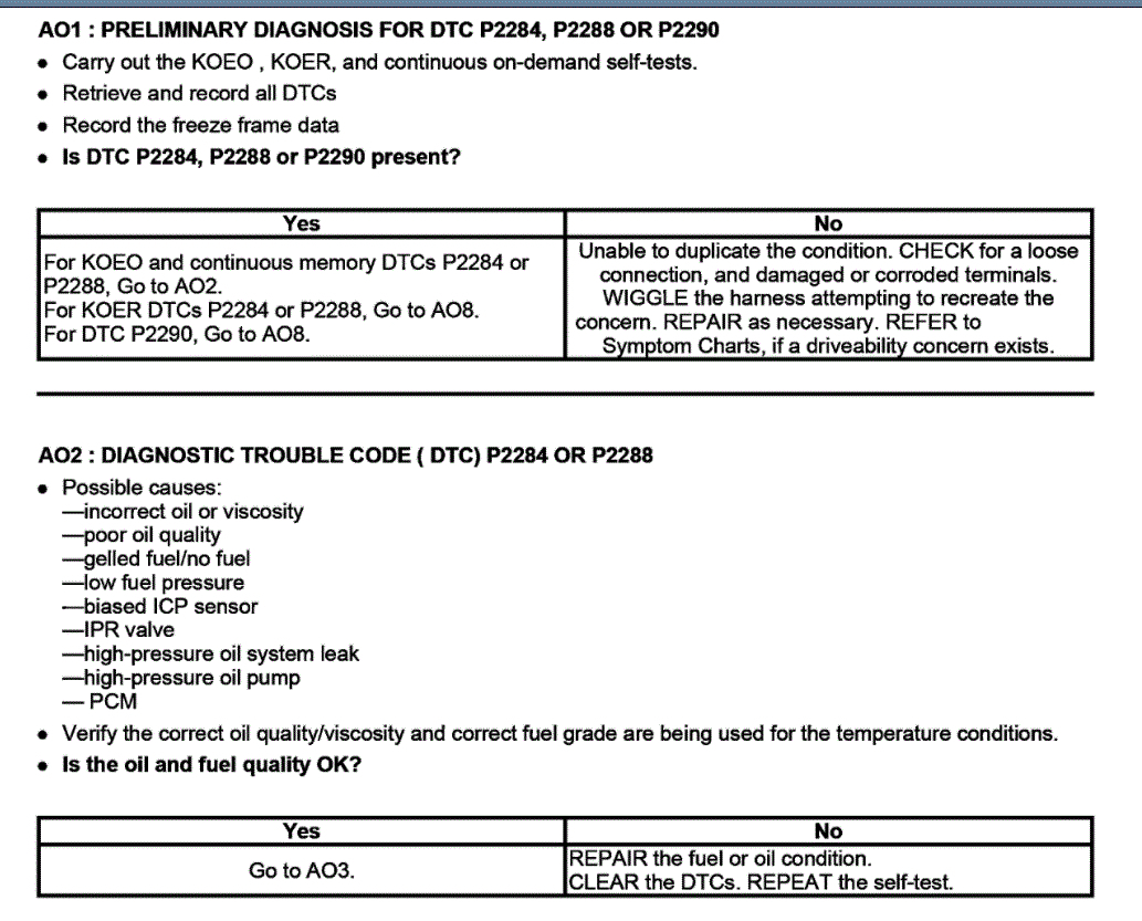

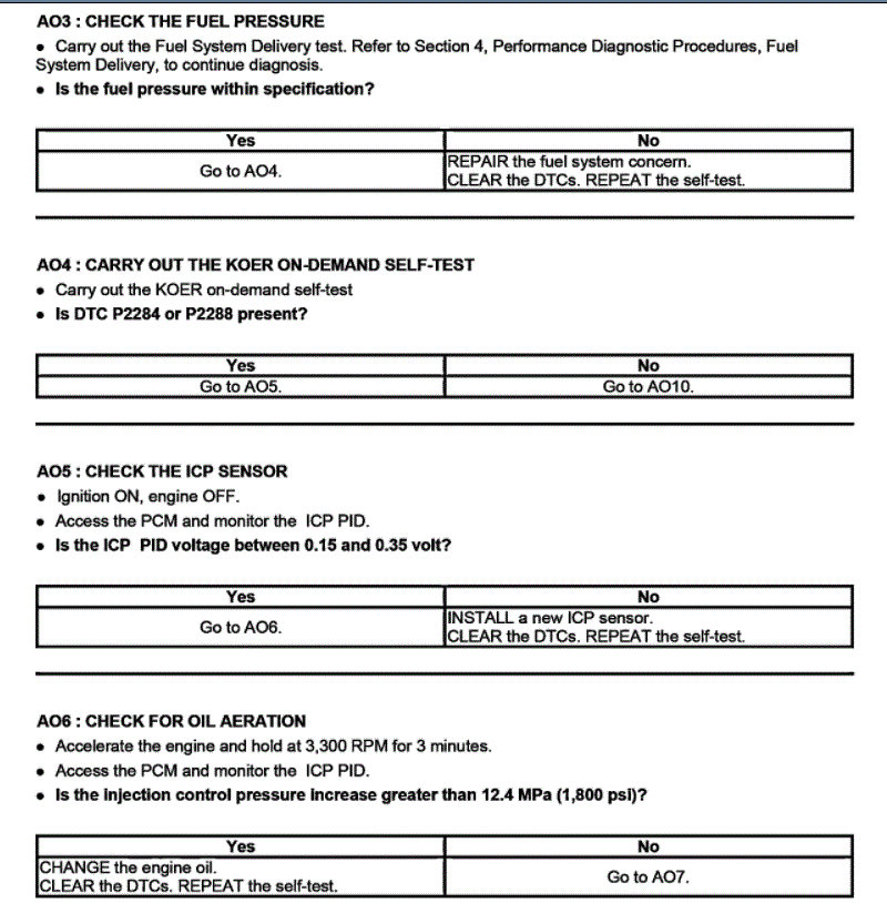

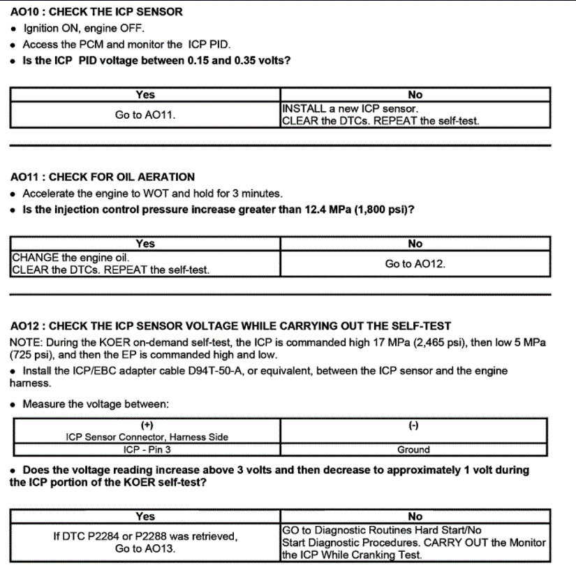

Okay, here we go.
The p0700 is a generic transmission (non-specific). Basically, it indicates the transmission control module has recognized a fault and the diagnostic trouble code is stored in the powertrain control module.
The P0284 is related to the fuel level sensor

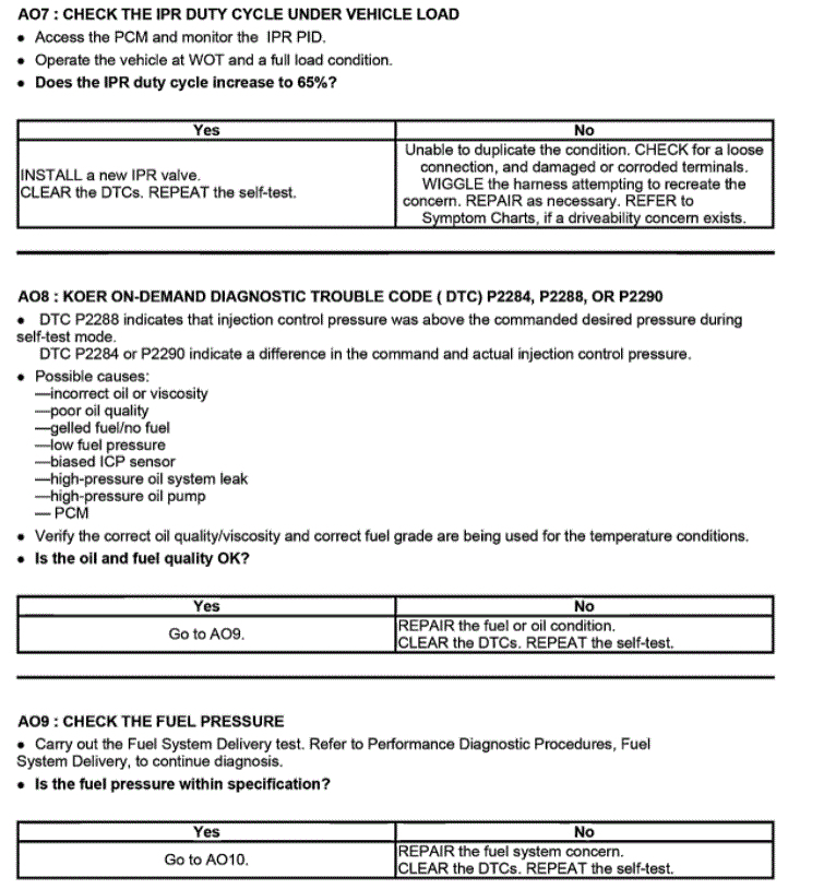

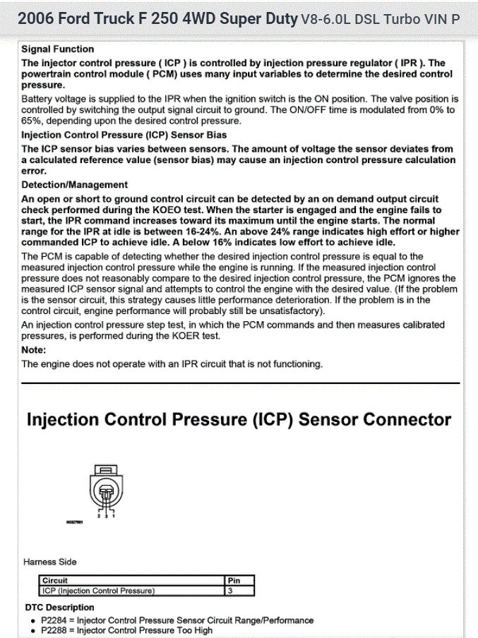

P2284 is related to the Injector control pressure sensor which can be causing issues with the IPR.

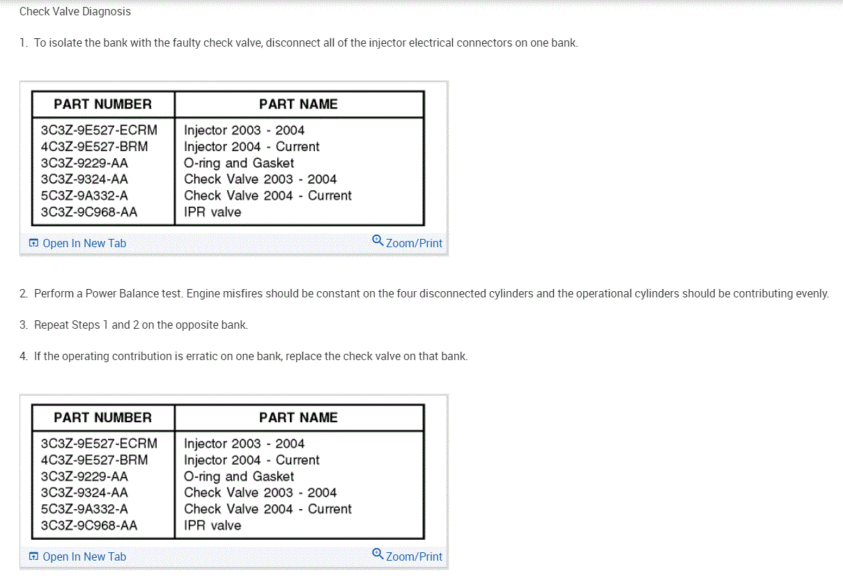

The P0284 is a contribution balance issue with cylinder 8. This shouldn't cause the IPR to fail but may cause drivability issues.

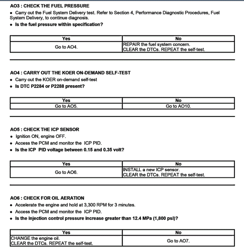

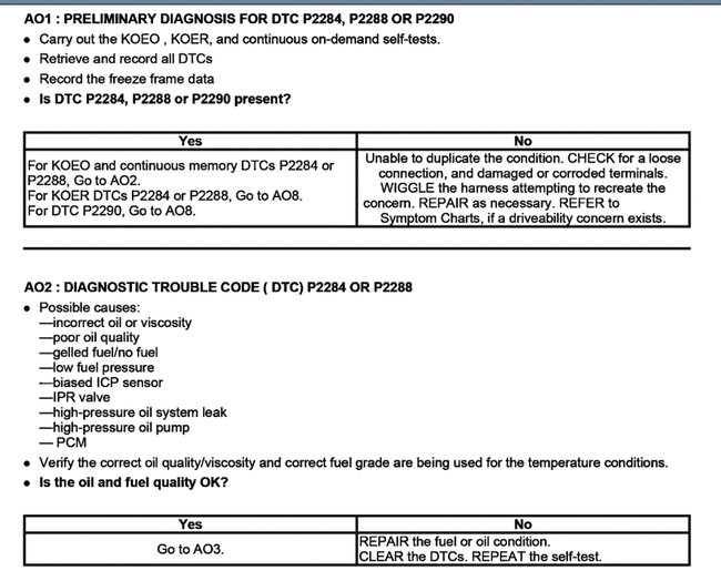

If I had this vehicle in my shop, I would start with injector control pressure sensor testing. Although the sensor is controlled by the IPR, I suspect it may be the cause of the IPR failure and the issues with the contribution balance.

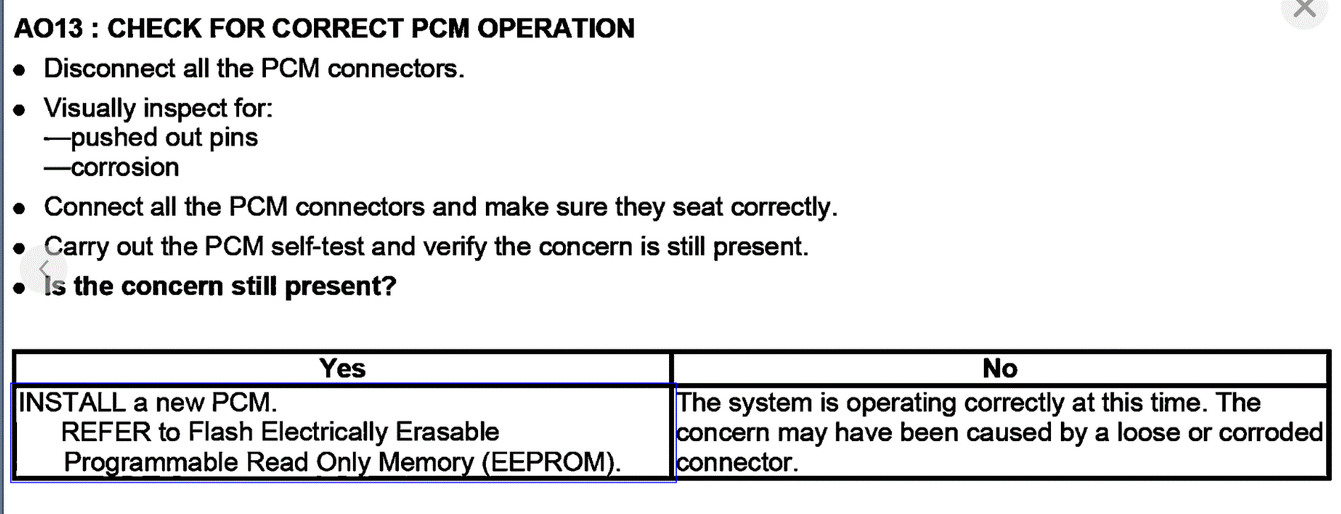

I attached diagnostics below. Take a look through them and let me know if you are comfortable performing them.
I will watch for your reply.
