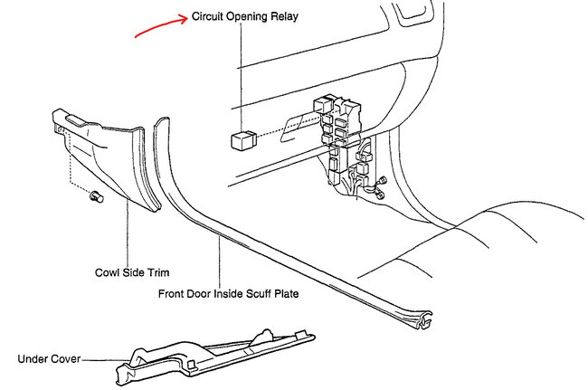

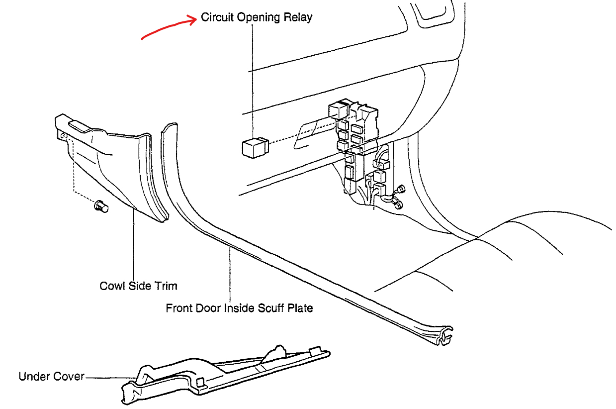

The car starts and runs for about 1 maybe 2 seconds tops, then shuts off. Cannot hear fuel pump kick on.
Feb 15, 2024 at 12:10 PM
Experienced Mechanic
55,647 POSTS
The circuit open relay is behind the glovebox. Here is a guide to help you test the relay and the location in the images below:
Check out the images (below). Let us know if you need anything else.
