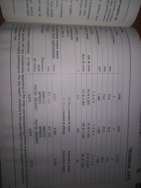

I am a diesel mechanic and can't seem to get my head folded around the problem I am having. so I am asking fellow mechanics to help me diagnose the problem as I know these engines quite well, the problem is the engine has a run-on ("dieseling") problem after running hot or even cold. what I find strange is that this phenomenon happens very seldom but it happens and it bothers me, is that is when this happens, the engine diesels in the wrong darn direction, it diesels in counter rotation! so the engine have never been opened nor overheated in any way... does not consume oil...does not consume water neither does it have a drinking problem to the consumption related to the performance and the economy nor does it have power related problems, no smell of fuel before or after running, after this happens the restart procedure takes a few seconds to restart. So please I need Help urgently! If there is anything I have missed to mention please feel free to ask me for more technicalities and information regarding the engine specifications. Engine code is C14SE.

I have replaced all the old type injectors with the newer (plastic type) injectors and they are not showing any signs of leakage of any kind, no drops forming or pressure drop in the system, the spark plugs are the ones that the factory booklet prefers me to use (NGK BPR6ES or Champion RN9YCC) type plugs with is what is currently installed in the vehicle, as far as the EVAP valve concerns, it does not have one installed as the vehicle has no Lambda sensor installed in the exhaust system nor does it have a EVAP valve installed.
if you long any other information regarding my problem please feel free to ask, this is the C14NE engine as it has a 8 valve configuration and is really simple. All that I can really think that is being overlooked is either a leaking valve or a coil pack that stays energized when the ignition is being turned off in the key out position.
