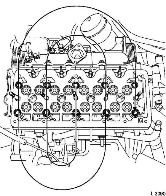

I have a 1.7 diesel Opel corsa bakkie 2001 model. I lik to know the torque settings on the head bolts and how to go about doing it.

Start at the middle and then work your way out in a circle. Start by tightening them down to 25 foot pounds. The go to 47 and then finish at 75 and you are all set.
Here is a diagram (BELOW) to sow you how to do it.
