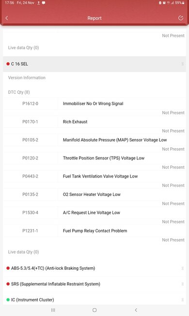

Before disassembly, I scanned for codes, and they are attached. Now the scan tools classify all of them as "not present" at the moment when I scanned for them, so I take that to mean that they occurred in the past but were not present, I stand corrected though.

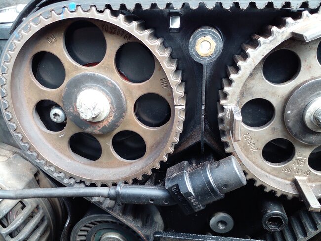

The primary reason for the Knocking was not engine bearing related (I stripped and checked) but I think it was caused by one of the broken teeth on the exhaust cam sprocket which is used by the cam sensor. Which, I think, caused the ECU to advance the timing a lot thus causing the Knock.

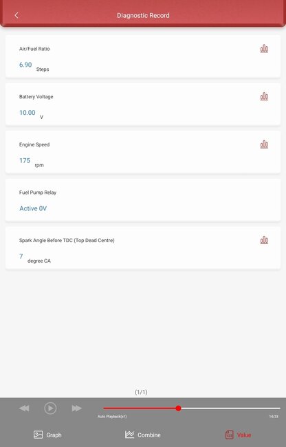

The valves have hydraulic cam followers so that is not a biggie. So, we have timing or ECU problems to worry about. Concerning the timing, please look at the live data I got when KOEOff. The RPMs say it is 50 RPMs while the engine was not being cranked.

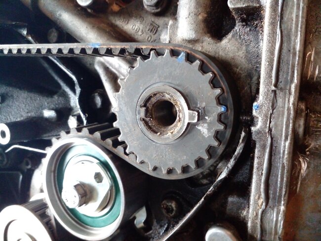

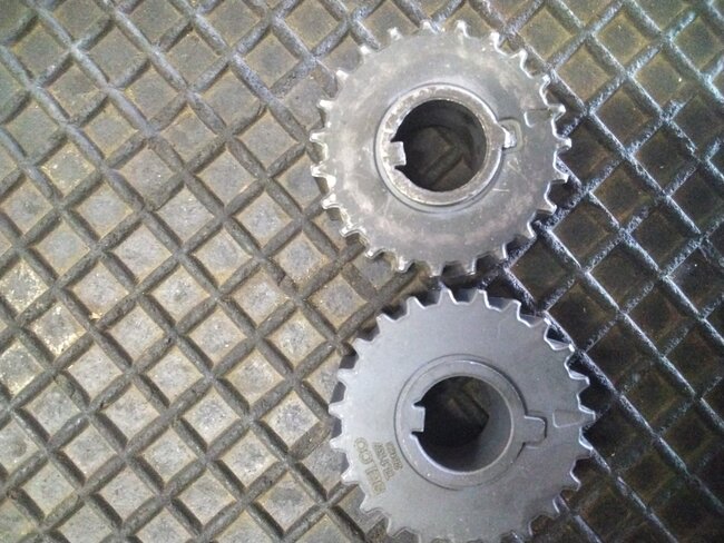

I will add that the crank pulley keyway way got damaged, and I machined the slot afresh. The bottom mark on the timing plastic cover lies in between tooth number 8 and 9 counting from the missing teeth on the pulley is that fine? Besides that, I do not doubt my timing.
When it was cranked, it got as high as 173 RPMs, obviously caused by the sluggish rotation of the starter thus not fast enough to run the engine. I put a good battery that easily started a diesel truck for the first time into the Opel, no success... only a few quick rotations followed by many slow hard turns as if the engine is seizing. If you remove the power to the coil (meaning the spark is cut), the engine turns rapidly with no hiccups...

The two things that stick out to me is low battery voltage which if the voltage drops to low while cranking the system will not work which is probably why you have the low voltage codes, also I noticed the immobilizer has a code so do you have the correct key for it? If so, you will need it reprogrammed to clear the system. After you get a new battery, please take a short video with your phone of the engine cranking over, from this I can tell if the engine is in good condition i.e., timing belt alignment, good compression. After the new battery installation clear the codes. I know you say you have good battery but at 10 volts, which is no good. Let's clear the codes and try again. Let's start with these guides to help:

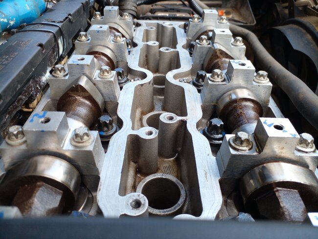

I did go through the links you sent, and I can say that they are quite extensive. I have attached pictures to help me get the help I need.
I have attached the valve timing picture.
I have attached the picture of the cams also.
I have attached the crank timing picture also.
Please comment.

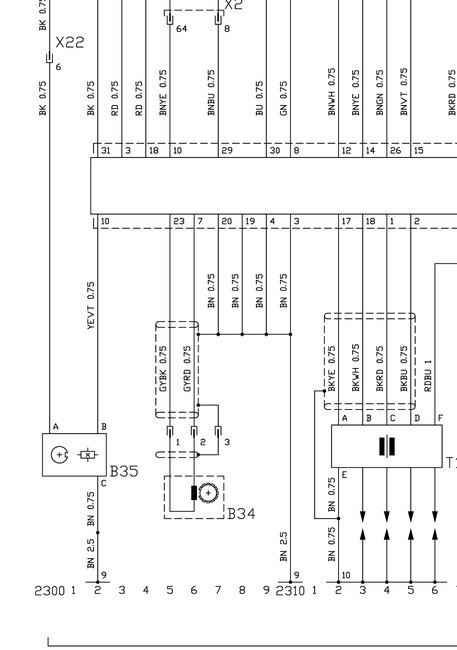

I got this schematic for a x16xel engine astra g of which its layout is similar to a C16SEL wiring schematic that shows a Crank sensor wiring layout. It shows that the computer must give me a 5v reference and a 12v supply.

Yes, the coil should have 12 volts when the key is on along with the 5-volt references. I don't think you have a security issue either since the light is not flashing. Also, can you upload a video of the engine cranking over or do a compression test? Have you run the codes to see if any are stored?

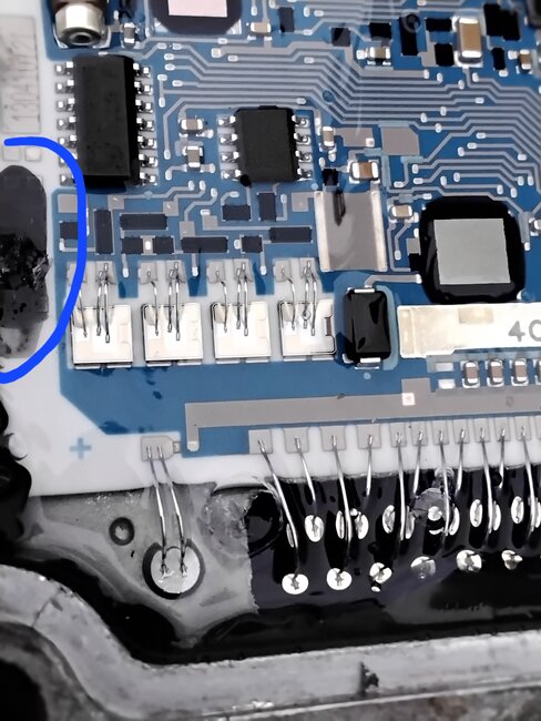

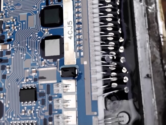

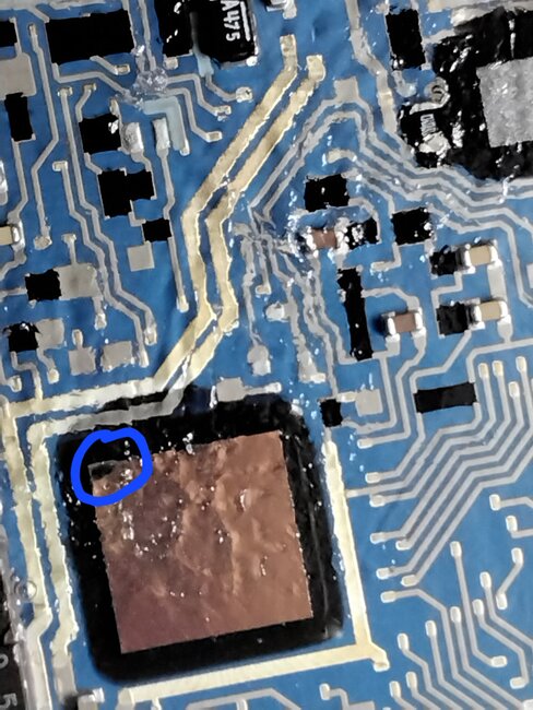

SIZWE AMOS
  • 24 POSTS
Hi Ken,
The ECU is damaged... the pictures are not that great but clear enough to see, I think.
What are those colorful squares called, processors right?
Awaiting your response.
Sizwe
Nov 28, 2023 at 12:56 PM
  • 55,224 POSTS
Yep, those are burn marks, you can get a preprogrammed unit by searching Google or Ebay. Thanks for the images and video. Please let me know how it goes after you get a replacement.
