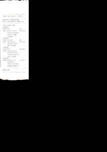

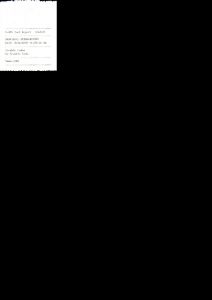

PHILLIPWATT
  • 7 POSTS
The guy in the garage got the error code P1113, which he cleared but on turning the engine on, it came back but with more codes (see attached print of the error reports). After a bit of tinkering, he eventually cleared these and suggested that I see if they come back. I am not really sure I understood correctly (he is Spanish and I am still learning) but I think he was suggesting they may be old codes that were never cleared. Anyway, so far they have not come back after a 60km drive. I suppose we shall have to wait and see. Any thoughts? Many thanks Phil

I guess you probably can´t read these attachments.
The codes are:
P1113-001
P1116-002
P1112-002
P0443

DAVE H
  • 13,384 POSTS
I think your technician is doing the smart thing and waiting to see if the codes re-appear .. the code PO113 I have no definition for and is probably related to po112 ECT sensor ..the MAF code and the po443 are probably related to each other (ie.) one may have caused the other and could have been set by simply not tightening the petrol cap correctly !!...let us see if they do come back ? also could you let me know if you still have the clicking noise behind the glove box ??
P0443 Evaporative Emission Control System Purge Control Valve Circuit Malfunction
For Continuous Memory Only DTC P0443: Inspect EVAP Canister Purge Valve Circuit For Intermittent Failure
DTC P0443 is set when EVAP Monitor test fails due to EVAP canister purge valve circuit signal reading outside minimum or maximum allowable calibrated parameters for a specified duty cycle PCM detects. Possible causes are:
VPWR Circuit Open
EVAP Canister Purge Valve Circuit Open, Or Shorted To GND Or VPWR
Faulty EVAP Canister Purge Valve
Faulty PCM
Repeat KOEO ON-DEMAND SELF-TEST and KOER ON-DEMAND SELF-TEST . If DTC P0443 is present in KOEO or KOER ON-DEMAND self-test, go to next step. If DTC P0443 is present in Continuous Memory only, check for intermittent faults. Go to TEST Z, step 1). If no faults are indicated, replace PCM.
P1112 Engine Coolant Temperature Radiator Outlet Sensor High Input
P1116 Mass Or Volume Air Flow Circuit Range/Performance Problem (Bank 2)
