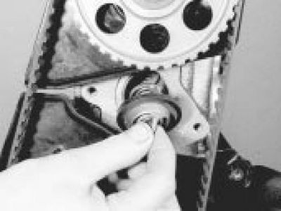

LOCATION OF THERMOSTAT
Jun 12, 2008 at 9:11 AM
MOMIAUT
the thermostat is behind the "Timebelt cover " and for replace or installation of it you must open all part of timing system such as cover,timebelt,gear and then you open the thermostat cover

[quote:20ab2548d9="burkeray"]Engine Cooling problem
1994 Opel Astra 4 cyl Front Wheel Drive Manual 118000 miles
LOCATION OF THERMOSTAT[/quote:20ab2548d9]
Behind the timing belt cover ...if you will follow the upper radiator (input) hose
