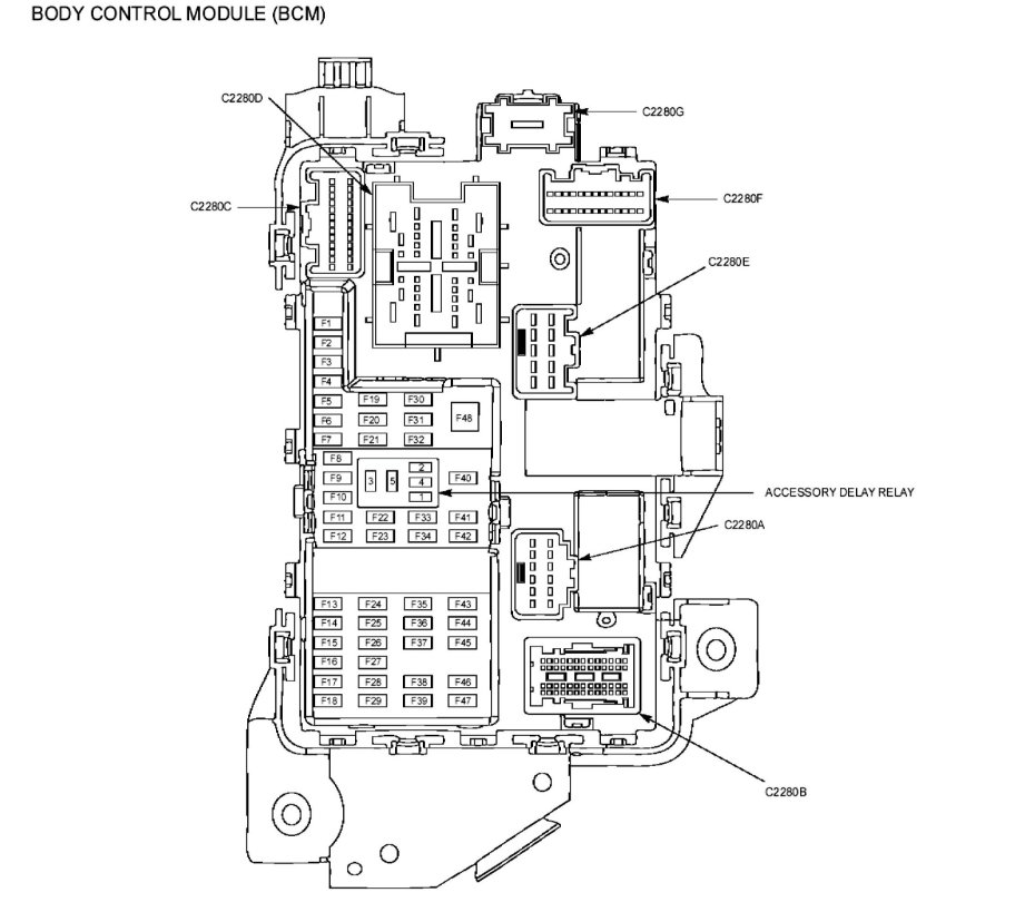

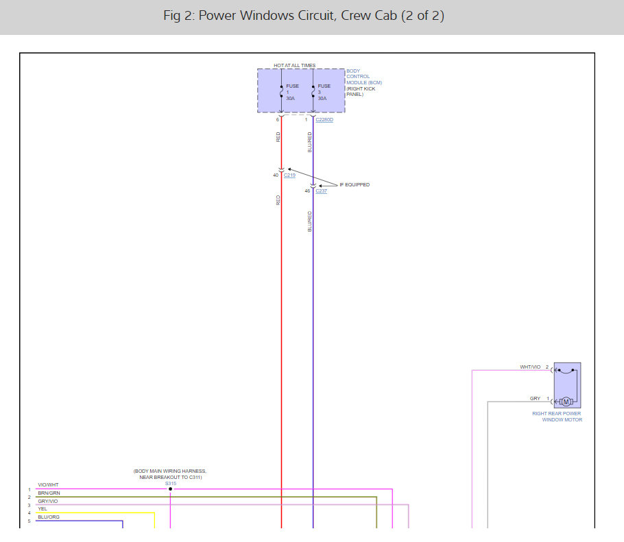

The window controls for the driver's side and the two rear doors do not work?
2013 FORD F-150
140,000 MILES • 6.2L • V8 • 2WD • AUTOMATIC
JAJ9874

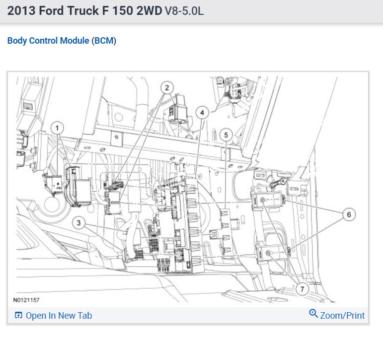

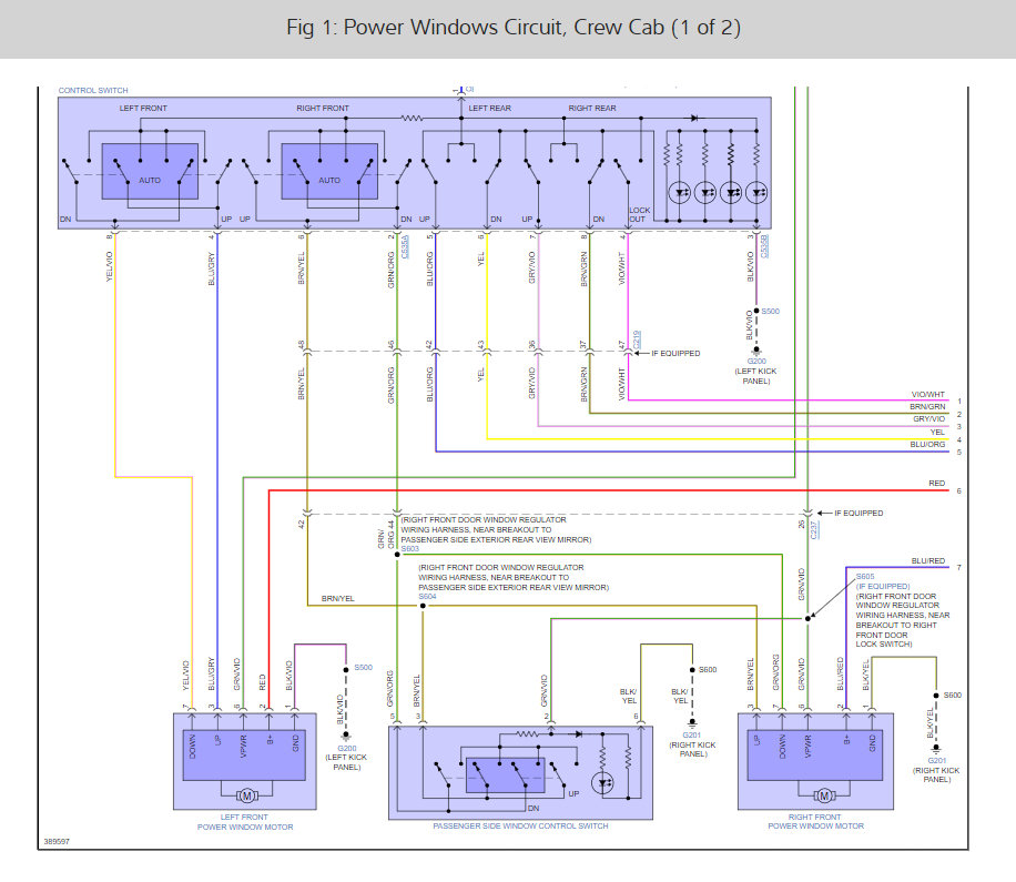

The only one that works in the truck is the passenger side front. I've replaced the two fuses and even replaced the relay for the windows, but it still has the same problem. Looking for troubleshooting help. Thanks
Aug 18, 2022 at 4:16 AM
  • 55,402 POSTS

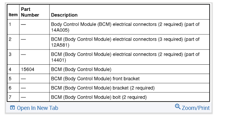

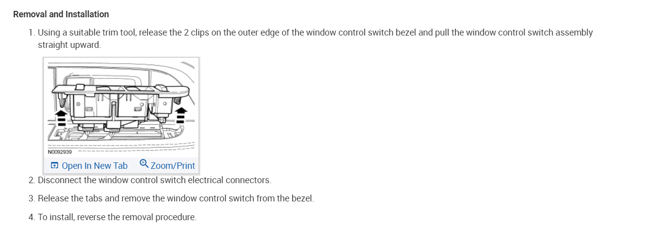

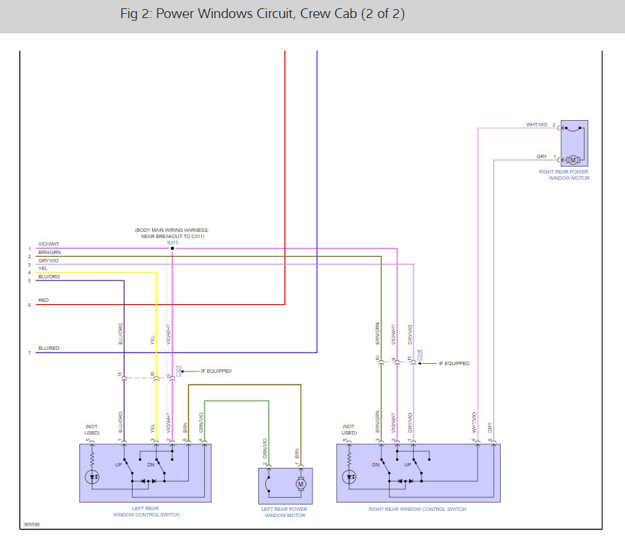

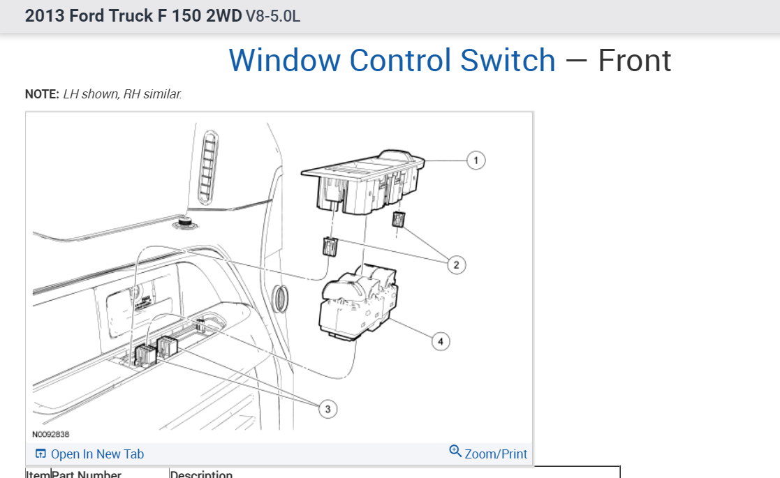

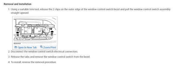

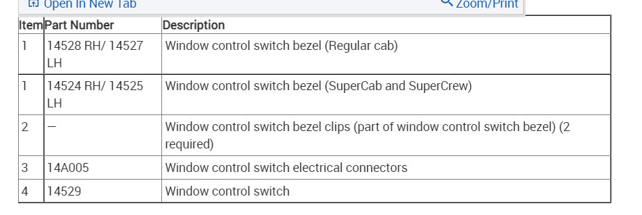

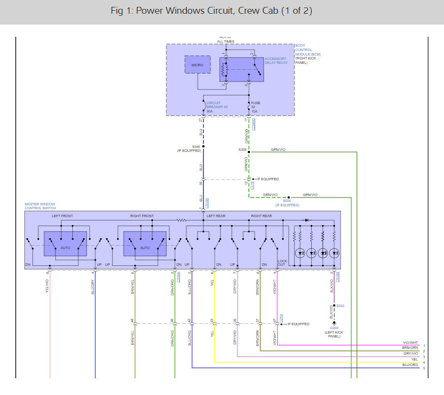

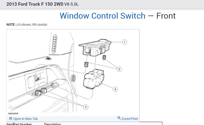

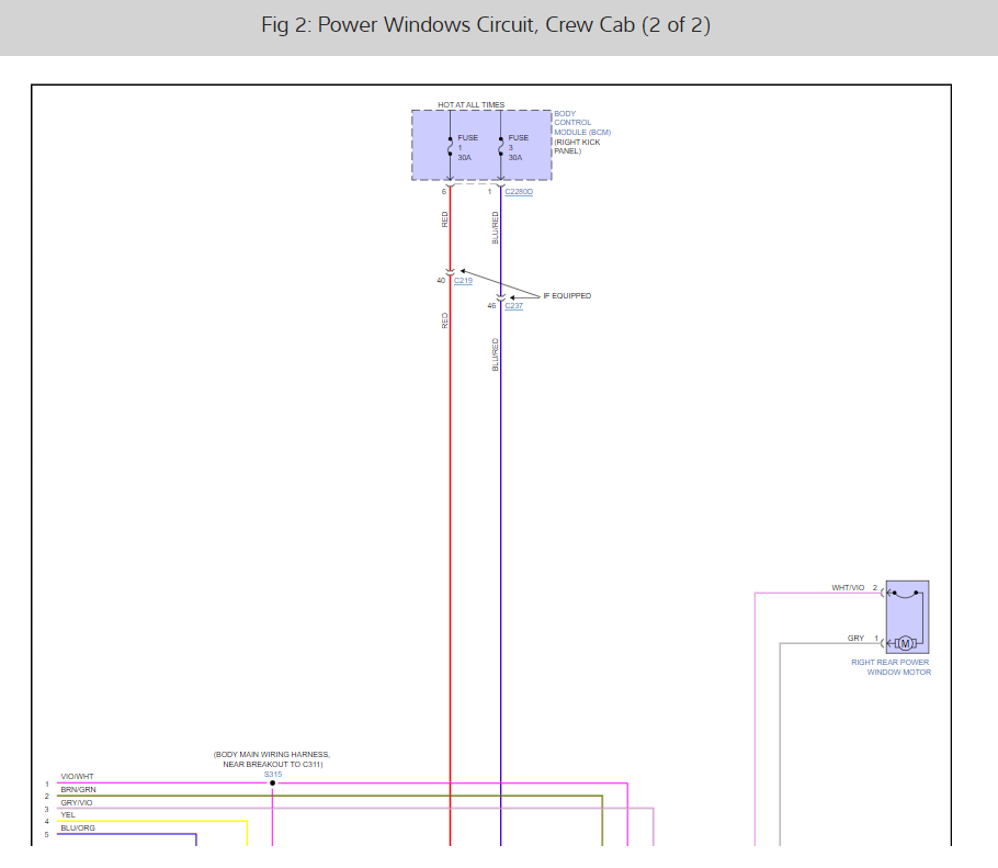

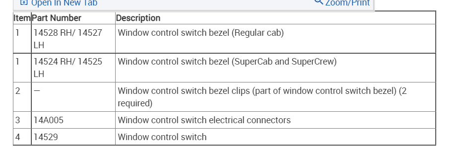

There are three fuses #f32, #f1 and #f3 and one circuit breaker#f48 that run the system on the BCM, lets check these first for power. here is a guide that can help, if the fuses are all good, I would say the master switch has gone bad, but you can check the power output from the switch as well with these wiring diagrams in the images below.
