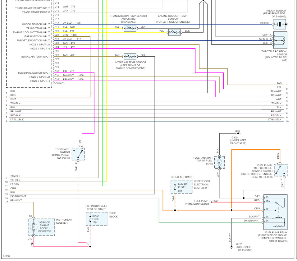

Fuel does not reach fuel filter nor do I hear fuel pump priming. Tested voltage at fuel pump connector has 8.5 volts with ignition on.
With ignition on tested voltage at fuel pump relay. Using pin 85 as ground, I got 10.94v on pin 86, 7.52 volts on pin 87a and 0 volts on pin 30.
With ignition on 20amp fuse #3 (Powertrain Control Module (PCM), Fuel Pump/Oil Pressure Switch, Fuel Pump Relay, Fan Control #1 Relay) I get 10.94 volts.
I don't have wiring diagram for ECM so I don't know where to test voltage at this source.

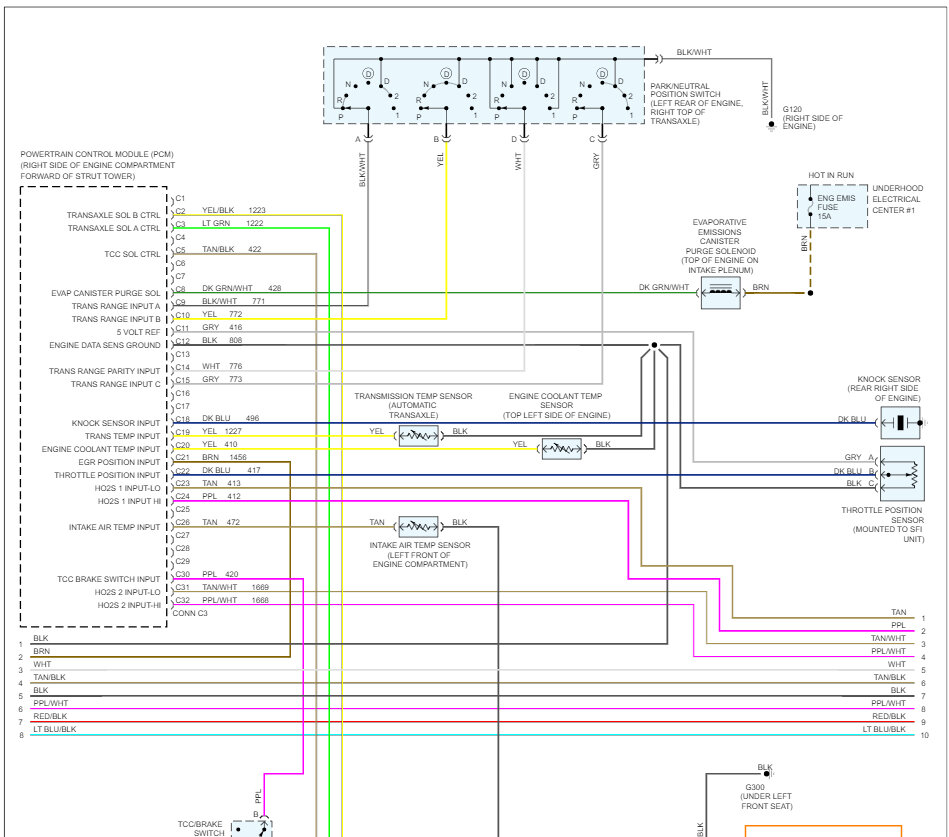

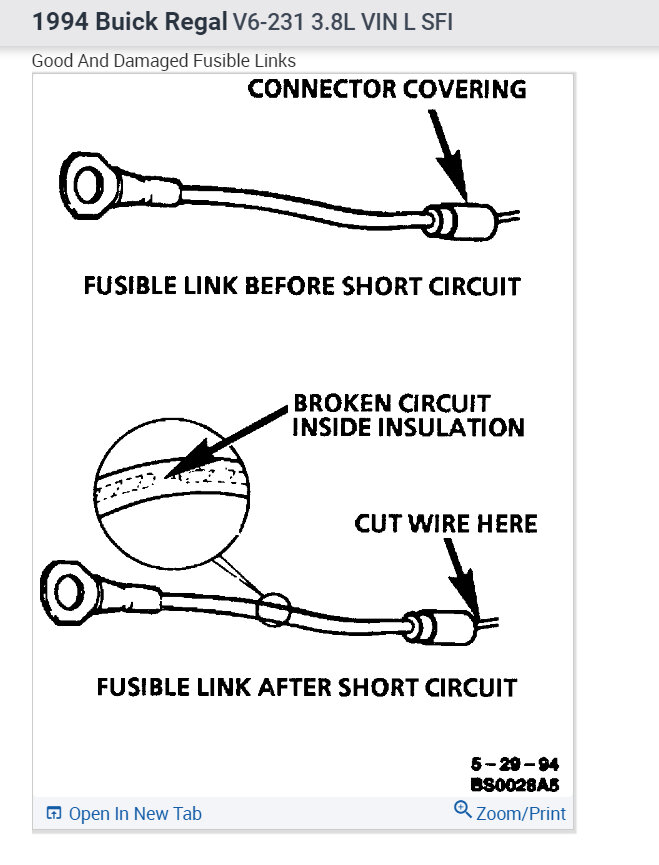

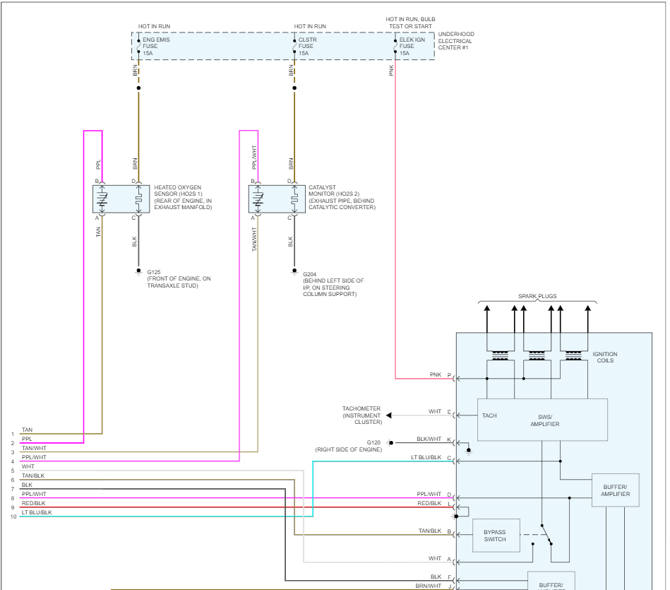

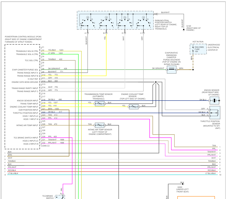

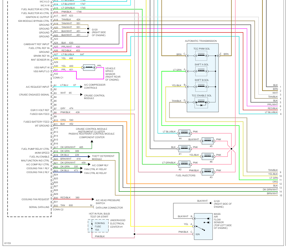

Do you have a security light flashing when you crank the engine over? If not, the system is not enabled. Also, the fuel pump gets it power from the ECM BATT fuse in the under-hood fuse panel so I would test the voltage at the fuse.
this guide can help:
Here are the PCM/fuel pump/engine wiring diagrams so you can see how the system works. You may have a fusible link that has gone bad and not supplying 12 volts to the systems. Check out the images (below). Please let us know how it goes.

Issue resolved. It was the "new" fuel pump, defective.
Replaced and now the car starts right up.
