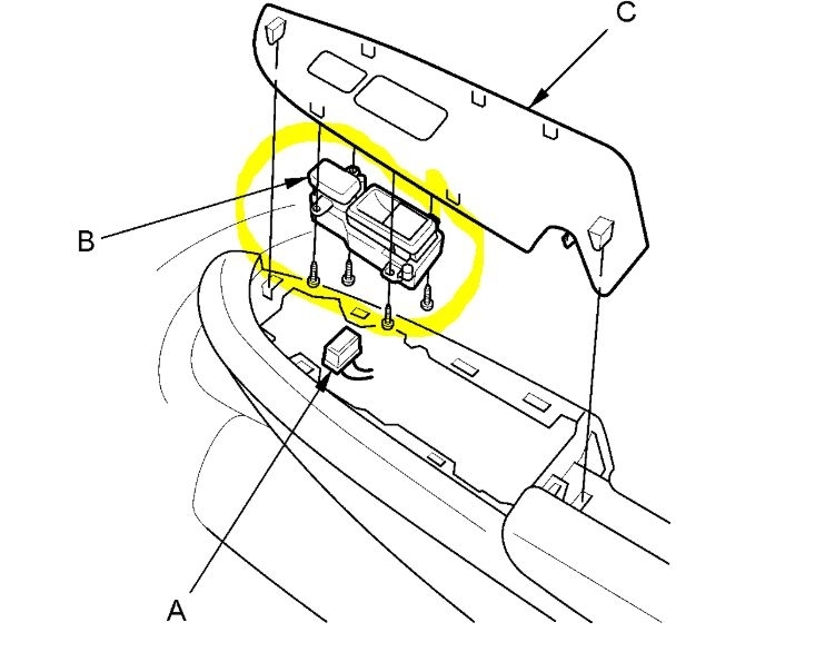

So a friend of mine locked her keys in her car a few times and one time her window was cracked enough to finagle the keys through the window after fishing for them off her seat with a coat hanger. now the last two times she had to pry her door open to get the unlock button. And now only driver window works but it you can hear some sort of a click to the other windows like there is power going to them but they don't move.

It sounds like there may be damage to the master switch for the windows on the driver's door.
Has anyone checked this switch?

Not to my knowledge. Also, some one suggested to leaving the battery disconnected overnight. And yes I told her that she needs a spare key, lol.
Feb 7, 2019 at 11:12 AM
No, leaving the battery overnight is not an answer.
Start by checking that switch and see if there is any damage.
