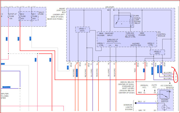

My drivers side brake light and the third brake light have stopped working, but the passenger side still works. All turn signals, running lights and other lights still work. I have checked fuses and replaced bulbs but still nothing.

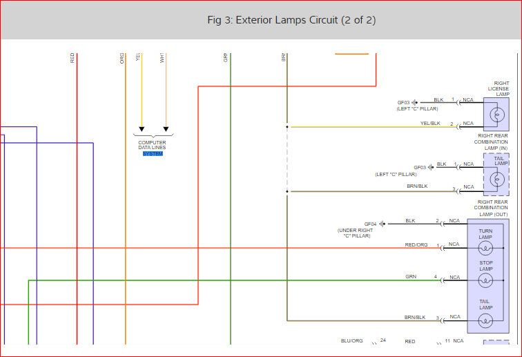

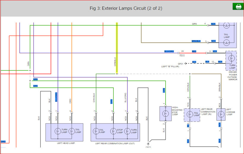

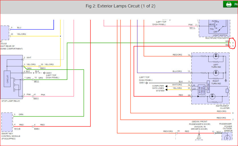

I have attached a wiring diagram for your left rear turn/tail/brake light circuit for you. I have also attached a tutorial showing how to test. Be sure to check all the ground wires. Hope this helps and feel free to ask any questions if needed. Thanks for using 2CarPros.
