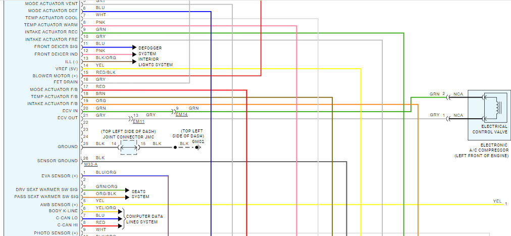

Hi, i would like to know how to know after i turn on the air compressor is working.
Jun 5, 2024 at 11:50 AM
  • 55,676 POSTS

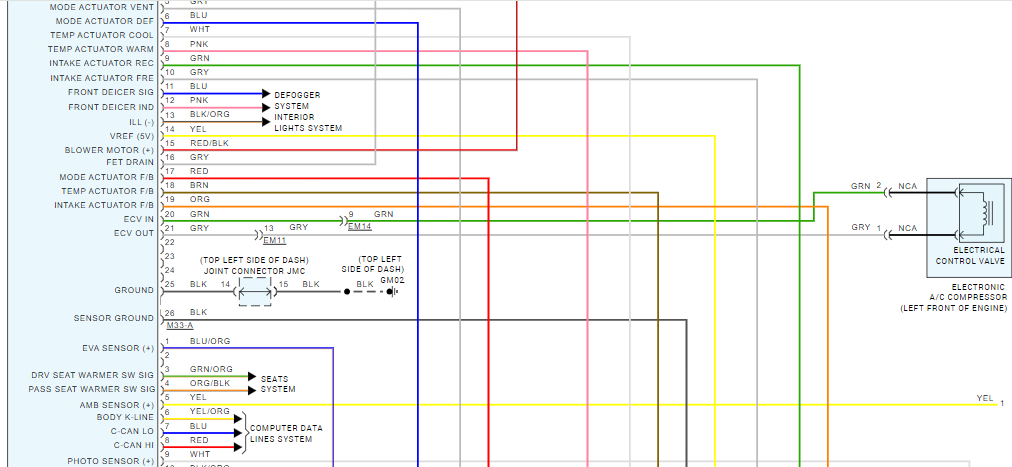

The best way to tell is to connect a set of A/C gauges because this kind of compressor does not have a clutch, instead it has an internal valve that is controlled by the AC control module. To see if the compressor is getting a signal you will need to remove the wiring from the compressor and connect a test light or voltmeter.
Here is a guide that can help and the wiring diagram for the compressor:
Check out the images (below). Let us know if you need anything else.
